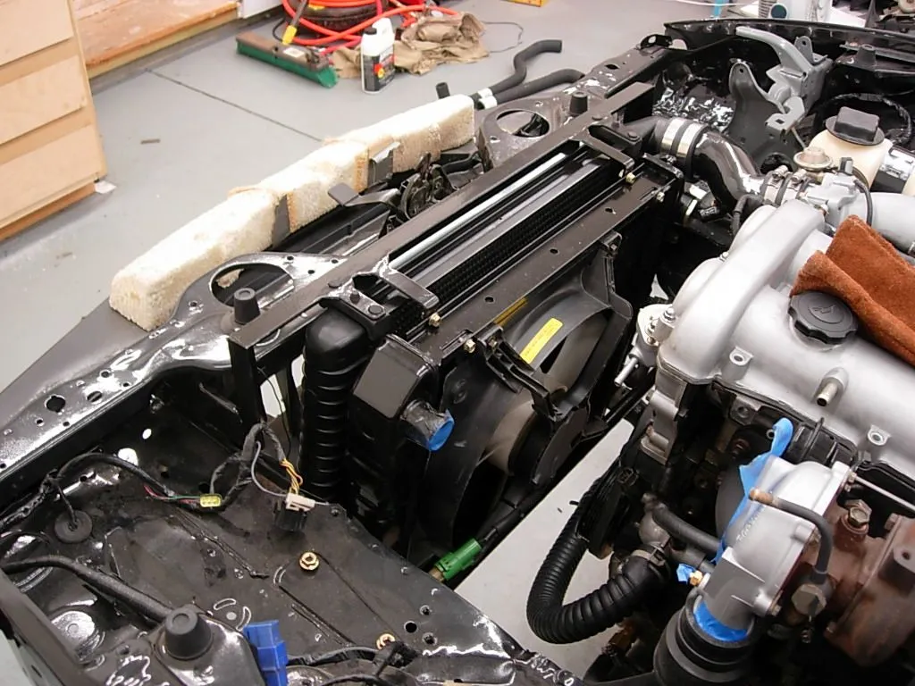

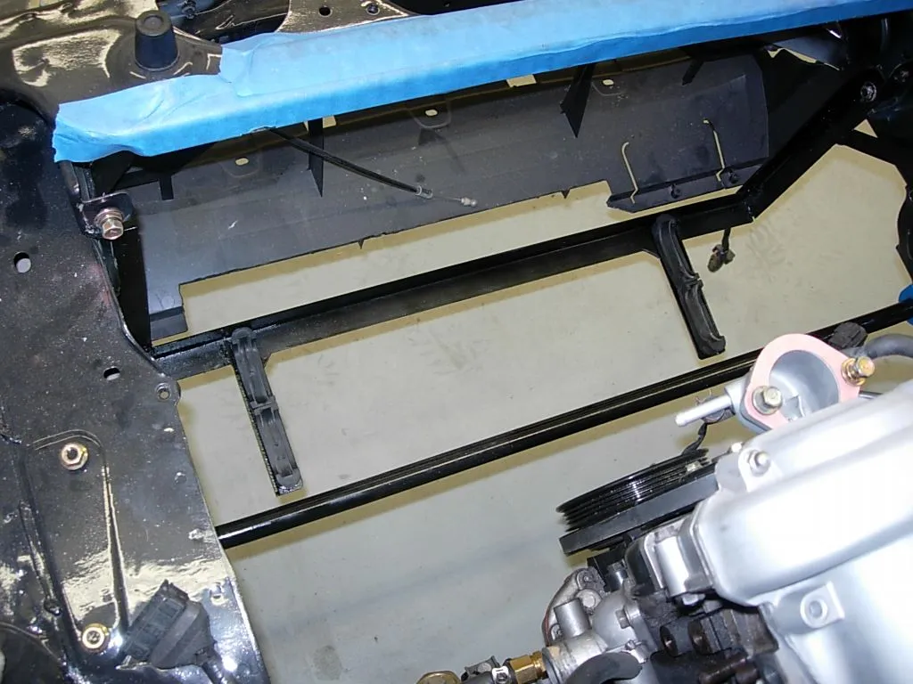

-the intercooler and radiator are permanantly mounted
-the intake manifold is connected to the intercooler
-the new coolant overflow reservoir is installed

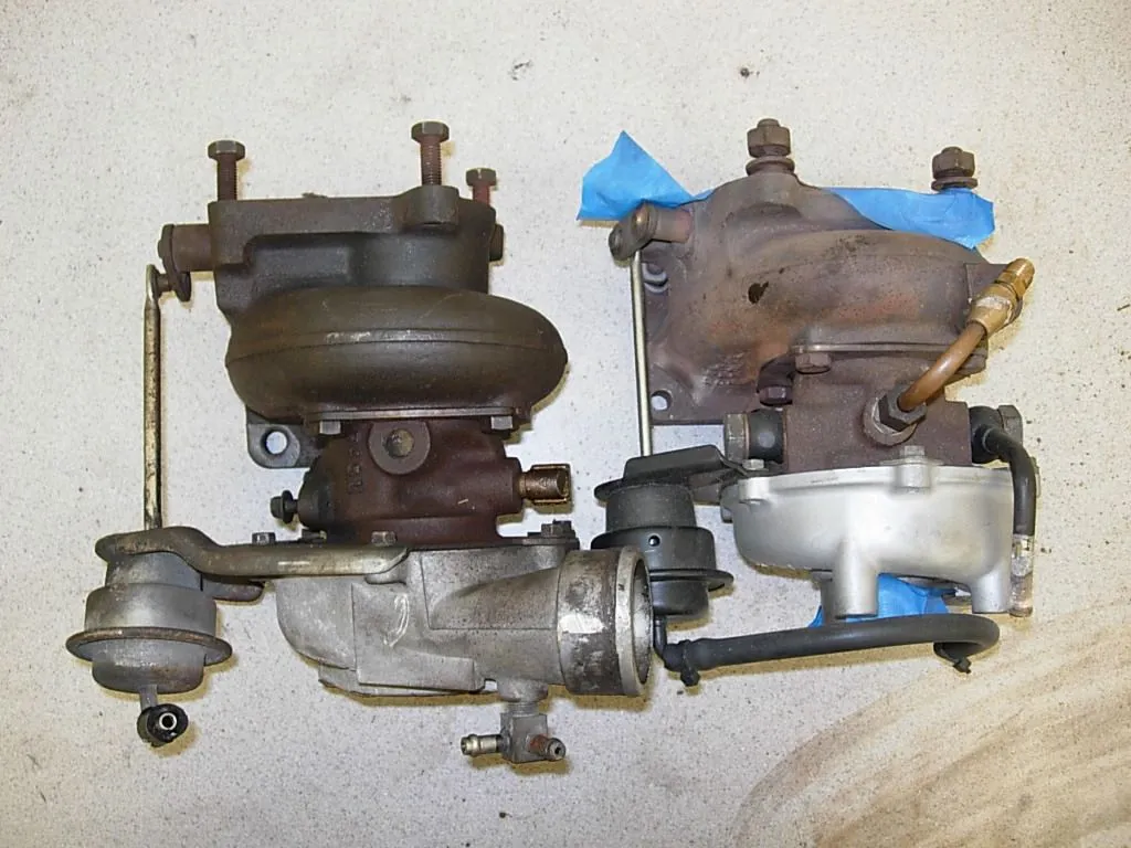

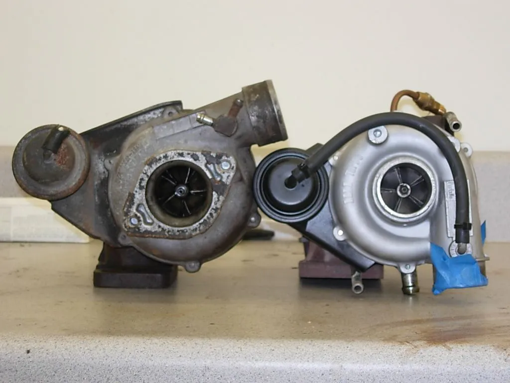

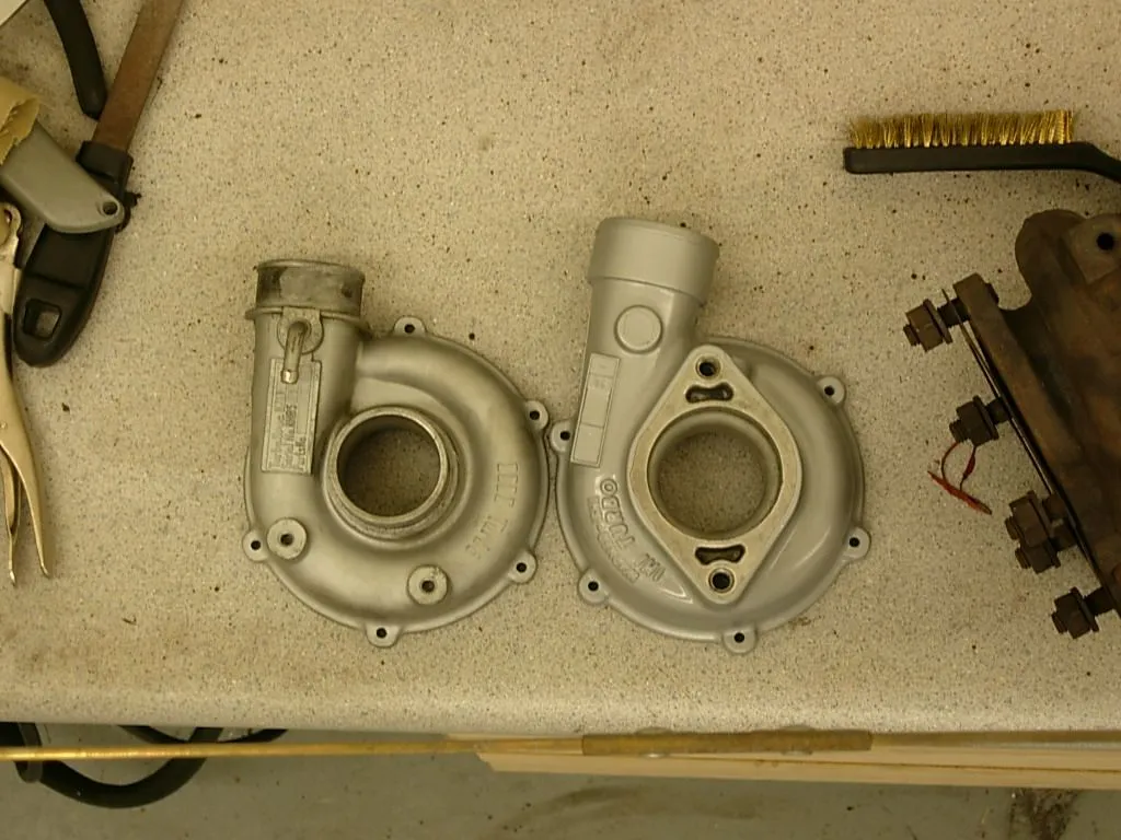

-the turbo is upgraded and installed (larger compressor wheel/housing)

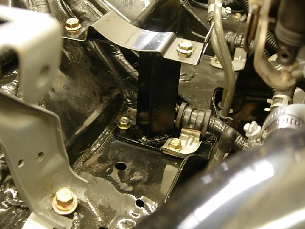

-the pre-I/C charge pipe is mostly complete

The next step is to complete the intake charge piping, install the radaitor fans and associated bracketry, and plumb the cooling system. I already have the majority of the materials required, so that shouldn't take too long. After that, it's just a matter of changing the oil, installing the plugs, and installing the down pipe.

Various points in the turbocharger handling....

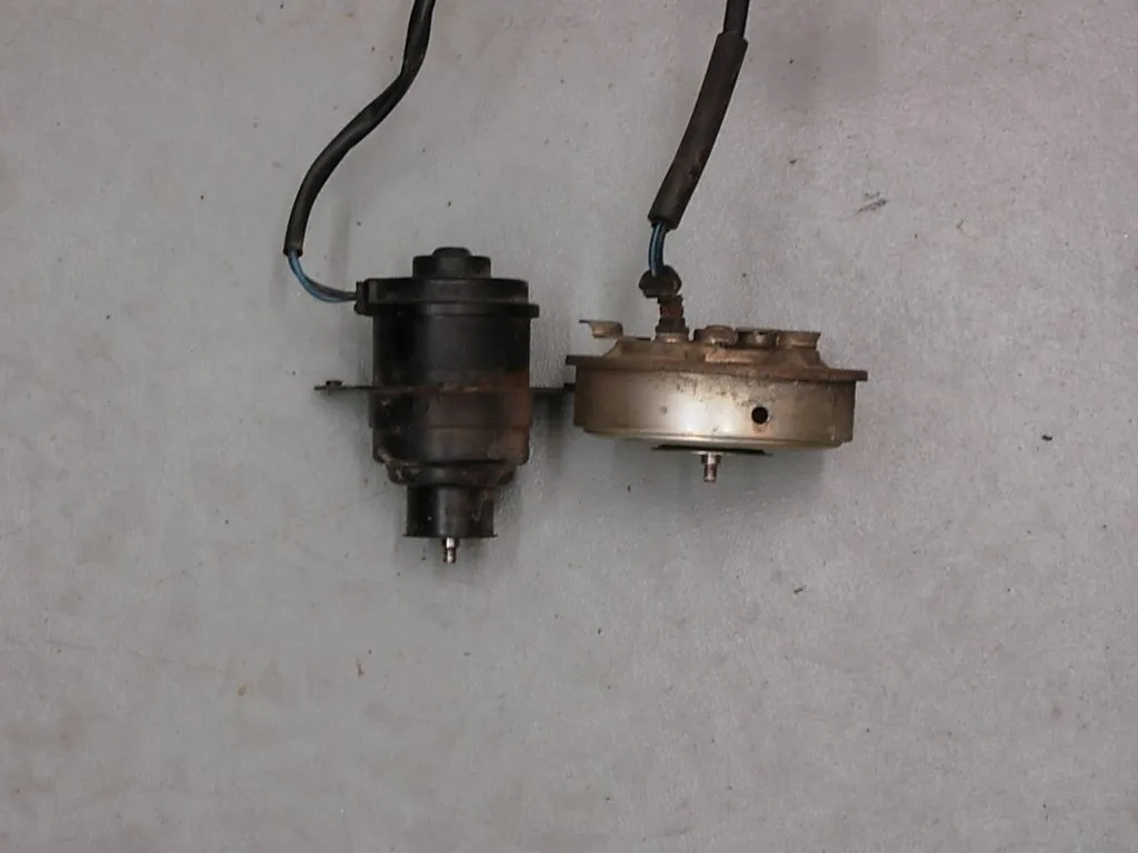

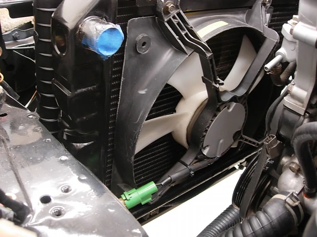

The first set of pictures briefly depicts the homologation of the stock fan and one of the Honda fans that I previously used. Since the new I/C and radiator setup protruded so much further into the engine bay than the previous as well as stock setup, I needed a lower profile fan. Therefore, I combined the two and it made it fit.

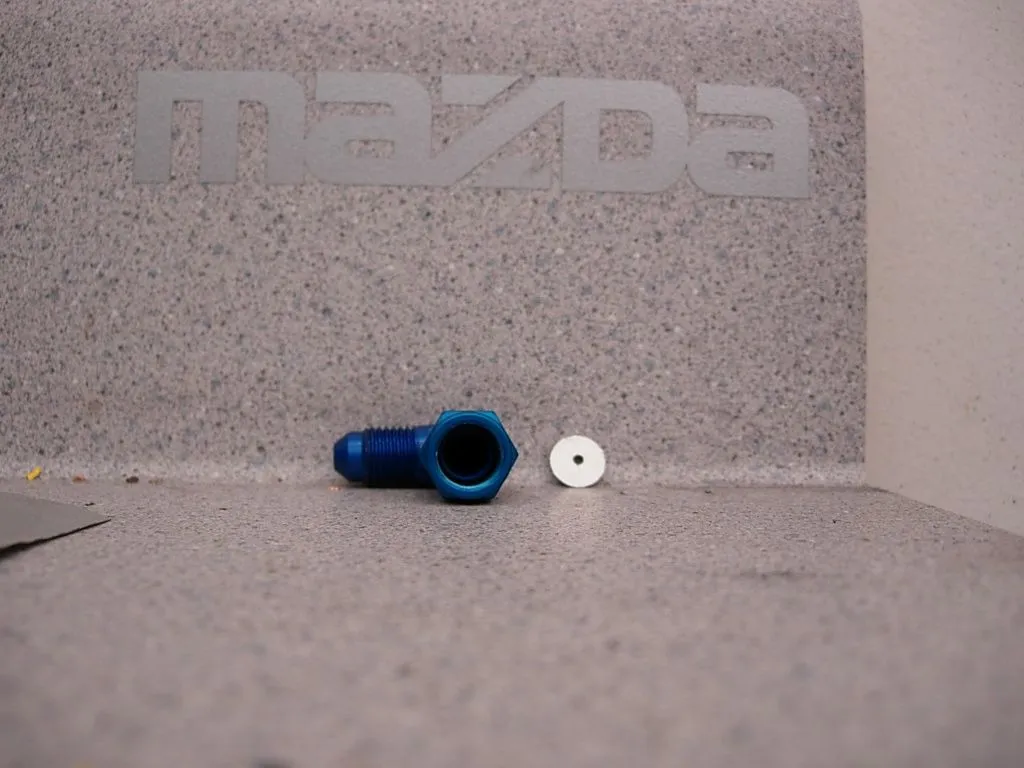

The first three pics in the second set briefly show the cheesy oil restrictor that I had to make. Since I am no longer using the original fitting with built in restrictor, I had to cobble one out of a piece of sheet aluminum. Basically, I drilled a hole of nearly the exact size and cut a disk out of the sheet. It was then crushed into AN flare fitting. I checked and rechecked and everything lines up and should work the way it is supposed to.

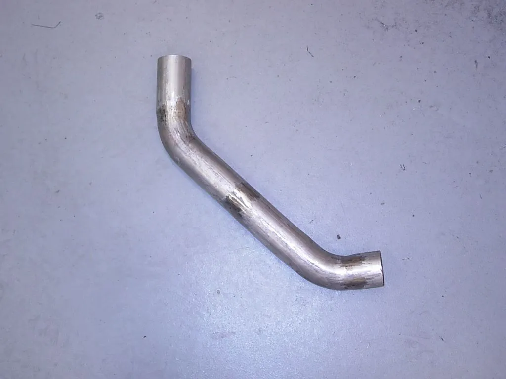

The first of the last set shows the rough beginning of the TC to I/C charge pipe. It has since been painted and fitted onto the car. The last few are of how the car currently stands. A bit more refinement is still needed with the vacuum portion of the intake, but that'll take no time. Furthermore, I will be bending a heat sheild for the turbo tomorrow. Hopefully things in the area of the master cylinder area will stay a bit cooler.
