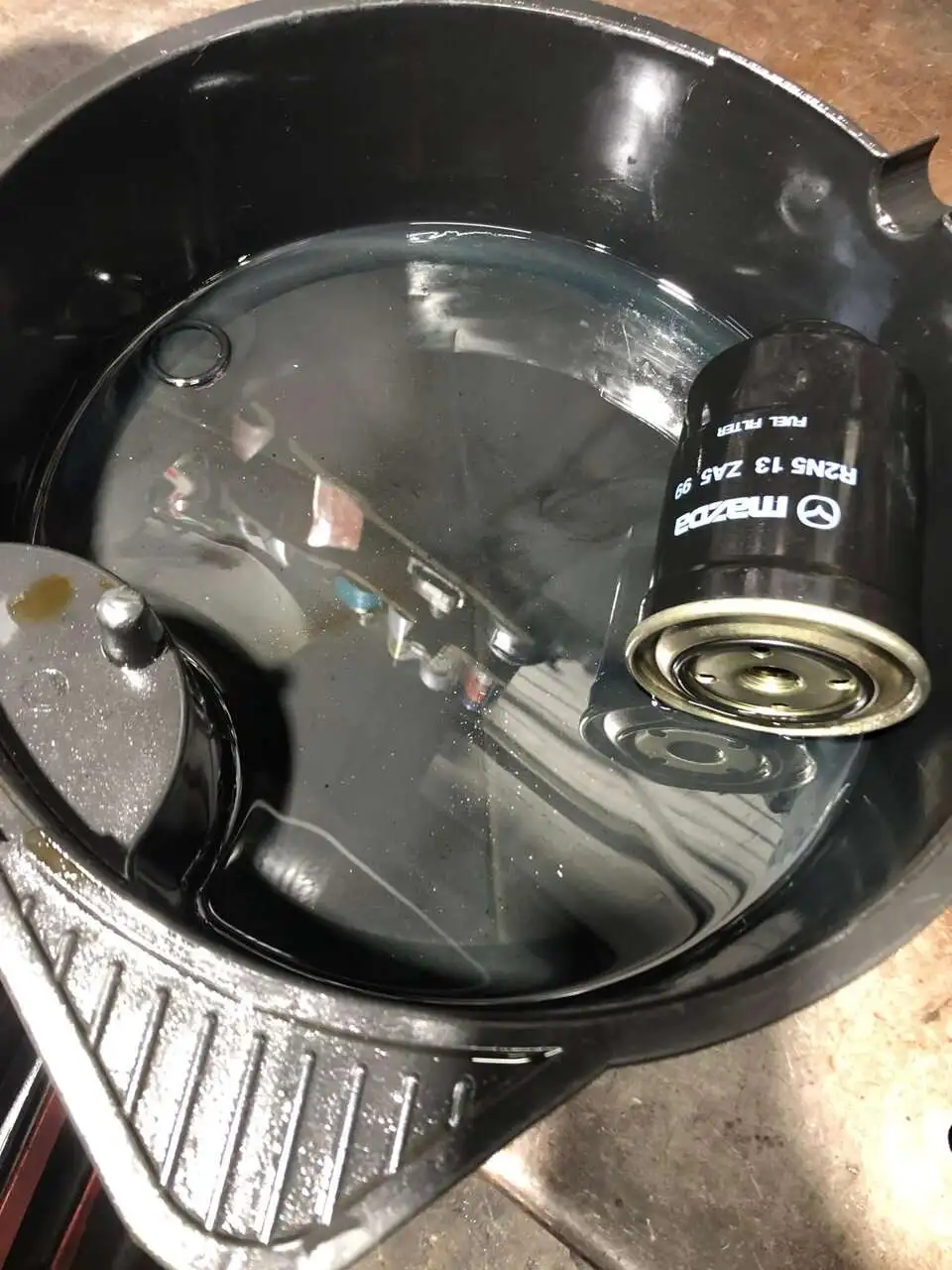

My local mechanic has performed a smoke machine test (EVAP?) and determined there was nil leaks, however he has replaced the fuel filter which
had metal specs/shavings and a blue colour in the drain pan (see photo)?
I received a call from the mechanic and advised the problem was fixed, however upon start up there was a rough idle issue again.
The mechanic advised there was no problem when the car was idling for 40 minutes in the workshop .
I was told to drive the car on the motorway for 20 minutes at 100-110km/h to flush out the system, which I did.
There were nil issues when driving, however the rough idle was present immediately after the drive whilst in park.
I was advised the next step would be to attend the workshop next week to check the fuel pump or the injectors.
