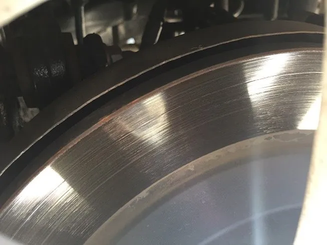

I checked my rotors today after a couple of threads popped up about rotor problems. Here is what I found:
There's 3 groves developing on my left rear rotor, outside face. One of them is deeper than the others and leaves what appear to be chatter marks. I only have 18K on a 2015 CX5 sport...
I have no braking issues except the occasional squeal every now and then.
Looks fine to me. Rotors are soft cast iron. Anything that embeds in the pad or gets between the pad and rotor is going to do that. Even if nothing does, they tend to groove over time. It's no stress.
