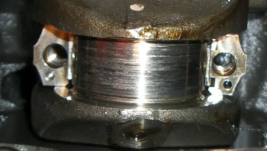

Ok, found which rod bearing was bad... also found a couple pebbles of metal in the oil hole. I don't know if this was the cause or effect.
Do I need to machine the crank if there are no actual scrapes or gouges but it has a streaky pattern on the surface? I'll upload a picture as soon as I can find my digital camera cord.
If you do machine the crank, do you have to put in a special bearing that's thicker?
The gap on the other three rods was 0.002" (or less). It was over 0.006" on the one that was screwed up.

Here are the pictures:
One shows the crank, the other shows the bearing with bent slip and two small metal pebbles taken from the oil hole that may have caused the problem in the first place.
