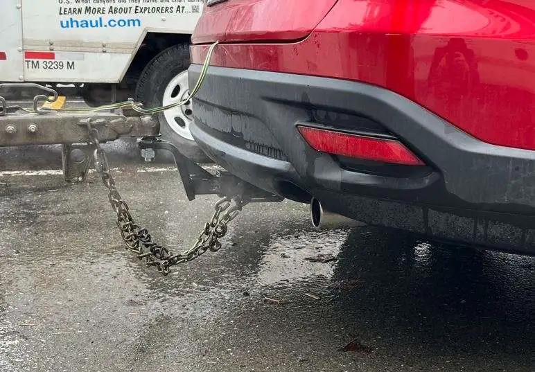

Hi, I'm planning on towing a U-haul 4x8 or 5x8 trailer.
What I've researched so far is CX9 hitches are about 13 inches off the ground (I ordered the Curt one), then the U-haul trailers are about 18 inches.
So I will need a 5-inch ball riser, right?
How critical is it to reach the trailer height? Say, if I can only find a 4-inch riser.
Also anyone who's done this, please do share your experiences.
I see @Pele2048 has done it with much bigger trailers.
Thanks!

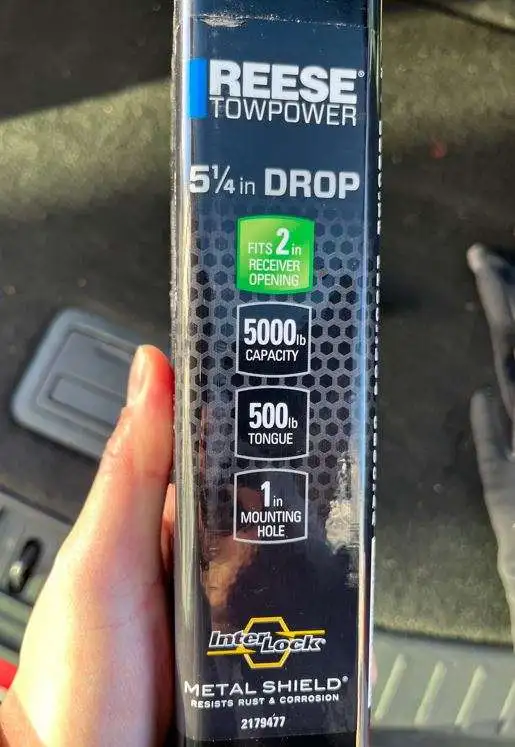

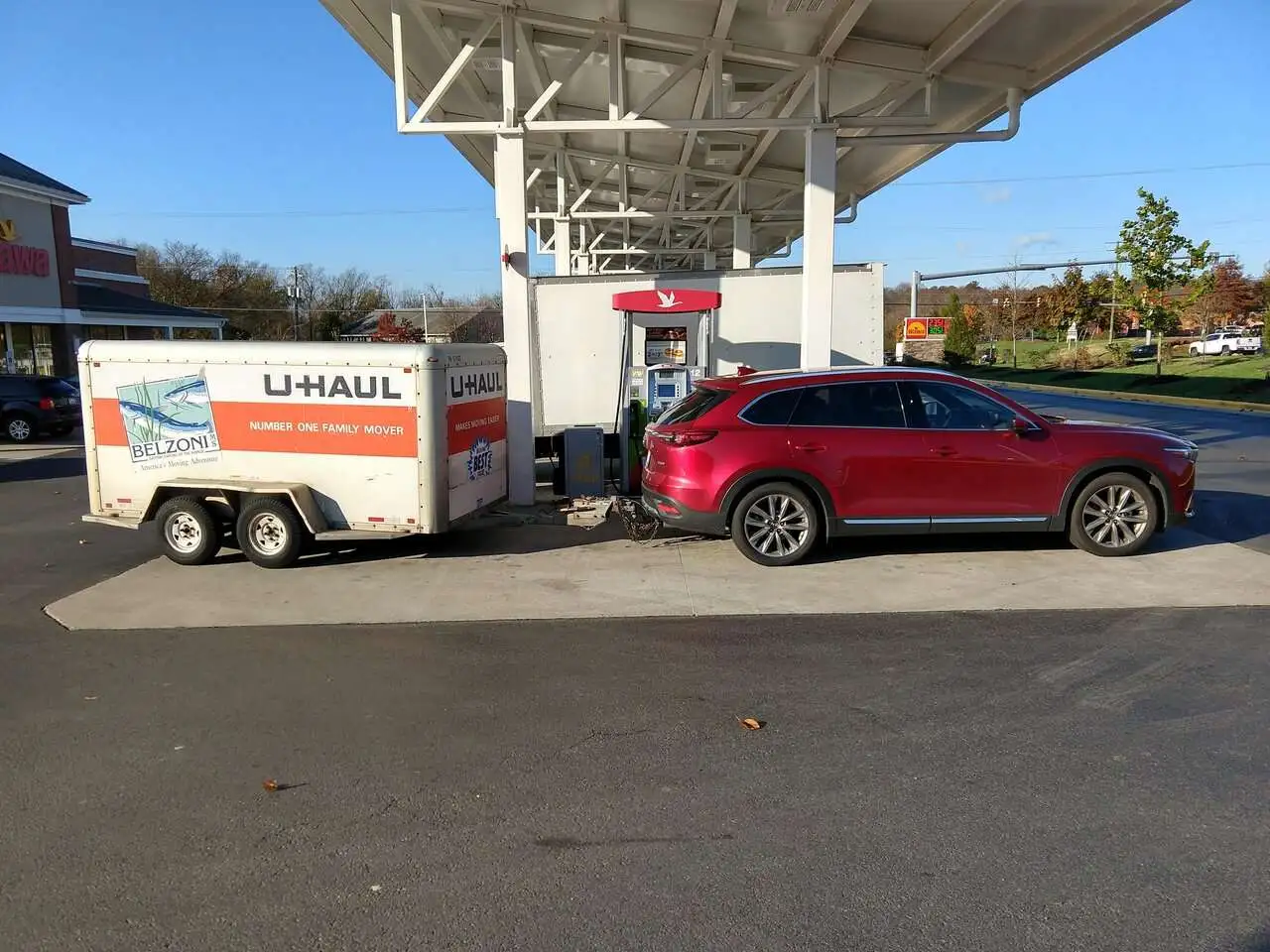

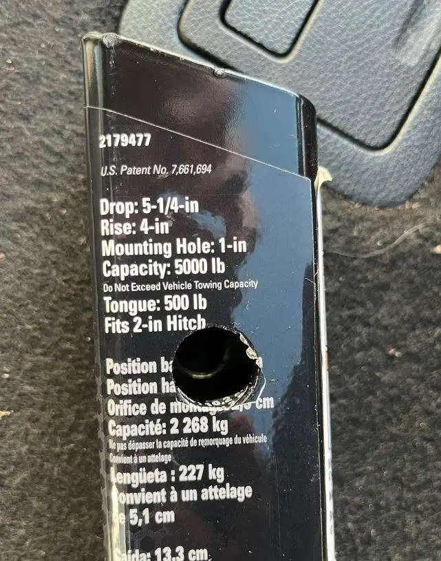

I DID IT! 😭 But I certainly hate backing up....
Ended up using a Reese 4-inch riser on the U-Haul 5x8ft trailer
Fully loaded trailer and CX-9, it handled really well through the mountains. Gassed up on premium of course.
I stayed around the prescribed 55mph (80-90 km/h) but could easily do faster. Brakes are another factor; felt adequate but I was conscious of not stressing mine.
