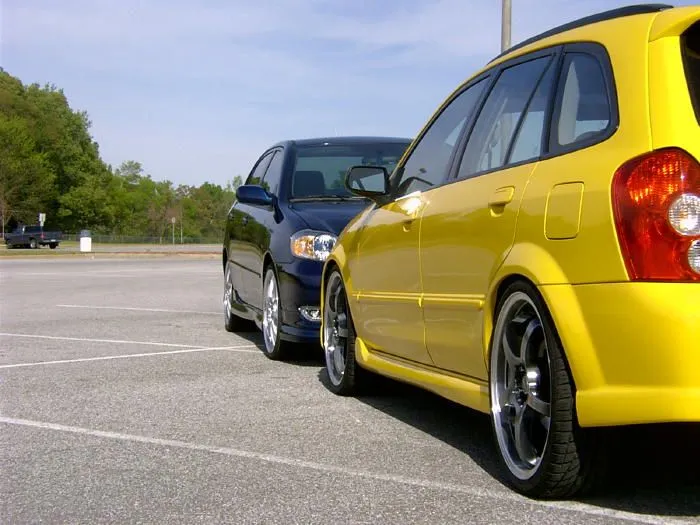

I am running 215/35/19s but if i was running 17s I would use a 205/40. I just prefer a smaller sidewall on my wheels. One way to check offset is to look on the inside of the wheel. Somewhere on one of the spokes it might have an ET #. It should say ET48 Other than that I think you just have too big of tires. As far as a stiffer spring, mazdaspeed springs are pretty stiff and only have a slight drop. Can you get a side pic, like standing beside the fender looking down the car?? At least that would give an idea of how they are sitting.

thanks for your help, I will try to locate a camera and get a pic
