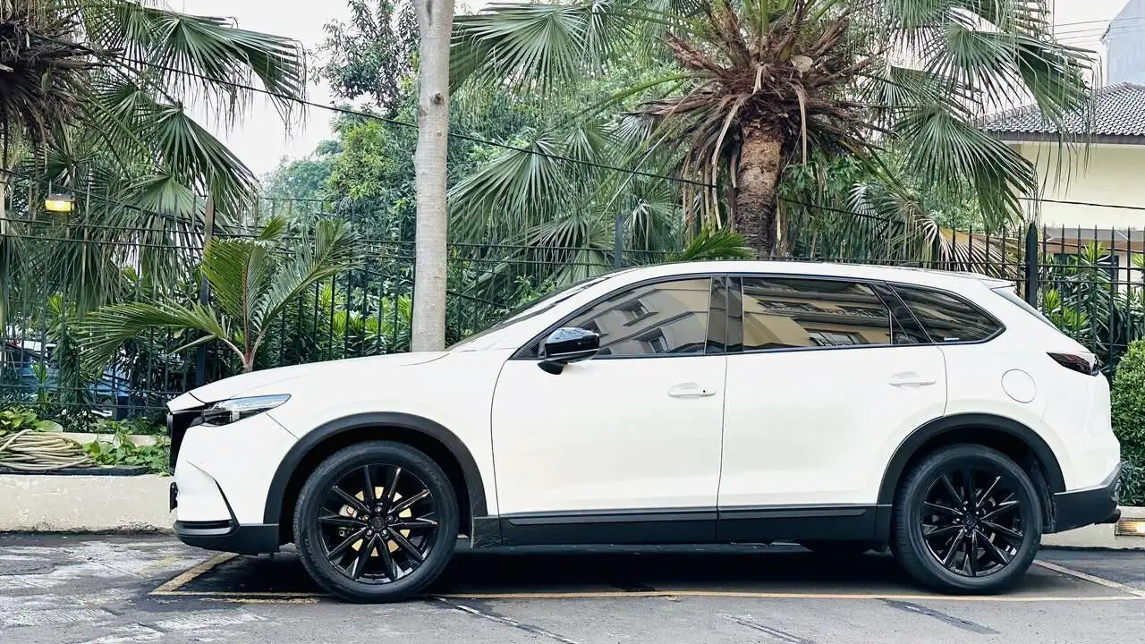

I recently bought my first mazda, a 2021 CX9 kuro edition (carbon in US I suppose), so far very happy with the experience.
I'm thinking to replace the original wheels with something more "attractive", but most likely will stay with 20" wheels.

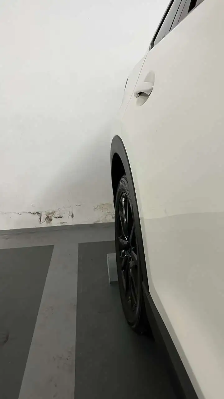

2. I think the current wheel setup is to inside the fender. I have 2 options at the moment

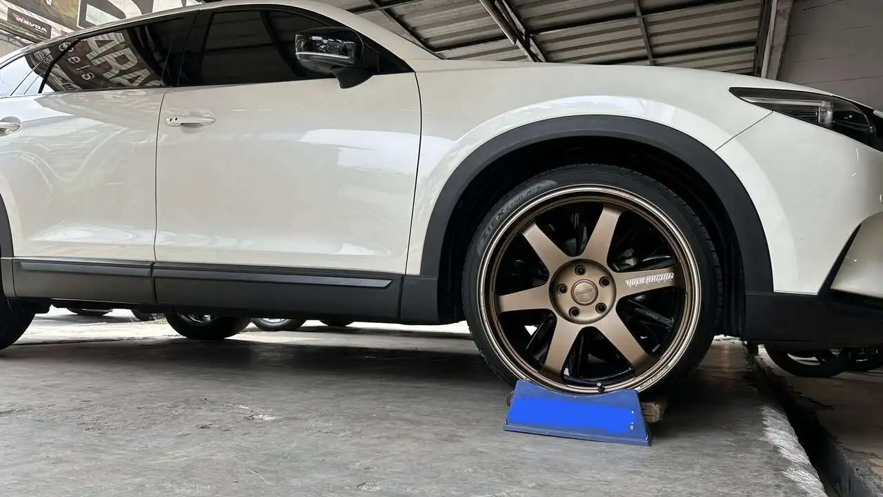

B. TE37 ultra 20", 8.5" flat ET36

Will option B improve the looks department a lot? Considering the spec is very similar with original wheels, and it's much more expensive than option A.

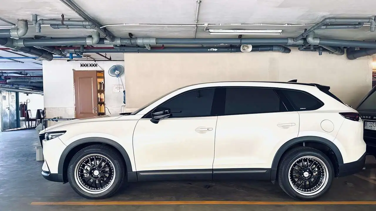

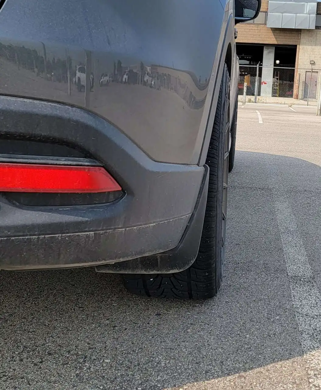

I'm currently running a 22x10.5" wide wheel with a +25 offset on 285/35/22 tires. Here's a picture that shows fitment of the front and rear.

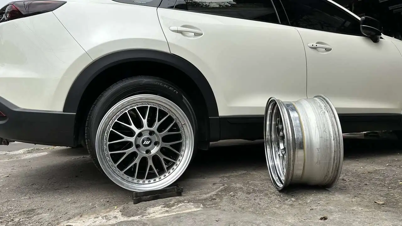

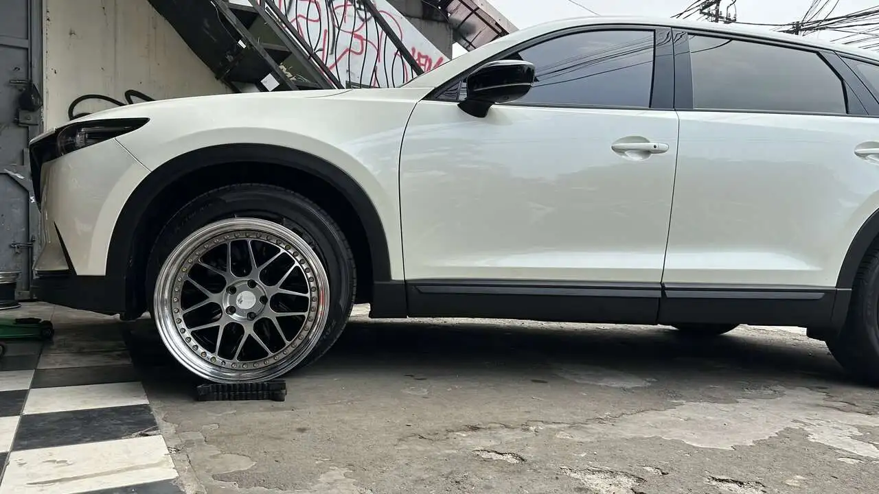

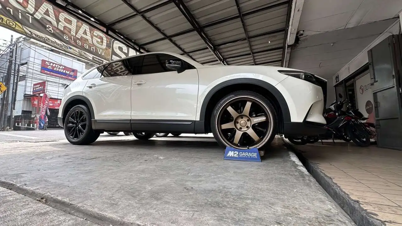

Got another offer on Rays G16 R20 8.5 ET38 front & 9.5 ET48 rear......I'm not sure whether this have enough offset to make it align with the outer fender though.....
