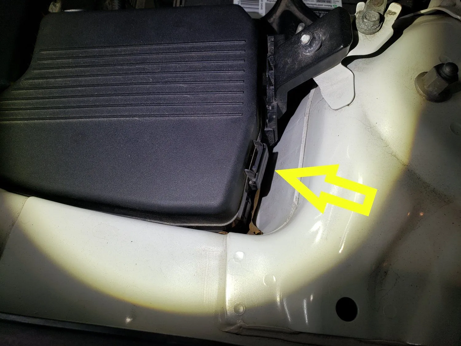

All you need to do to open the fuse box is press on the one clip that the yellow arrow is pointing to. I was standing by the drivers door when I took the pic, so left on the pic is to the front of the vehicle to help you get oriented. Just press the top part of the clip toward the fuse box to release the box top and then rotate it upward and to the front of the vehicle to remove it. Snaps back in place to close.
Hahaha....Thanx for your suggestion, but I want to separate the upper and lower box itself, not the top lid...;)

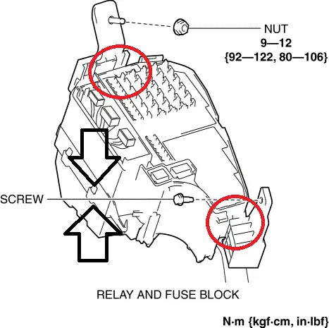

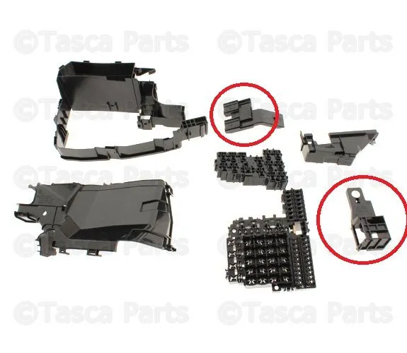

Complete display....The circled parts are those which are hard to dismantle..
The reason is I want to secure my car against theft by making a kill switch between the start/stop button and the starter relay...
Ooops, my bad, I misunderstood your problem. I really don't know how to do what you're asking but as a general matter it seems like connectors like those usually rely on a small screwdriver placed in the right spot to disengage them. Sorry I couldn't help.
