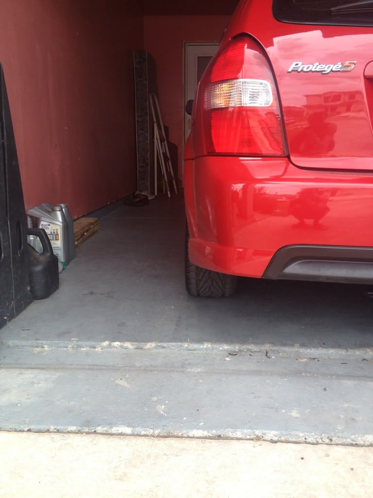

Ordered red sick speed horns
added spacers to the back
With No spacer
With Spacer
What y'all think ?
ill try to measure them today. they were my bros he had them sitting there doing nothing and I was bored so tried them on
Just checking since I have the same wheels. I'm curious what is needed up front to be flush. 8mm maybe
