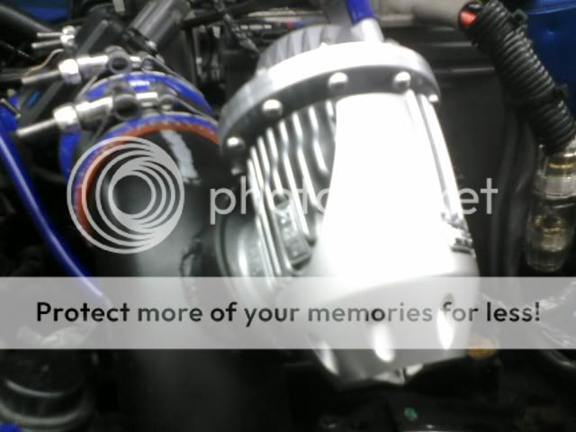

I hope it is that simple. Also, I'm starting to wonder if maybe I get a little turkey when running BOV only because the BOV needs cleaned or something? I think there was a how-to on here somewhere so I may fiddle with that.
I get turkey if I'm releasing low boost levels. its really not a concern... it looks like yours is a V1 valve? I used to have that and it fluttered a lot no matter how I adjusted it, so I moved to the newer non-adjustable version.
I know it is a really old valve, probably V1 cause I bought the FMIC kit from Kicker who ran it years back. Is it simple to swap in a new one since I already have the flange?
Installed the HKS V3 tonight, but I'm still getting turkey and I still can't find the boost leak...this is pissing me off.
the HKS only came in black for the V2 and V3, i believe. if theres a nut on the back, its a V1. you cant tell from the pics.

How about this one? Does the black edition suck hence the cheap price or just cheap cause...it's ebay?
that is definitely fake, but at least they tried pretty hard. dont buy one without pics of the box, just a word of advice.

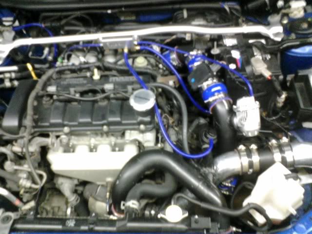

picture of current setup and my new BOV:
Bought some MAF cleaner at autozone and sprayed it down, but the idle is still lean. Oh and I threw a CEL when I changed back to the superstockmap...hooray.
well I'm not going to hack up my wiring, but I was thinking maybe loading a blank map with every cell containing 10? I would change the output settings and whatnot but on the fuel map just leave it untouched, anybody tried that before?
