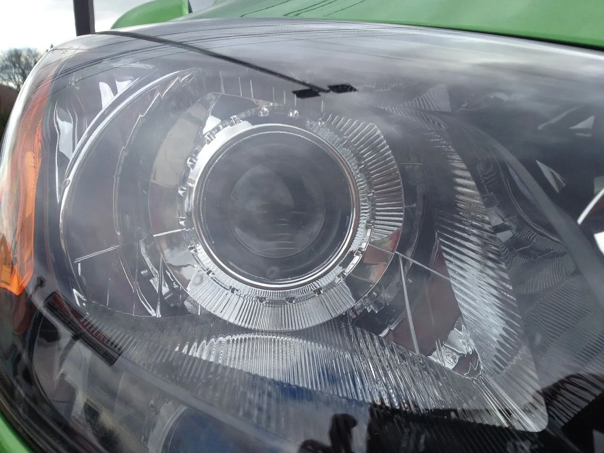

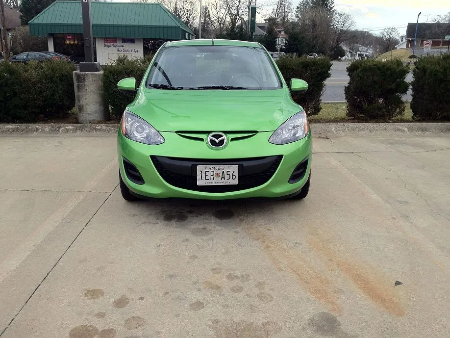

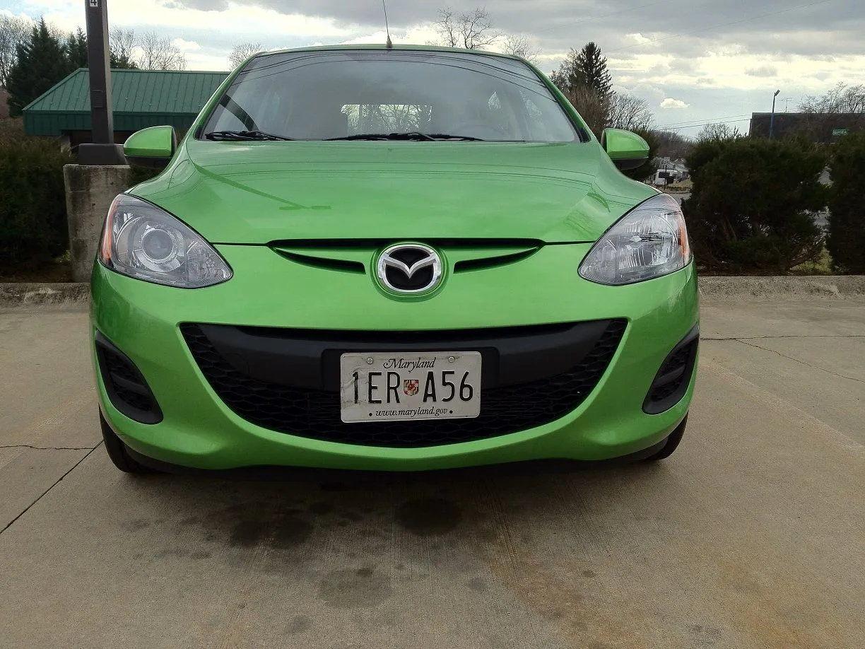

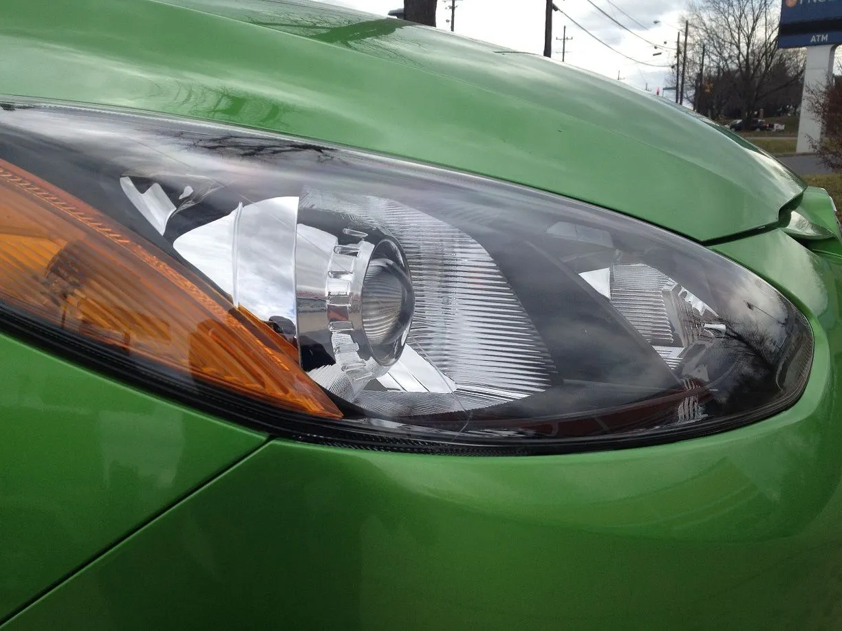

Well guys I finished the How To wirte up for retrofitting the Mazda 2. http://www.mazdas247.com/forum/showthread.php?123810299-How-to-Retrofit-your-Mazda-2
As far as I know, I'm the first person to retrofit the 2 here in the United States. Now it's time to find some OE style fog lights and an OEM switch

Looks great!! Can't wait to tackle this myself, thanks for taking the time to do the writeup!
Thanks guys. That's always what I try to accomplish with most of my mods. Make it look as OE as possible. I think these turned out great. Not as aggressive looking as the OEM Xenons but to me they look like they could pass as OEM.
Out of curiousity, when you opened up the headlight, did you see a possibility of removing the amber reflector on the side and getting that cleared out look? lol
You can definitely remove it. Although with it being the sidemarker housing and all it would probably look funny without it.

For the turn sig reflector I hit it with some lens tint, same stuff I used on my side turns on the fenders and the reflectors in the rear bumper. I also used it on the Panamera shrouds in the headlights. I was trying to get a black chrome look but it's not 100%. Hard to get that translucent paint even so they are a little darker than I really wanted. 2 coats.
As for the parking light, I just took out the orange cover and was left with the silver piece and a white reflector near the corner of the light. I bought 2 short amber LED strips and mounted it BEHIND the white reflector so it diffused the light some. I haven't had a chance to hook those or the CCFL rings up yet so that's why I haven't taken many pics. I also put a 4 LED bulb in the parking light spot for now, but I plan to get a 360* LED bulb to put in there.
Agreed on bulbs, I had 8k in a previous car and they were HORRIBLE in snow. I ended up getting some super yellow fogs and mounting them just so I could see!!! I opted for 5k on the 2. Pretty bright white light and the cutoff is a nice purple/blue.
I definitely would not recommend painting the turn signal reflector. Reduces visibility of the signal greatly. You might be able to see it okay at night but during the day in broad sunlight, it will be difficult to see. Weather has been crappy here so no output shots from me yet.
