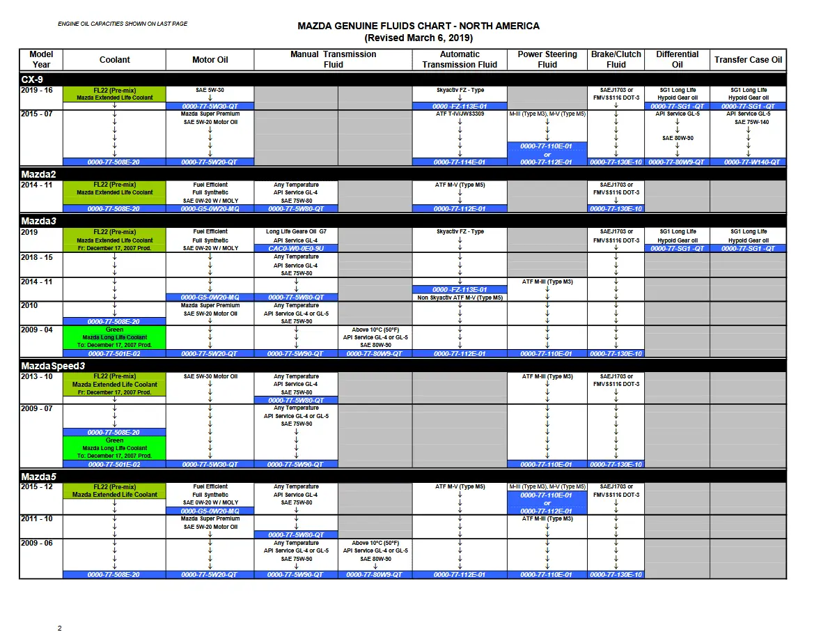

Not 100% sure about the Ford coolants, but I'm fairly certain that 0000-77-501E-02 is NOT FL-22, but the "1st gen" long life coolant that Mazda was using for a while. This chart seems to back that up: 49024155578_8f7b6623b7_o.webp
I believe that Pentofrost A2 is also equivalent to 0000-77-501E-02 (i.e. not FL-22), since it references the 501E part number, and their antifreeze guide states that A2 should be not used in Mazdas 2006 and newer : http://www.pentosin.net/literature/Pentosin Pentofrost Antifreeze Guide.pdf
Ravenol appears to be FL-22 as far as I can tell and, as I said, no idea which category the Motorcraft coolants fall under.
Reluctantly I agree that Mazda Long Life Coolant concentrate (501E) and the Pentosin A2 are first generation phosphate HOAT formulas that do not have the exact FL22 additive package. But, these first generation Japanese P-HOAT coolants contain all the same main ingredients and are silicate free formulas, completely compatible with FL22. Mazda will tell you to put FL22 in a car with Mazda Long Life. If you dilute these first gen Japanese P-HOAT coolants with distilled water I’m confident that you will NOT compromise the life of your Mazda engine, water pump and radiator-but you probably should drain at 60K versus 120K for the FL22.
