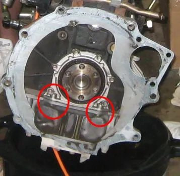

Im trying to remove the oil pan on my 03 MSP to get to the crankshaft and there is a piece connected to the transmission that sits between the oil pan and where the crank an other engine components sit...can anyone tell me how to remove (not the pan itself) the piece sitting in between the pan and engine internals. Also can I get to the crank whilst having the engine still in the chasis?

You gonna have to drop the transmission as the rear main seal housing attaches to it with 2 - 10mm bolts.
Yup, believe me I tried everything else when I rebuilt my engine. You have to remove the transmission or the engine to get to those two bolts.
actually you do not need to drop the tranny to get that base plate off...if you rotate the flywheel it has two notches in it where you can get a ratchet and 10mm socket on a long extension through to get those two bolts off...the rest are easily accessible once you get the oil pan off...trust me, I've done it that way a million times now...you can put them back on the same way, but it'll take a steady hand and a little patience lol
you can completely remove it without getting the tranny off...however if you want to get the crankshaft out you WILL need to take the tranny off

GL I did that one last summer thought the rings spun on me. Ended up cracking the ring landings. But as far as i know you gotta pull the trans to get the bolts off. Then you can pull the motor pull the head off and drop them out the bottom.
again, you don't have to pull the tranny to get that base plate off...you can (if you would like) pull the pistons out without the removing the transmission through the top of the block, yes...but be sure to keep a clean working environment and be sure to thoroughly clean the block out before you reseal it up...and once you have done so, idle the engine with fresh clean oil for a good hour and then reflush the block through with a new change of oil to ensure you get as much dirt particles out of it

you can also just drill holes in the trans casing to remove those bolts...
um...no, sorry damien...it's designed for you to do that without that
there are even rubber boots over the holes where you can access those at

well.. that's just what i've heard.. miguel did it.. never seen any rubber boots myself.. then again, i've never tried taking the block out and leaving the trans in.. i like to take them both out at the same time.
What rubber boots? Where are you seeing rubber boots on the main cap support plate or the transmission housing?? I'm looking at pictures of some old motors and don't see a damn place where rubber boots are.
