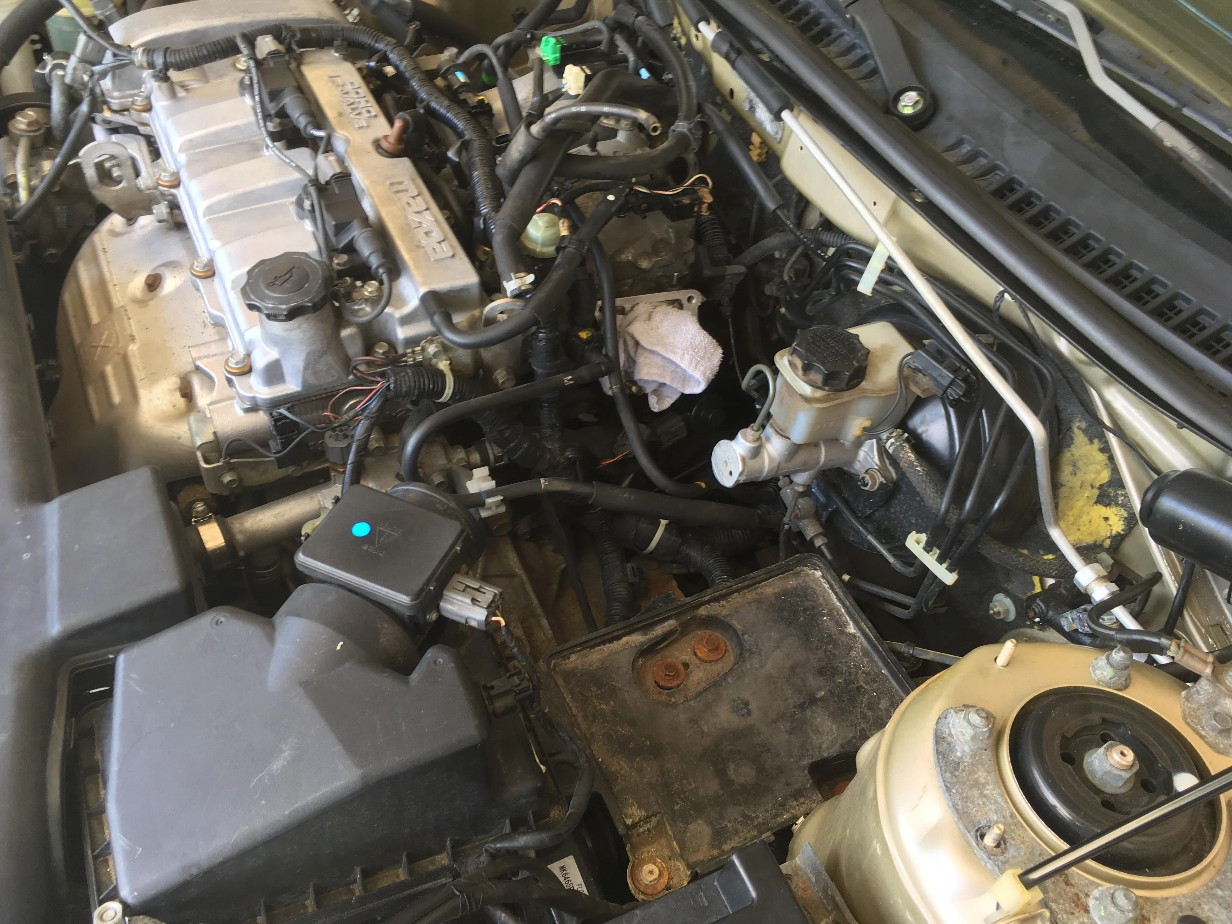

I was removing my rear transmission mount (driver side rear mount under intake manifold) - attempting to do it with the intake manifold still on the engine - I took out my battery, tube from throttle body to MAF, and the throttle body, and it gave me some nice working room to remove the two 10mm nuts that hold the plastic wire bracket, and break the three nuts lose that connect the mount to the frame. I used about 18" of 3/8 extensions and a breaker bar with universal joints on 3 nuts to the frame. I had the engine jacked with a 2x4 wood cushion as well. I have replaced all 3 other motor mounts on this car as well.

Here is how I got to the motor mount and wiring harness bracket by removing the battery, intake tube, and taking TB off. My TB gasket was fossilized and just fell apart and it was very hard to find one at a local parts store. I had to drive 25 miles for one so I bought two gaskets just in case.

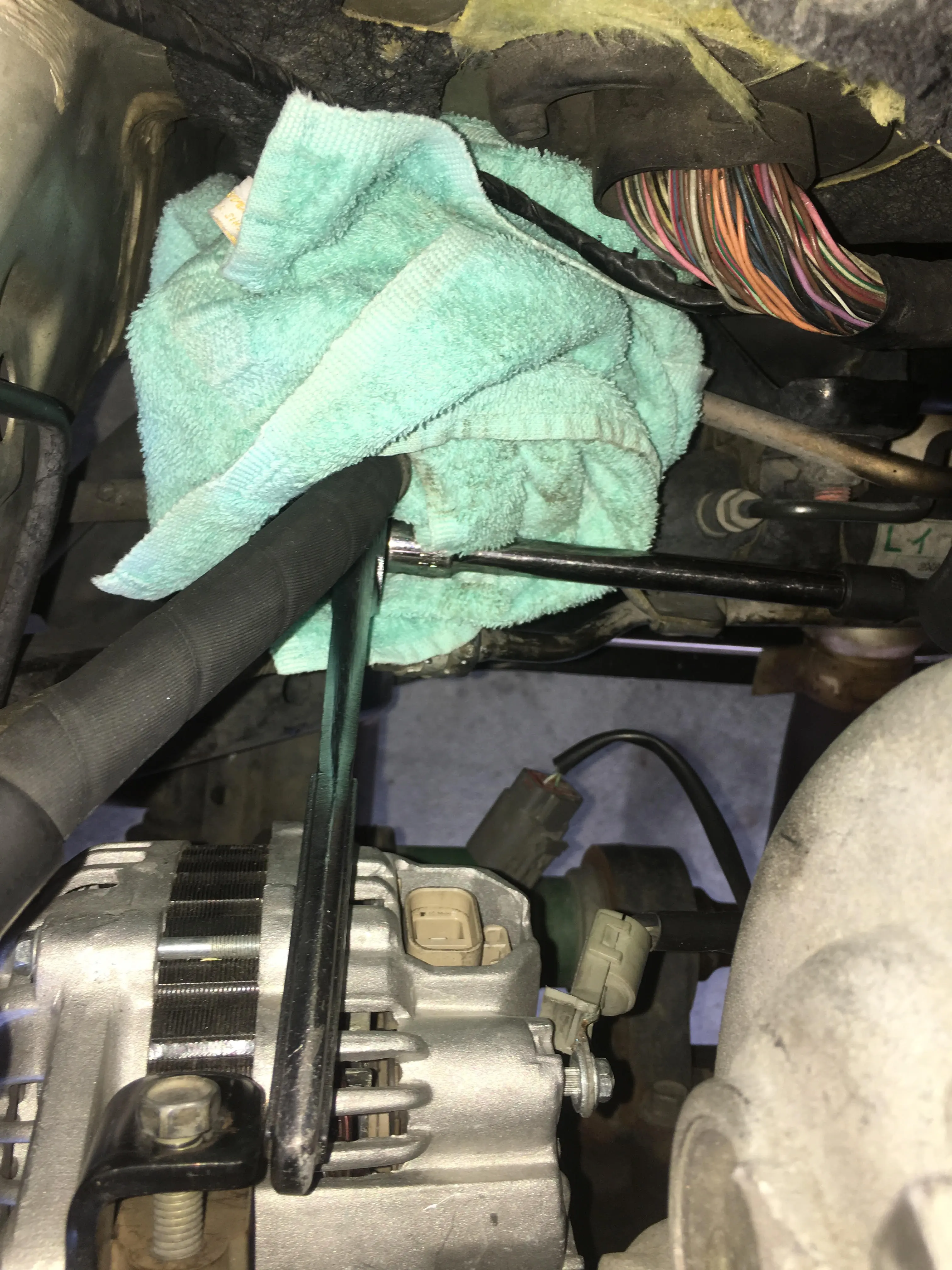

Update:
I was able to get the horizontal bolt off by putting a 3/8 12 point 17mm socket on the nut under the intake manifold first, then attaching about 24" of 3/8 extensions, and resting a a 3/8 drive socket wrench on the metal part of the alternator.
I supported the wrench with AC and power steering lines (cradled with a rag) and cranking the bolt from the driver's side with the throttle body off. It was on tight but not as tight as the bolts that secure the mount to the frame. Thanks for all your help, and yes this is possible to do without removing the intake manifold.
