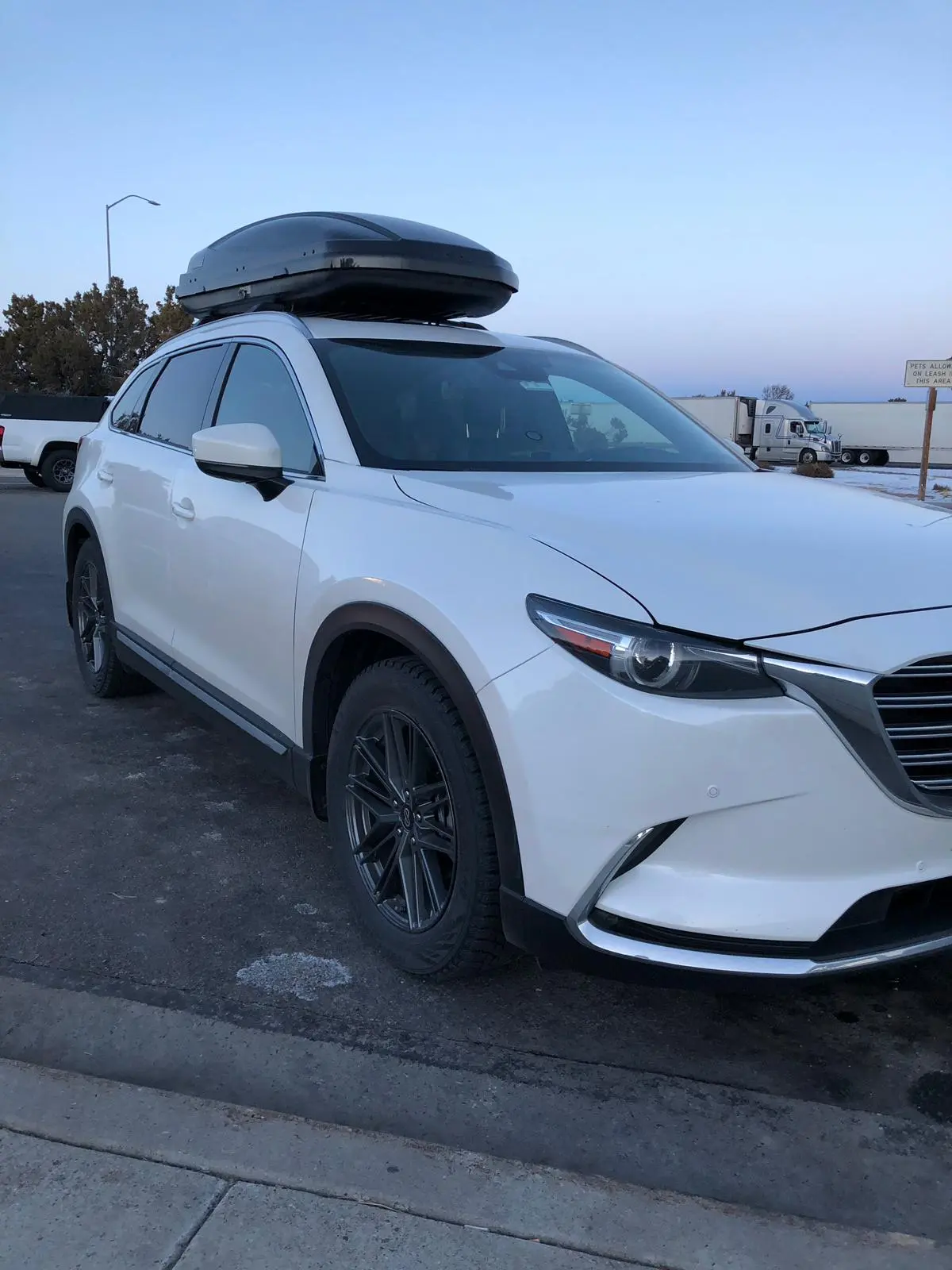

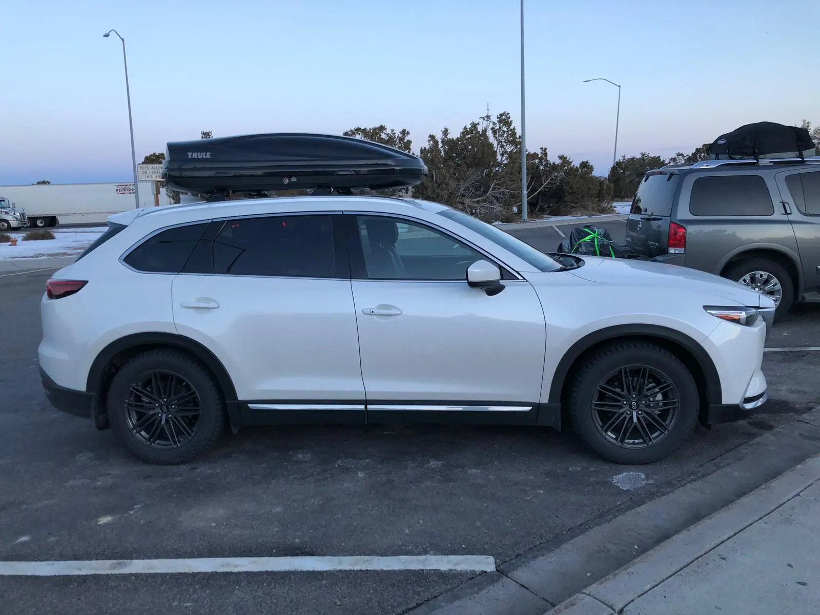

Hey ya'll,
This thread was so helpful in trying to find snow tires for my 2017 CX-9! Thank you! I've never bought rims or snow tires for my cars so this was a first.
Tires: Yokohama iceGUARD iG51v P255/55R-19 from SimpleTire ($651.88)
Rims: 19X9.5 VERDE PARALLAX BLK MACH from Tire Rack ($596)
Installed at Sullivan Tire ($104) - Unfortunately, I didn't realize they never gave me back my factory lugs and wheel locks! :( So I'm trying to find the proper replacement set and lock (would love recommendations!)
