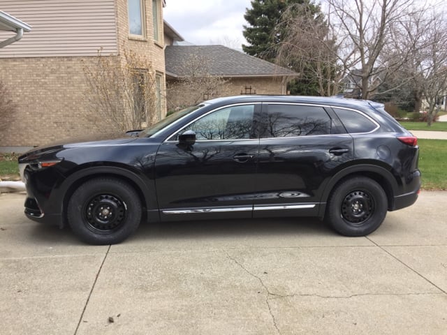

Here's mine. Settled on steelies, as the deals fell through on every set of alloys I had a line on. Time was running out.
Top it off, Canadian Tire had 20x points this weekend. I got $180 off, plus I get $80 off from Michelin.

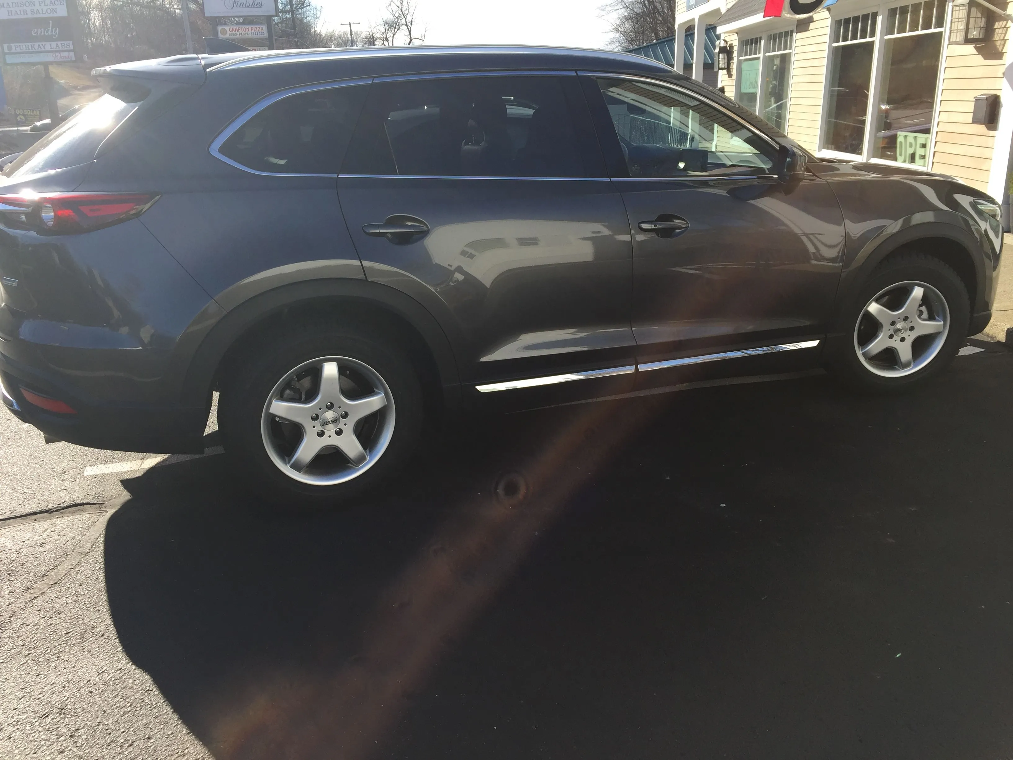

I got these 19" Fast Wheels rims installed with Blizzaks. Not sure how I feel about the black since it almost looks like steelies, but I was in a rush to get something on there...

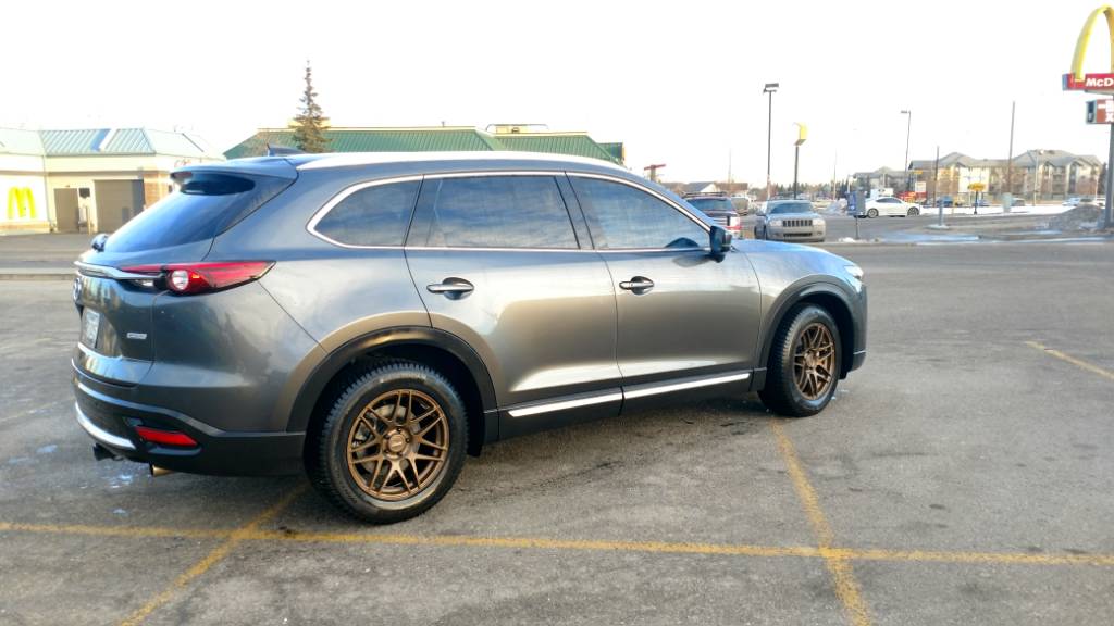

My winter tire set. Klasse APEX 18" in matte bronze with Continental WinterContact Si.
Sent from my XT1650 using Tapatalk
