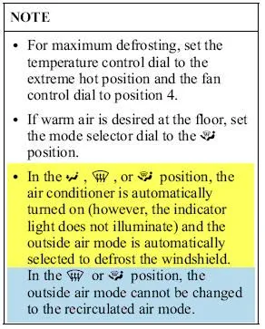

AC is forced on when you use the Automatic Climate Control... if you use Manual mode, you can turn it off, but only in certain modes.
In Manual mode, AC is forced on in Defrost, Defrost/Feet split, and Feet Only (yes, I said Feet Only... crazy but true) The 'effin messed up part is the light doesn't come on so you'd never know this, but RTM and it'll tell you the same. (RTM)
AC can be kept off in Vent and Vent/Foot split modes only.

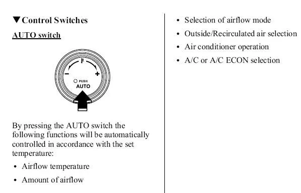

Below are excerpts from the 07 5 owners manual...

Jandree 22 thanks!
I noticed the ac running in the manual/ foot mode and the 08 manual has deletted your information...so the dealer has been trying to figure it out with no luck . You have just answered the question ! now I know I don't have a malfunction with climate control. thanyou thankyou!
