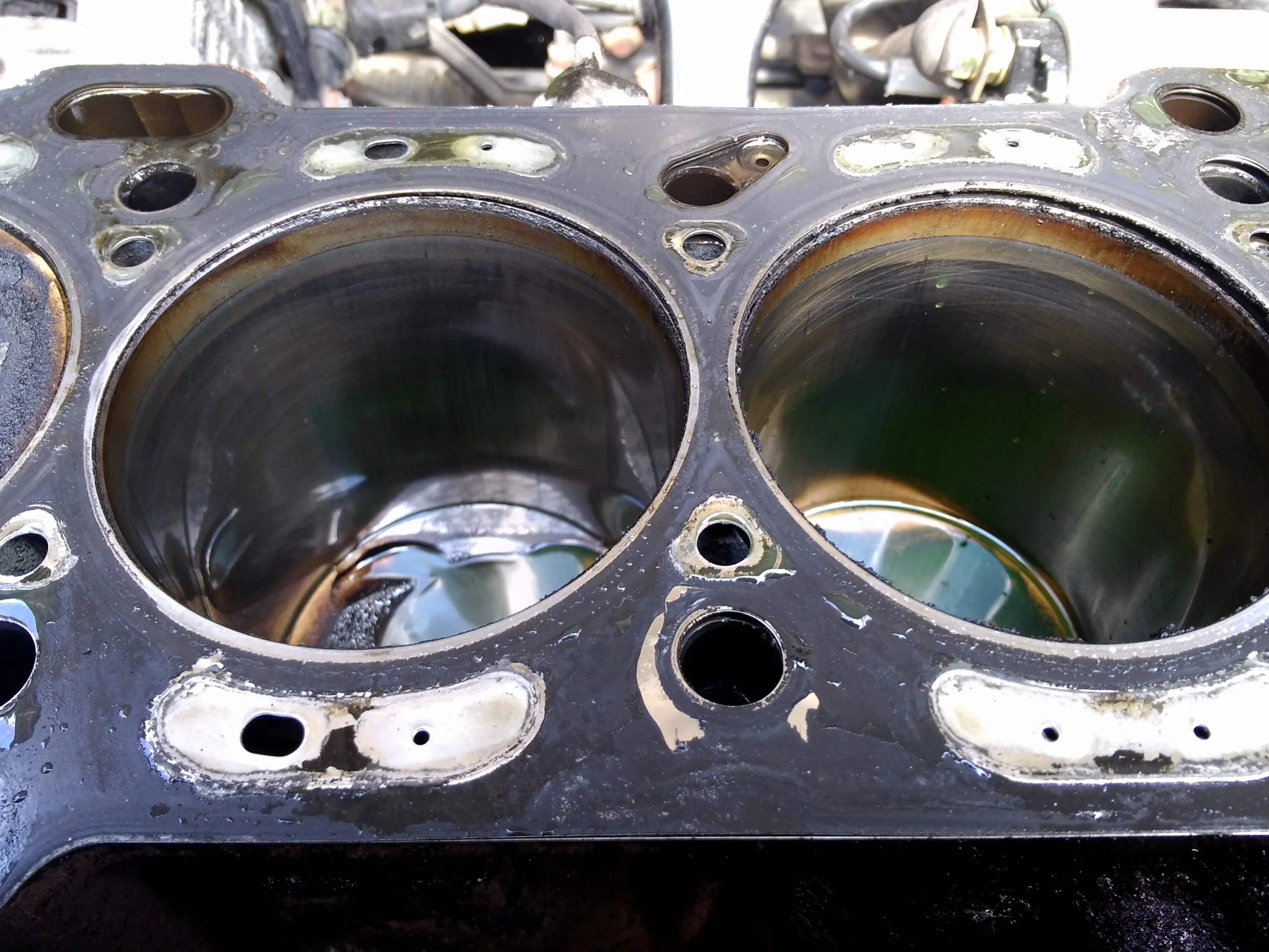

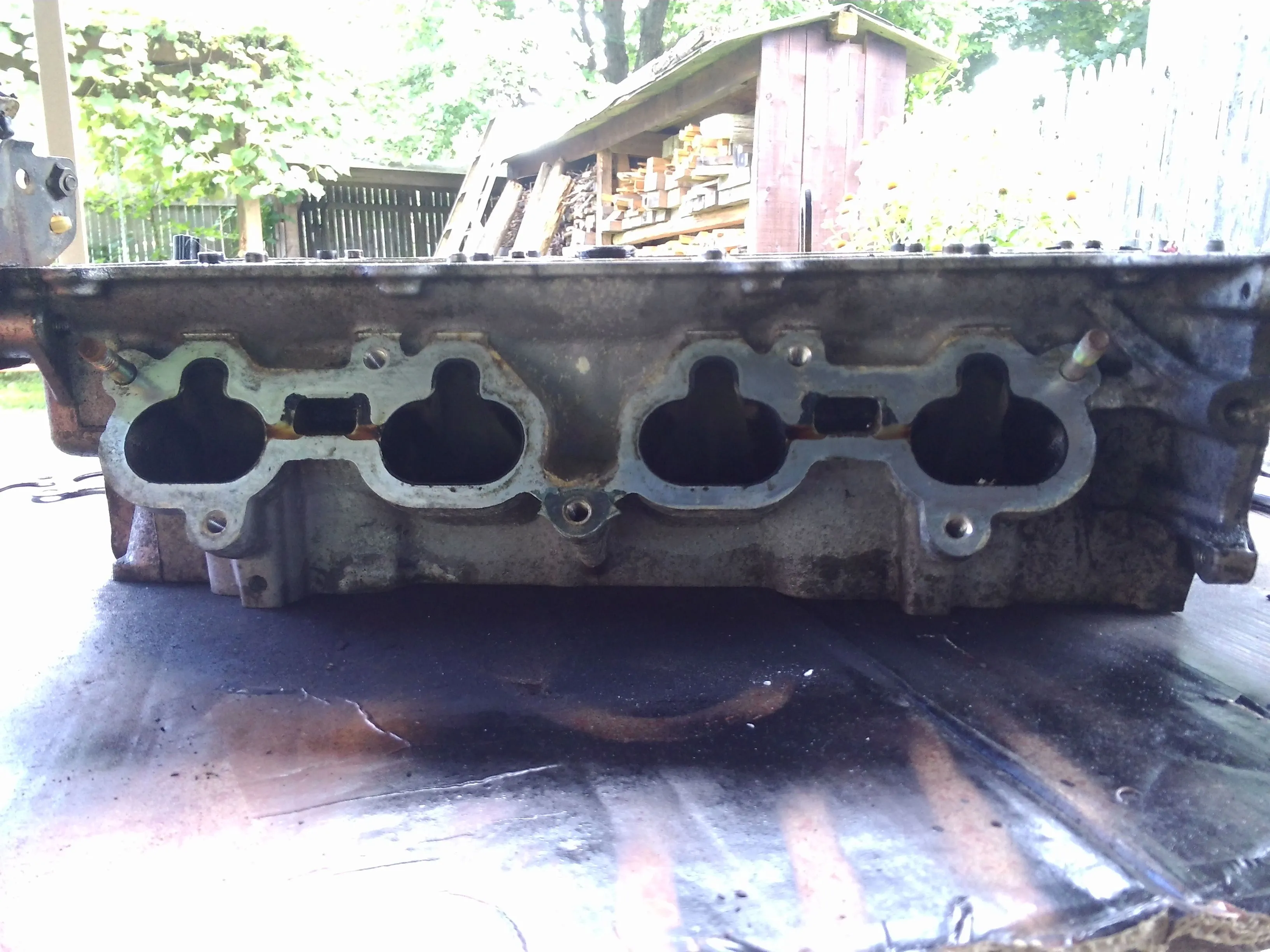

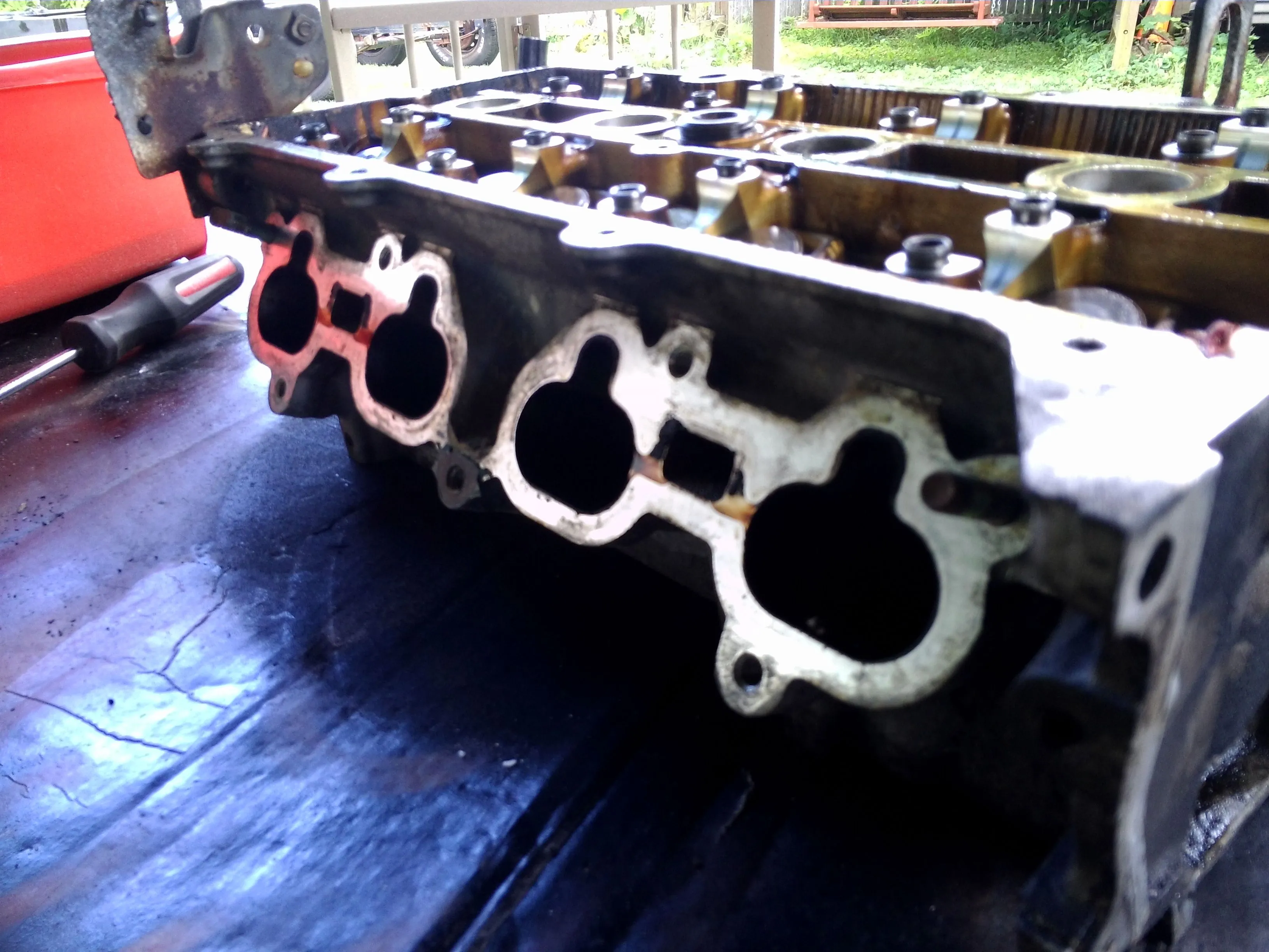

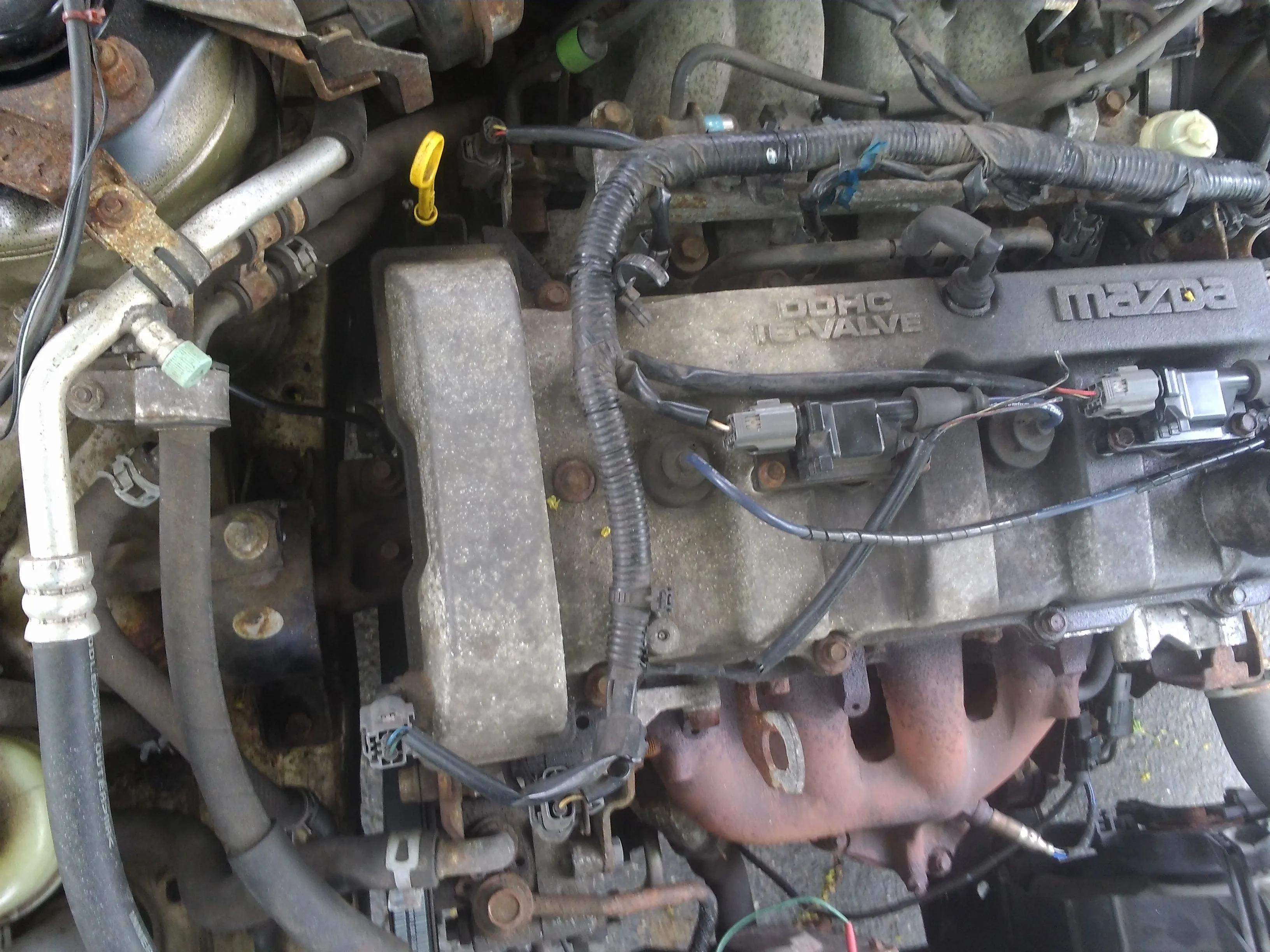

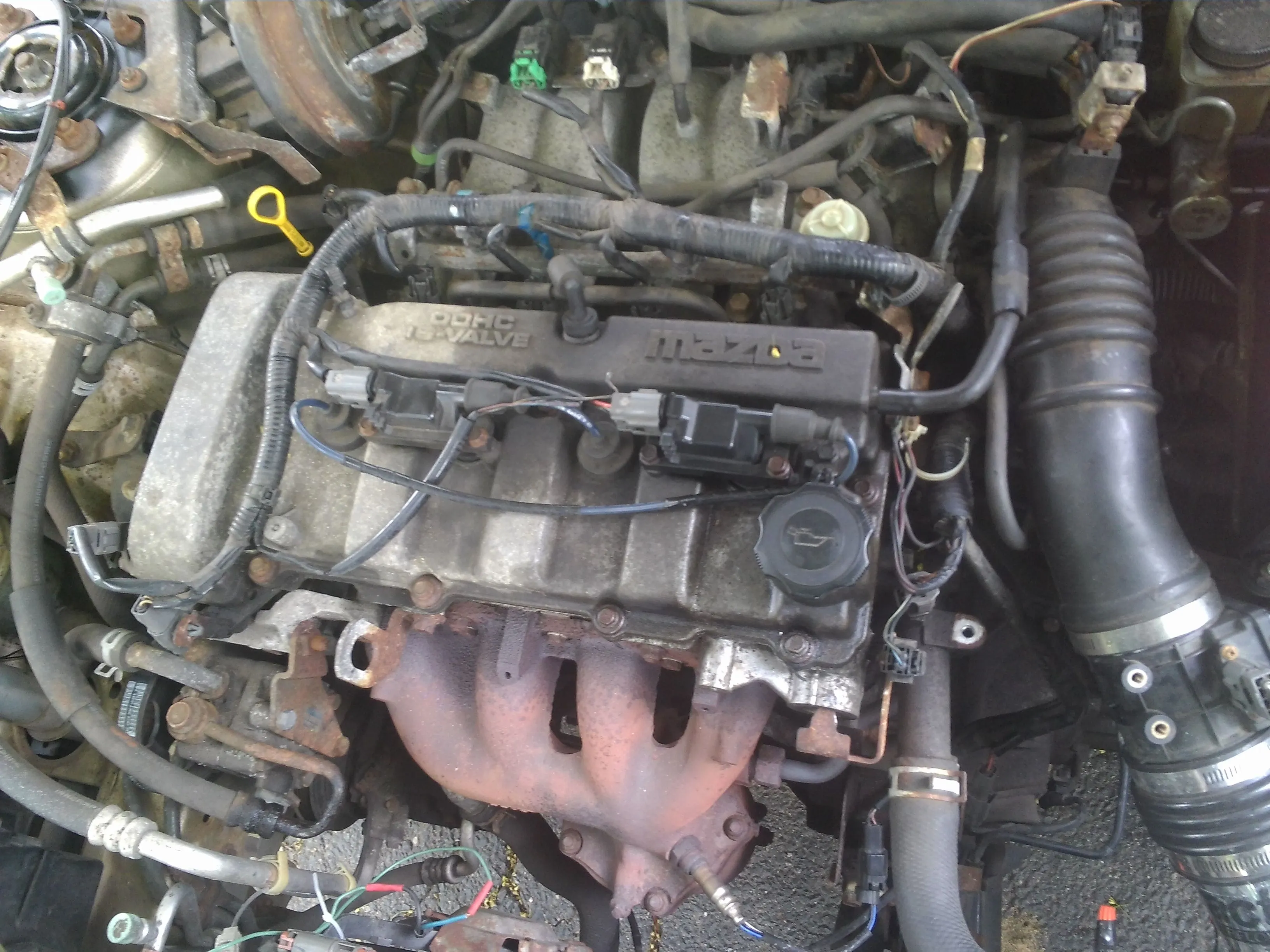

So here is the deal. I have a 2002 Protege es 236k miles on it. And I may have spun a bearing or a wrist pin not sure yet. I have a fair bit of knowledge on how to fix cars but ive never rebuilt an engine...till now. So far I have a full gasket kit, timing belt kit, clutch flywheel pressure plate and pistons rings and bearings in my shopping cart (waiting to see if i need oversize) aswell as other random bits. on top of the motor i have also started plasti dipping my car and repairing a rather large hole in my backseat floor(pic of that to) Id love to hear feed back and stories on what you guys have done and im sure ill be asking a few questions :) for now i have a few pictures of the tear down and yes i know i should have pulled the motor but i dont have a garage :( IMG_20130514_142111.webpIMG_20130514_142121.webpIMG_20130721_151143.webpIMG_20130721_155215.webpIMG_20130721_155236.webp

well i managed to get the windage tray out the the pistons and rods... one was spun two had gouges in them and one was so bad its almost non-existent im talking paper thin if i can figure out how to post pics without a url ill show them. aside from this the crank is within spec 1.888 on all but the really bad one 1.884 i still have to check the rods but the one i did came out at 2.014 Ill call a couple machine shops and get an estimate on the crank tomorrow

I also finished rebuilding the head ne valve seals and lapped the exhaust valves they were pitted pretty bad but came out good if i had a better camera id take pics but they just come out blurry on my phone
