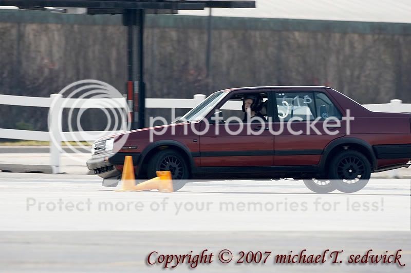

Lifting an inside rear wheel is part of the grand tradition of hot hatches through the years. All the cool cars do it...especially VWs.
Hell yeah VWs (even 4-doors) love to 3-wheel! Subcompacts rule.
My old '90 Jetta
