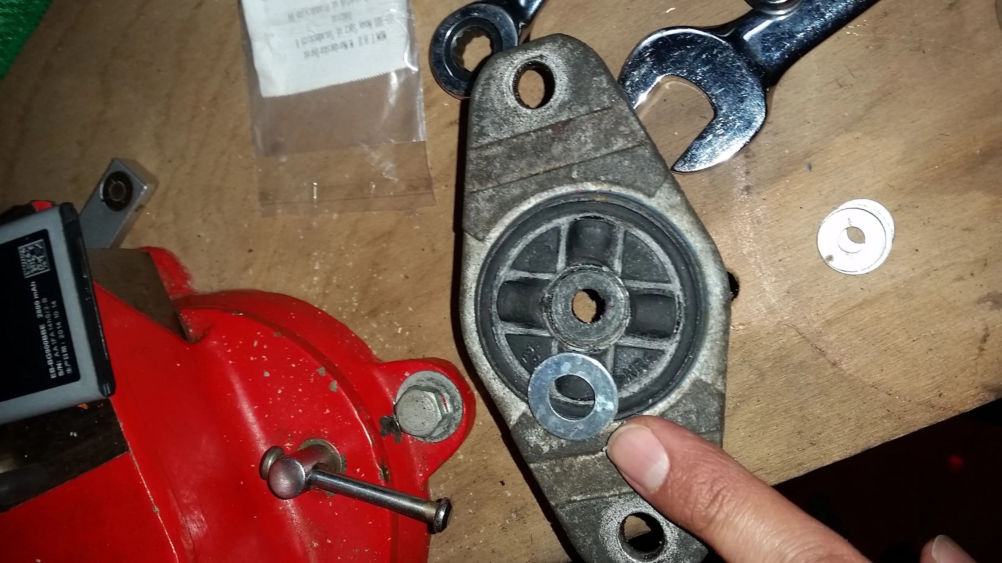

Same here..bought Bilstein .....and clunk ! I suggested do not buy a billig rear schock mount not original , but instead add a simply washer. 20180130_184626.webp

add one more? :)
