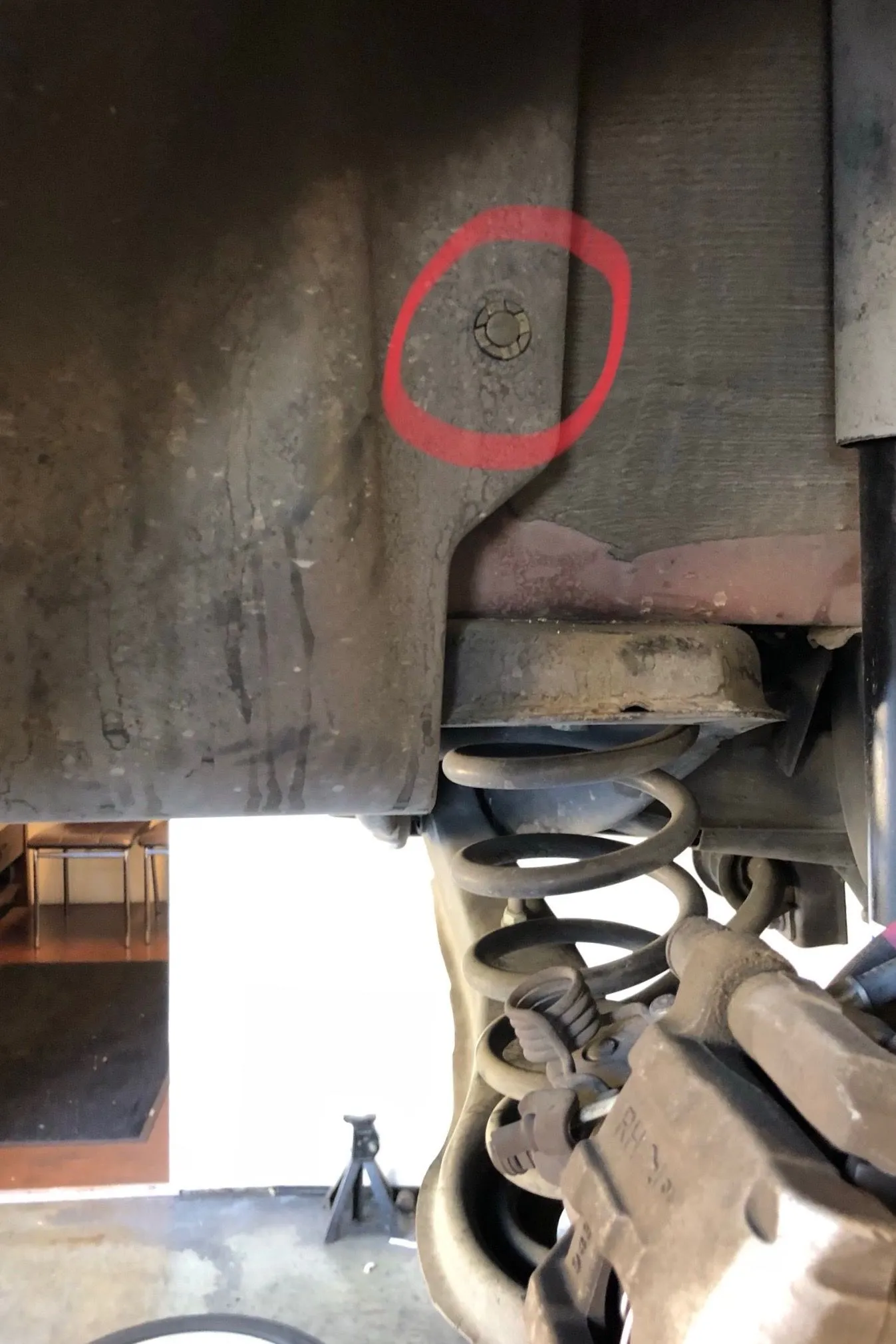

E6D15F25-4EA0-449B-A5DA-0CC127B643B4.webpE6D15F25-4EA0-449B-A5DA-0CC127B643B4.webpEverything is tight

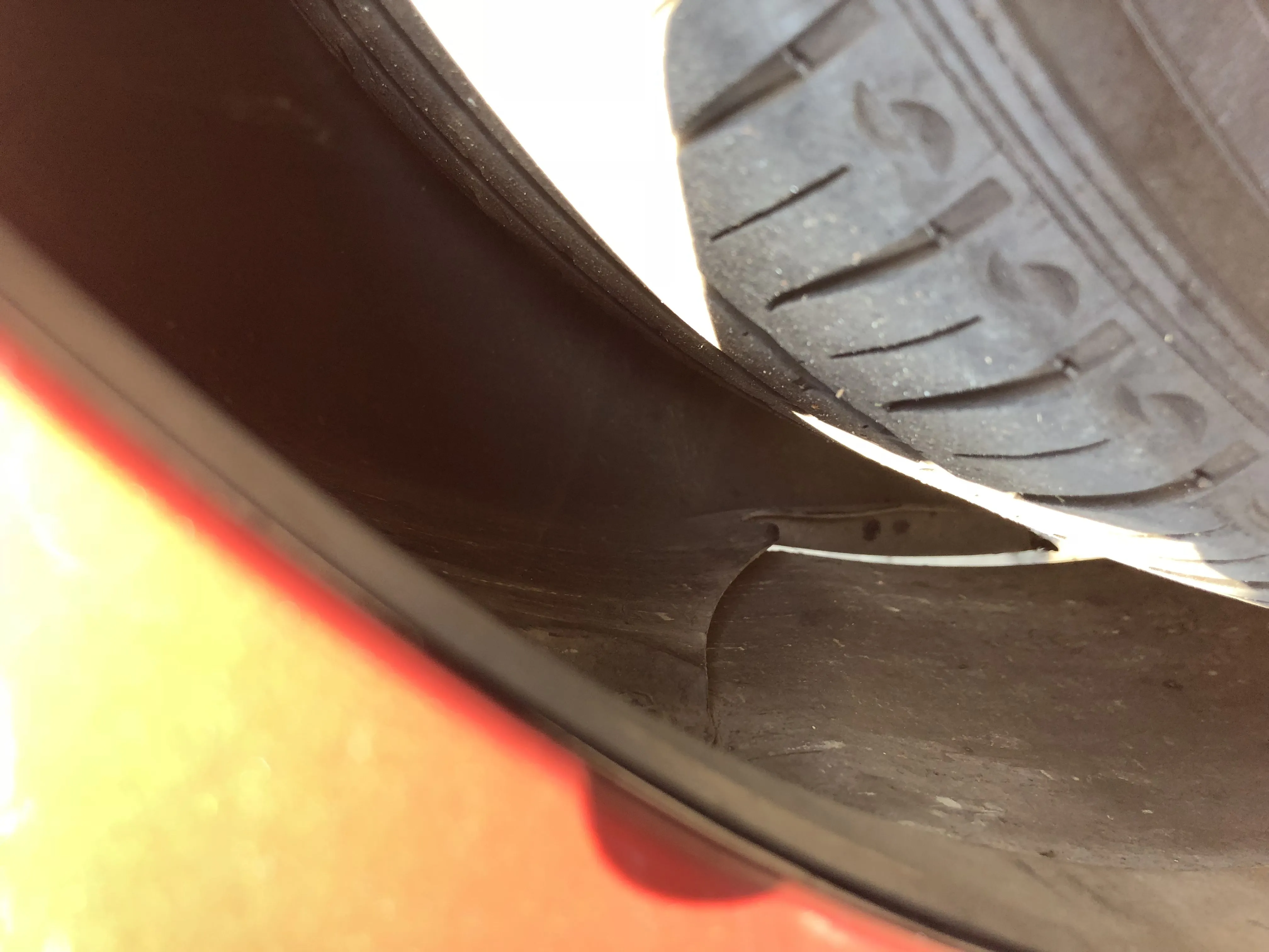

This rear plastic panel is loose and is hitting
I believe this is culprit
Can I remove it for good?
Well fixed the plug on the rear tab. But the clunk is still there.

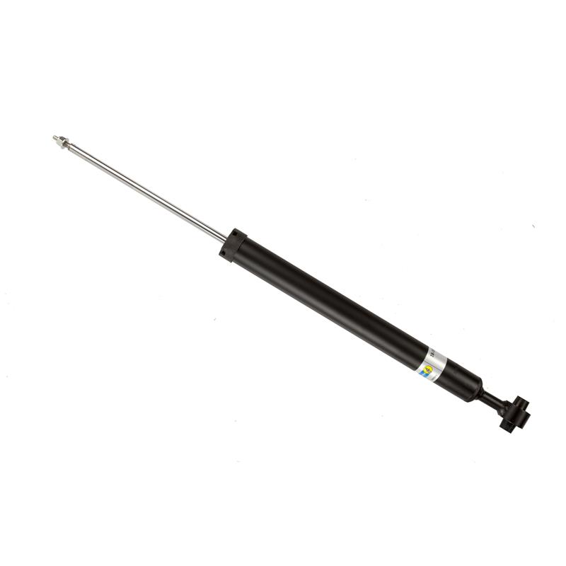

Yes, I drove without right passenger shock, and right noise was gone,a nd there was slight clunk in left. Drove without left, no noise. Bilstein rebounds perfectly fine. Mechanic thought there was a washer where shock meets shock mount ( I didn't have that during install), and he said it is moving around there clearly. After putting the washer, noise is down 50%, but it still there. Thus I am leaning towards new shock mounts?

I have the BIlstein replacement. The shock rebounds perfectly, no issues in driving. How could I tell if the shock is bad? I will order the upper shock mount today. It visually looked fine, but maybe that is where the problem is.

The lower shock mount is actually a physical part of the trailing arm - the 'box' for a lack of a better word. The Bilstein come with bushings that should fit SNUG into the 'box', which the pass through bolt secures by clamping the box against the bushing against the training arm. If the Mechanic notice there's a gap, then the bushings are wrong length (err, width?). This is the same limitation with using Volvo V50 shocks, the bushings are smaller where you need to add a wash or two (or thicker). You can likely add 'another' washer (both sides) and really tighten the thru bolt to lock it down. If it is indeed a bushing issue, call Bilstein US. They are very reasonable and may be able to help you source a proper bushing (or you can measure yours with a dial caliper and shop online).
NOTE: Measure the width of the Bilstein bushing. Go to kyb catalog and look up the specs for Mazda 5 rear shock bushing and V50 rear bushing. Which one is closer to yours?
