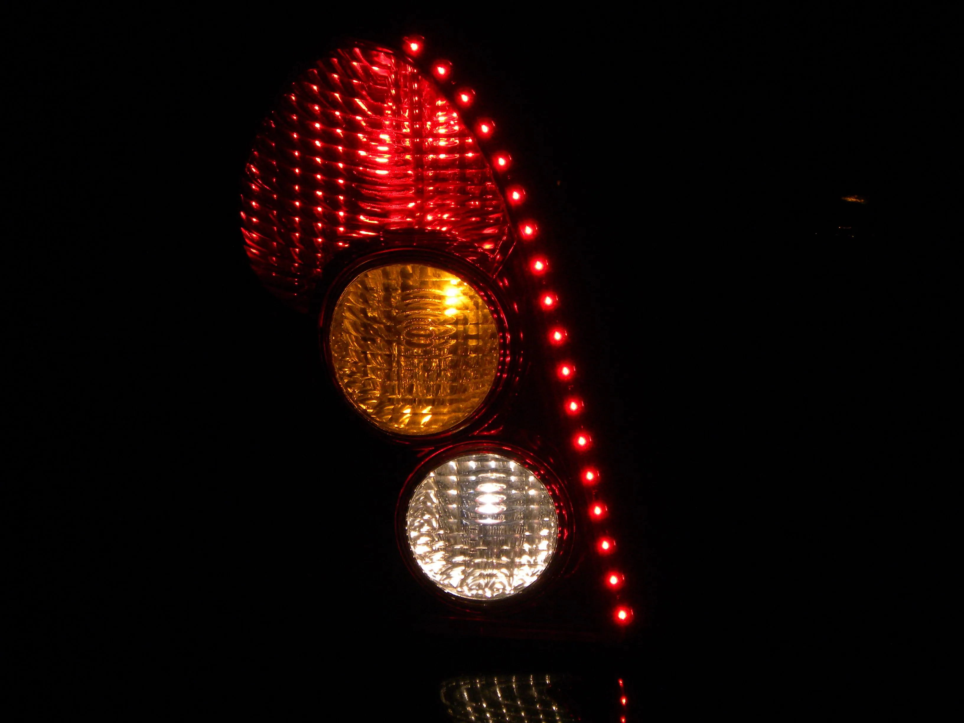

Rear Light LED's
Here is my latest Mod
  • 14" Led's
  • City Lights in Blinkers & Rear Lights
  • Raybrig 921 Super white Reverse Lights
Led's from Pep Boys - 14" red LED's by Pilot @ $25 pair
What do you guys think....?
Looks cheesy IMO. But credit due for doing a mod on your own :)
do you have a pic showing the whole back of the car from a distance? might look better if you could see the whole thing...

To each his own I guess. Next install is the White LED's in the front.

I wanted to add city lights to the front headlights where there seems to be an open slot, but seems pretty risky to do this and get water / moisture inside the lens. Has anyone tried this....?
it's the same process as painting the trim inside the headlamp assemblies.
heat them up for about 10 mins at 200 in your oven, pry them apart, do your bidding - put them back in for about 10 mins - push them together til the lens is fully seated (it'll click on the little black tabs) and voila! you're done!
i actually did the city light in the high beam slot when i had pro5 headlights on my ES, since, as you said, there is already a spot for it. the european pro5's have the city light there.
the socket for that hole is the same socket that is used for the corner lights on the sedan, if you are serious about it. cut the hole right, and it will seal itself with the gasket on the socket. after you cut that hole in the back of the headlight, you have to CAREFULLY dremel out a hole in the high-beam reflector to let the socket come through. if you do it right, it looks fantastic at night.
here is what they looked like at night -
attachment.php
