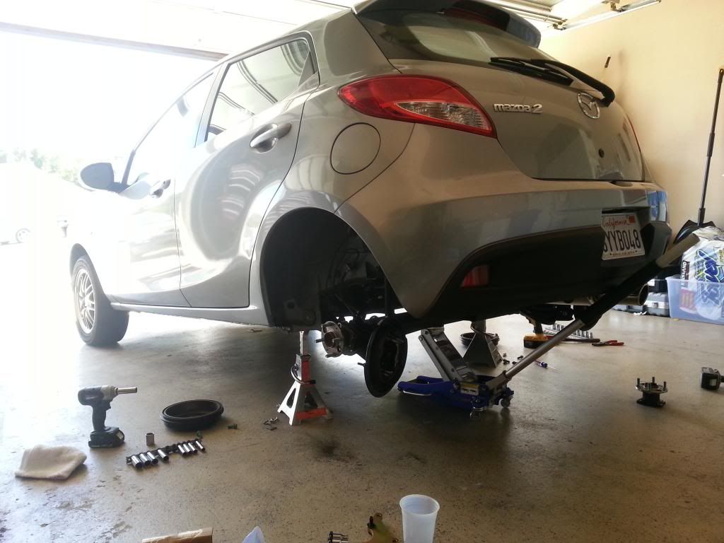

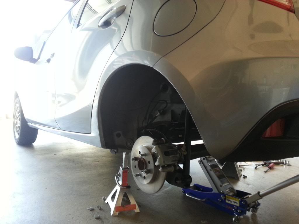

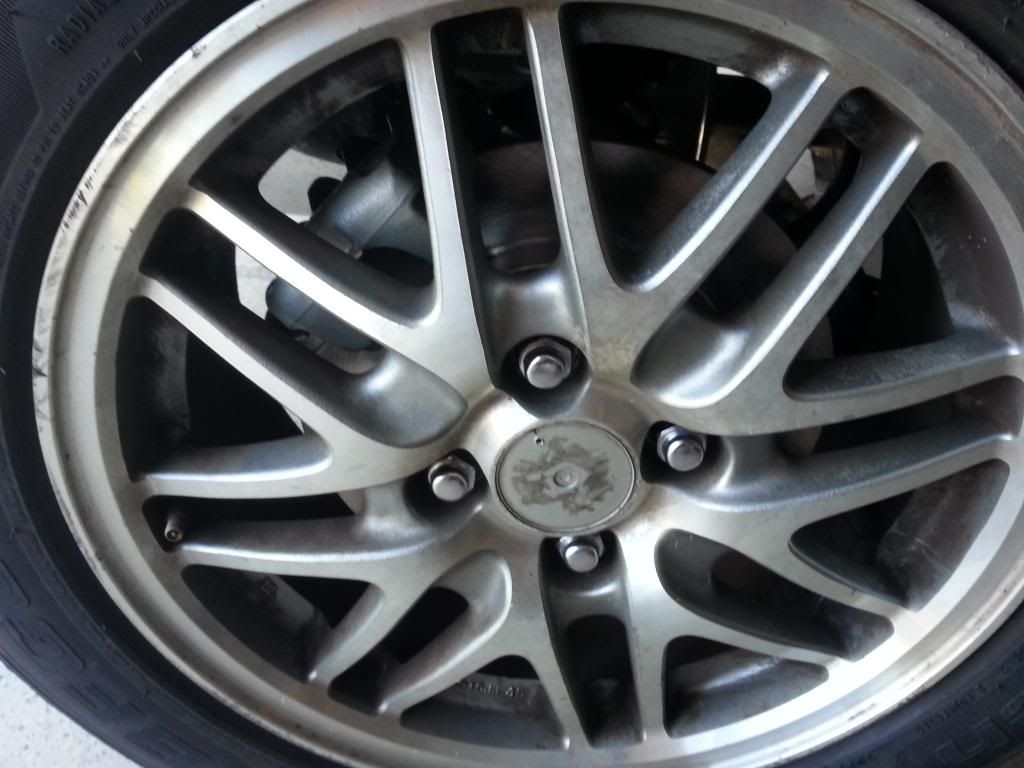

Ladies and germs
pixors
Big thanks to Mark Lapp from Lapp racing for getting this together
Wow it's real !!! I am interested in your impressions of the kit , fit , finish and what not . Looks great .
EF9's relatively local and we've met before, I'm looking forward to checking this out in person some time. It's definitely something I'd like to do to my car, but I'd want a front brake upgrade to go with it.
looks interesting, the rotor is really thin is it just 1 pad/surface per side? Also very interested in hearing about the performance/thoughts on the kit.
