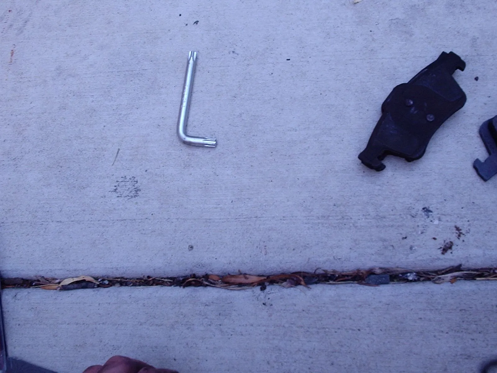

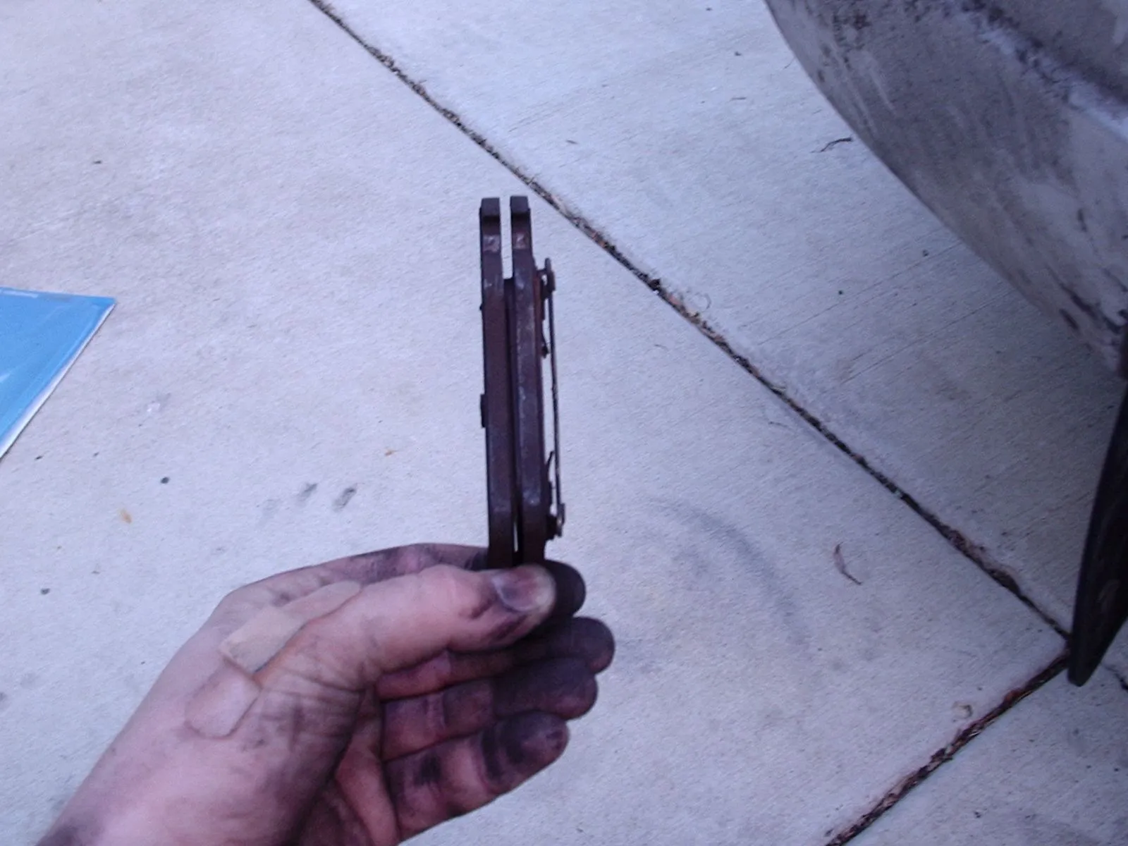

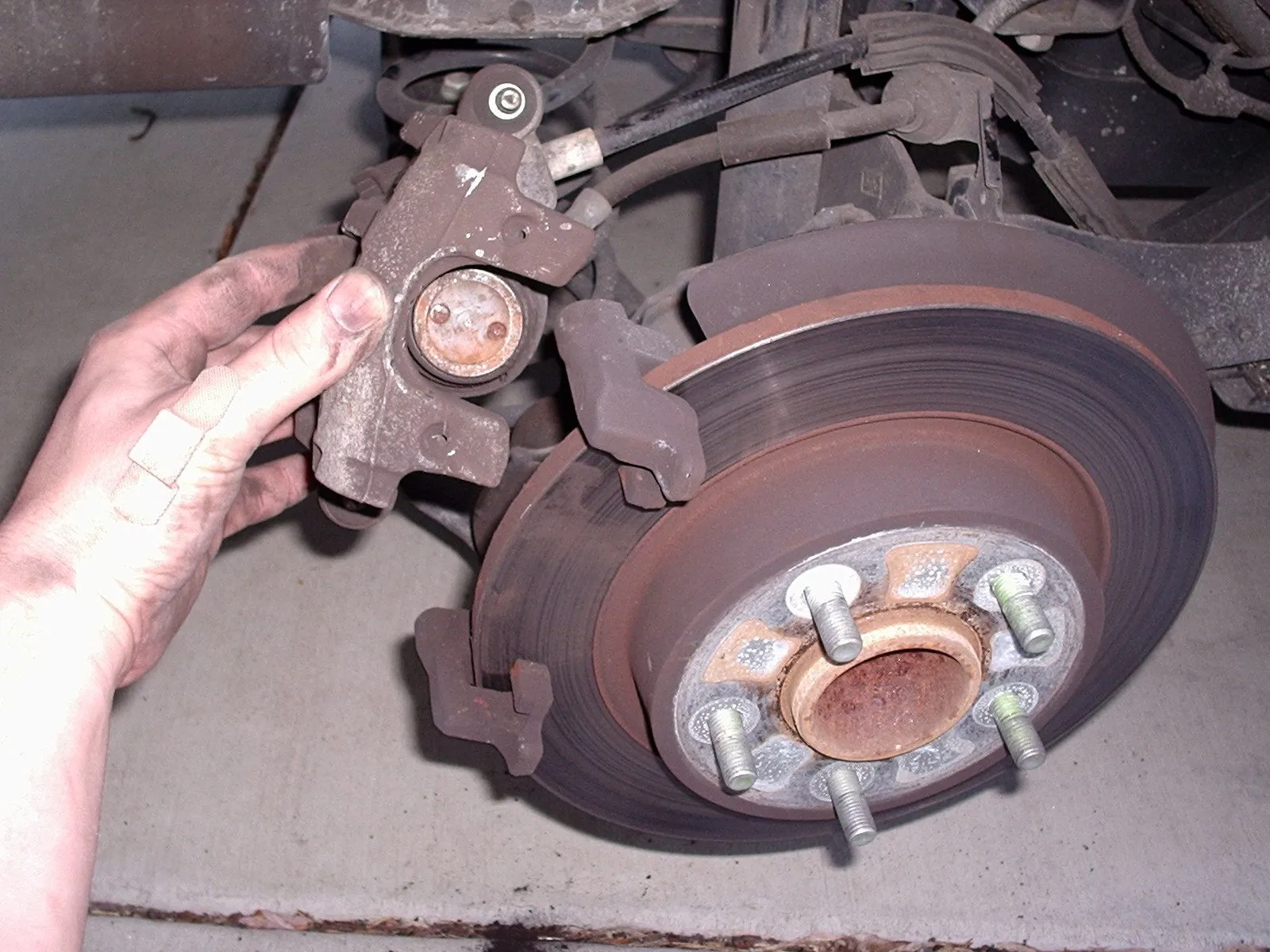

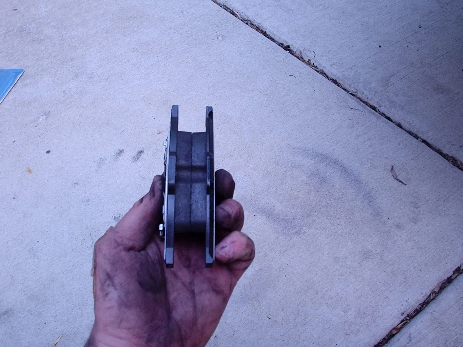

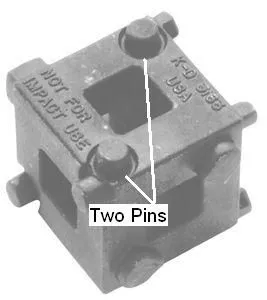

How do u put a piston back in the calliper? I had a hard time pushing it back, really hard time, almost didnt throw away my tool, cause it wasnt helping too much, and yeah, mazda 3 uses star , or Torx set, its either 45, or 40 isnt sure now, look at the pictures,I think it says 45 on it, still when u buy torx key set u get them both, so u are OK,also look how bad my rear were, only 33000 on`em, but at least now Mazda is using better compound on those pads, at least that's what my service manager at the local shop told me, here are pics, and yeah,he gave me a quate for 294$ for rear brake replacement, with rotors turning included, damn I was like wtf? also he goes and say something like yeah, mazda used compound that was too soft on the pad in the rear, and IM like duh, how do u think we get all that dust from? air? that's what I was thinking , I just could get myself to say it out loud, cause I will be back there for some work on my car, oil, glove box, side door panels, so that would might piss him off a little,so the ? is, IS THERE AN EASIER WAY TO PUT PISTON BACK INTO POSITION ON THE CALLIPER? or it is that hard?and yes i did open the resourva for brake fluid

Well, if it's ANYthing like the Protege's rear calipers, you don't push it back in; You have to use a hex (Or maybe torx, in this case) bit, and turn it back, which pulls the piston back into place. Then, once you install it again, you tighten it back down all the way, then back it off one third of a turn to adjust for the hand brakes. =) Hope this helps!
Not really, cause Iam talking about my last pic, where the part im taking about is this rusted part in the middle, that pushes the pads toward the rotors, too bad its rusted already, but they work fine, so are the rotors, and what u are taking about are those two nuts u see on the next pic i just posted
Nope, looks like they aren't the same... You'd have a bolt RIGHT behind the piston if they were. But I DO recognize those divots. Try twisting the piston while you push, perhaps? That's how I have to reassemble calipers after a rebuild. *shrugs*

Gold I was talking about the tool for the oil filter, isnt it like 80$? and not the one for the calliper, also u read the post the calliper on 3 is diffent then the one on Protege, plus I didnt see any holes to put that tool to a good use, anyhow, if or better yet when U change the rear brakes plz tell me how u did it cause Im more then interested how u do it, and if there is a easier way to doing it, tx, also if anybody have a pic of the rear calliper of Protege, and the holes where Im suppose to use that tool I would apprieciate it, tx

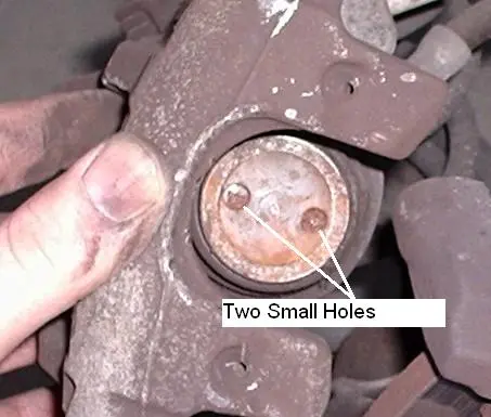

I haven't changed my brakes yet but if the pictures you posted are from the car you're working on, then the tool I linked to the picture of will work to get the piston back in. There are two small holes in the piston that the two pins on the tool fit into.
so how big is that tool for piston? must be really small, so yeah, im buying it, also I will have to see how hard it is to replace that filter, it is as easy as it was in the Grand am then Im doing it myself, if its more like the honda civic then the dealer will see my car for the oil change, anyway tx
The tool is about a 1.5" cube. You might be able to find it at a local parts store. It's pretty common. Call around before you order it.
The filter is definitely easier than a Honda, even with the cartridge filter.
so then simply turn it clockwise and it will slide back? thats it? damn that is simple then (cool)and will it work on the front too? or dont know? so will it work on front too? or not? or do u need another tool to get it that one done?
Sometimes clockwise, sometimes counter-clockwise. You should be able to tell once you start messing with it.
Here's a couple pics to clarify, showing the two holes and the two pins.
