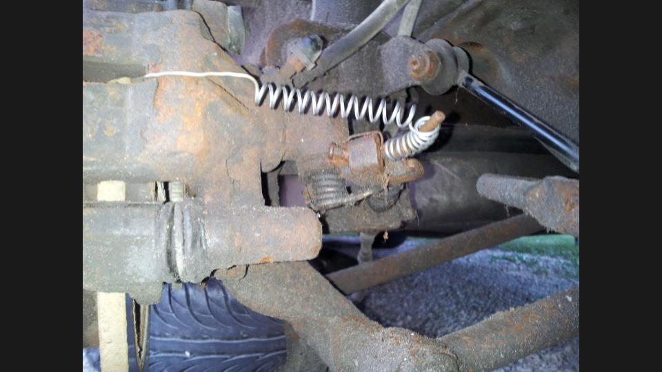

I had my rear brakes dragging because the P-brake cable was all rusted and seized.
Make sure the cable connection point on the caliper is rotating freely.
Watch the movement while someone pulls the P-brake.
I attached a reinforcing spring to release the brakes until I got new parking brake cables.
