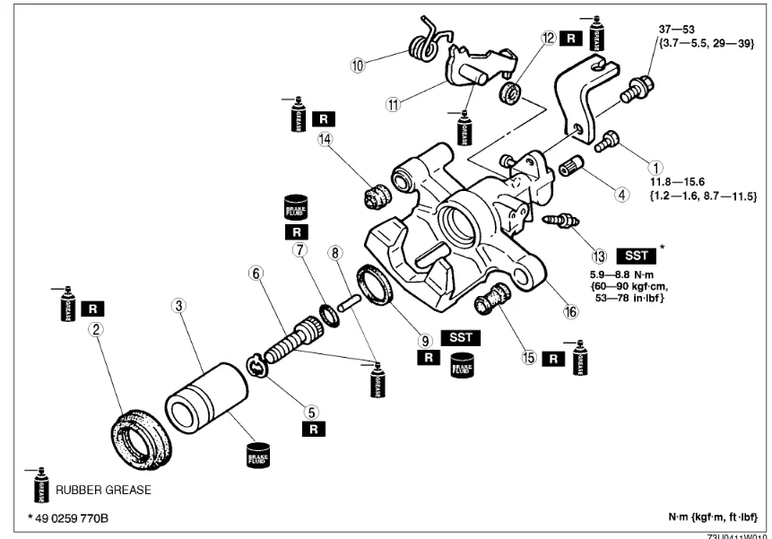

So I rotated the piston with pliers and it goes in and out when I rotate it. But again, I can’t get the spline/allen screw to engage anything. When I look inside the hole, I do see a little cut out area, where I would expect some corresponding spline teeth to be, but I do not see any. Perhaps something has moved internally? Also, fluid leaks out that hole, so whatever seal that normally prevents fluid from leaking out that hole is apparently not doing its job anymore.
Do you have the screw labeled 1 here in place? If that's in place then it shouldn't be leaking out. It has a copper washer on it.
Are you able to push the piston far enough back in to put the pads on and fit it over the rotor? If you're able to reassemble and bleed everything, and verify the brake works, you should be good to go even without the adjustment screw working properly.
If I put the “cover“ screw with copper washer back on, the fluid does not leak out. I was under the impression that the fluid should not leak out even if that screw is not in place, am I wrong on that? I purchased a rebuilt caliber from Napa today, but have not had time to mess around with it yet.
