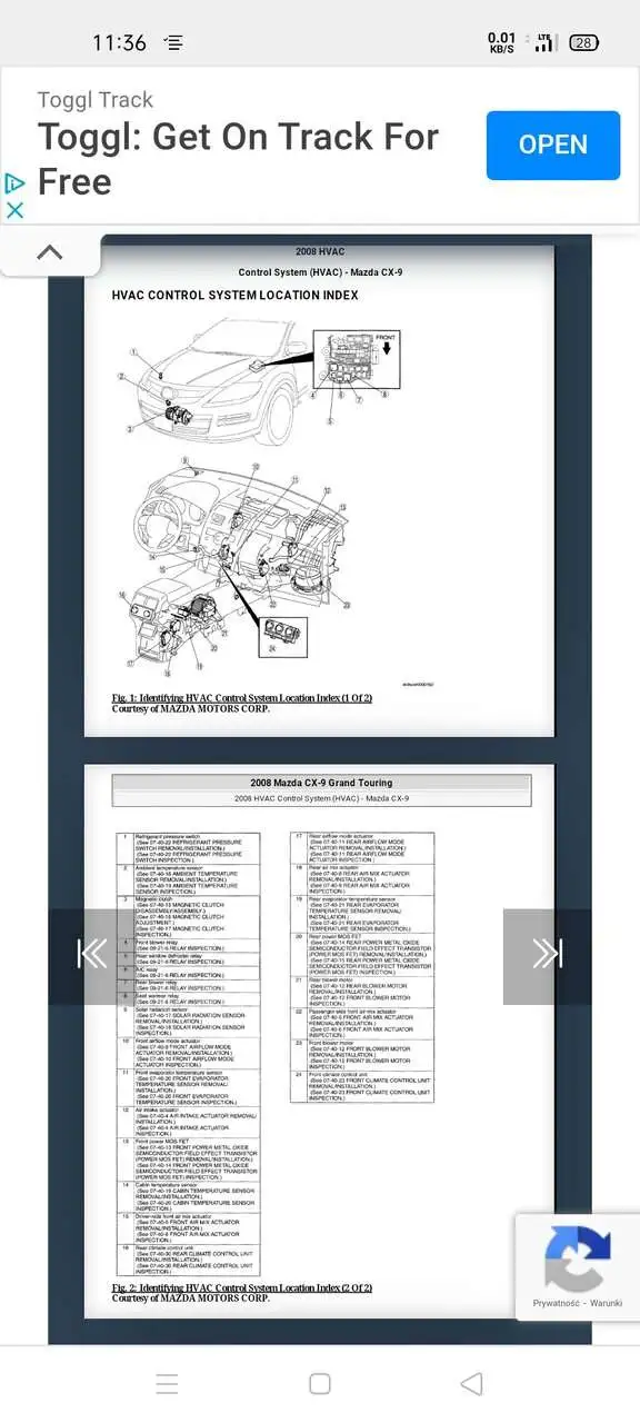

Thanks for the information. In the topic above there is a link where the service is and there is one expansion valve in the diagram. I don't see the other.
If there are two evaporators, there will be two expansion valves. The suction tube (large)
should be cold coming out of each evaporator.
number 1. Expansion valve. there is one, I cannot see the other.

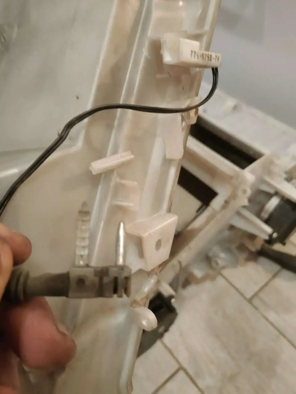

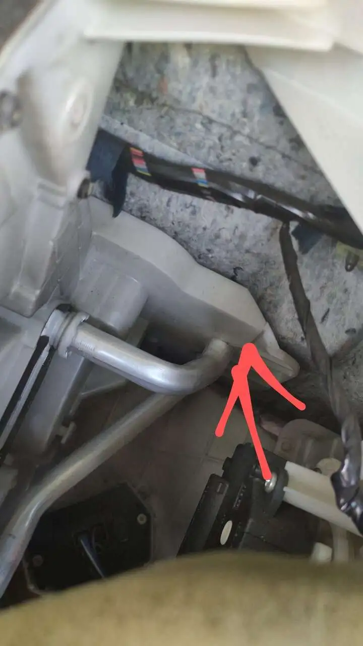

Today I wanted to pull out the evaporator. Failed to. A lot of work. I removed the cockpit and got to the heater. To remove the heaters, unscrew the metal beam. There is a screw on one side and 3 square screws from the bar They are welded together. I don't know how to unscrew them.Is the evaporator behind the heater? Can it be unscrewed from the bottom of the heater?
This is not going to be a fun job, I found a you tube video but it is poor. I have not done a CX9 myself but have done a Ford Edge which is similar. The link to the service manual in this thread should help. Good luck! Mazda cx9 changed evaporator and expansion valve
Thank you, but I saw it. For me, it is difficult to detach the heater tubes from the bulkhead wall. Are there any latches? how to do it? The second problem is the screws from the metal pipe under the board. The left side has 3 screws and the outer side. 1 screw is in the pit.
How to disconnect the heater tubes from the wall? How to do it?

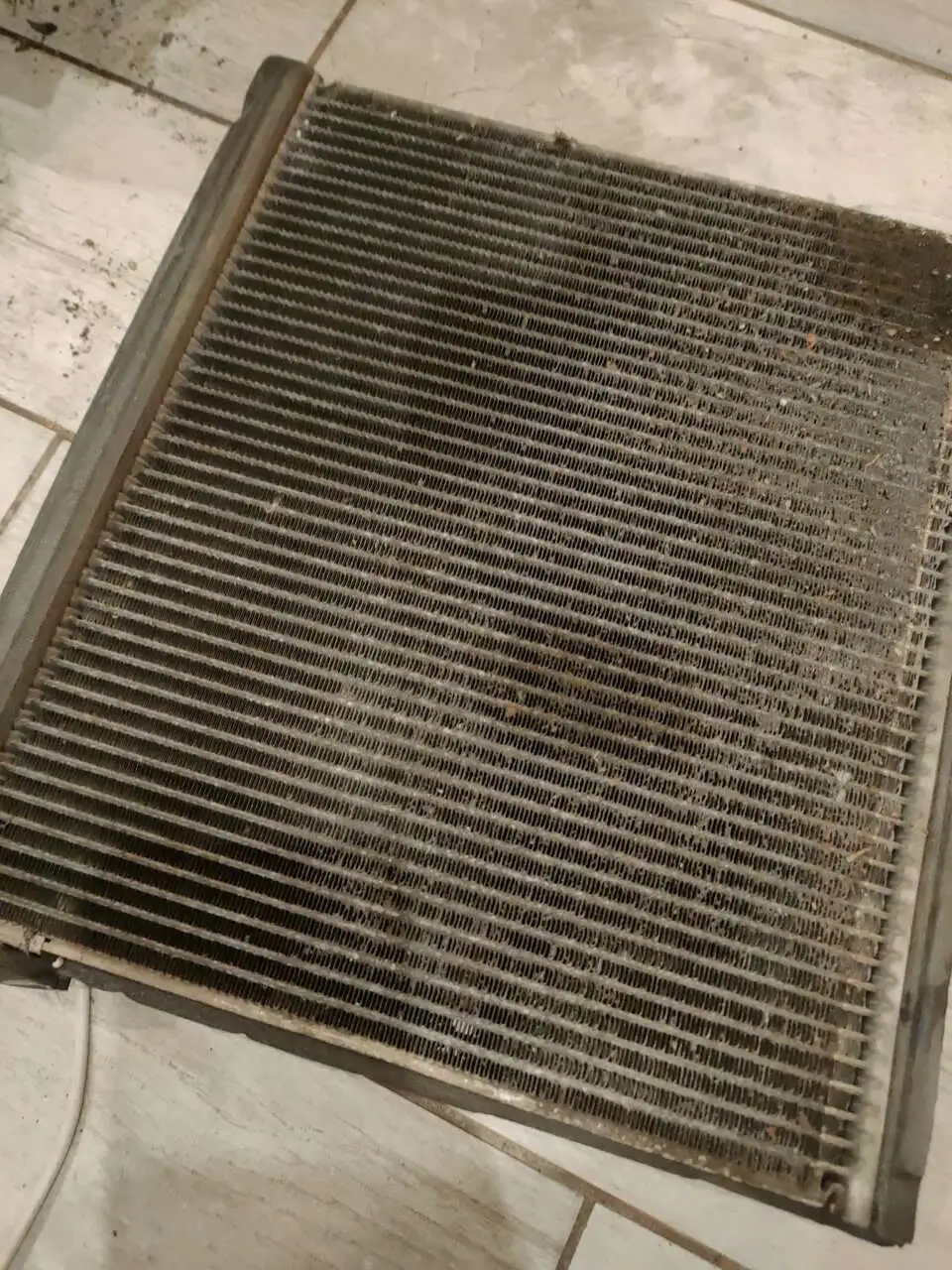

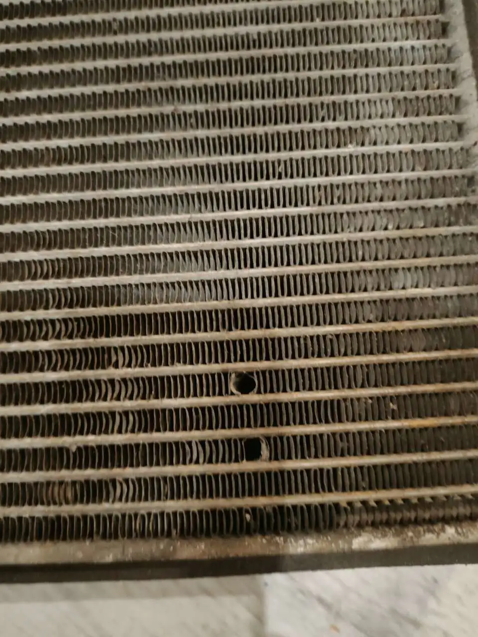

Check it out. My A / C evaporator.
Colleagues, what is this sensor? He's stuck in the coolers. Antifreeze?

The temperature sensor is used to prevent coil freeze up. The oily areas on the coil are the potential leak areas, as compressor oil exits with the leaking refrigerant. The hex plug on the valve is for factory adjustment. Its best to replace expansion valve with new. That is the heart of a proper operating evaporator.
So I will not unscrew because then there may be problems. The valve can always be replaced without removing the evaporator. Now I don't have a valve and online purchases are a waste of time.
