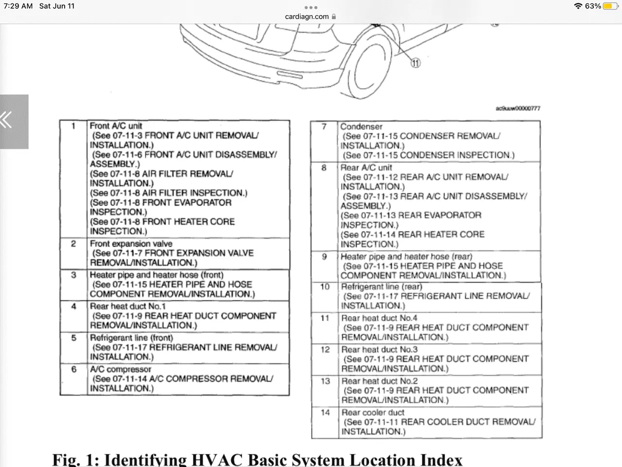

It is also possible that the main back vent duct is nearer the blend door and more air naturally goes to the back before it goes to the front. I do not have a schematic and I've never seen the Mazda blend chamber, so I cannot be for certain what is actually going on.
In the end, it could just be a design snafue and how the main front duct and main rear duct are in relation to the blend door and the rear main duct "wins" getting the coldest or hottest air first.
