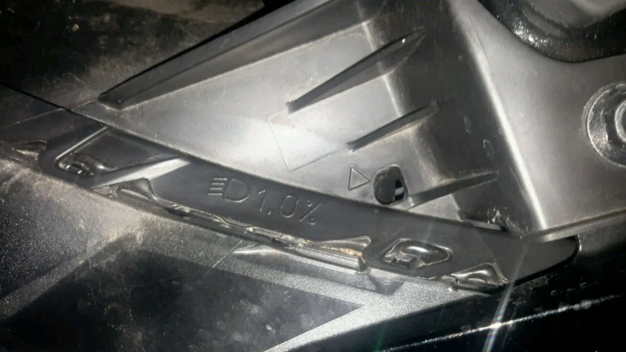

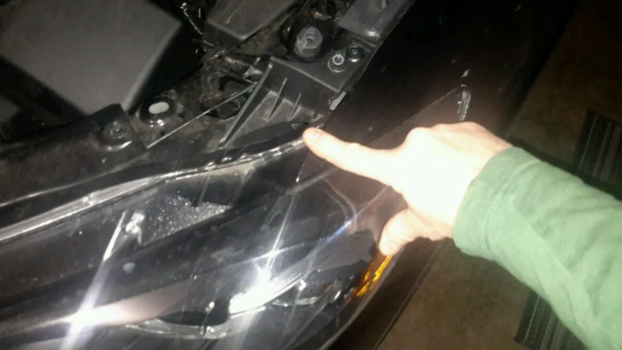

I don't know if this helps anyone but here are the headlight adjust points on my car. They are just in-board of the headlights, you can see the general area in the first pic. The second shows the little arrow and hole to insert screw driver into. Look down into it to see the gear to turn, same thing on other side.
Each light has another adjuster in-board of those that are covered by a white plastic cover. I believe these are for the side-to-side adjustments. At least that is how it's been on every other car I've had and not really meant to be used.
I had to adjust mine as they were way too far down. Also adjusted fogs to run more horizontal with ground (but not up into anyone's eyes ) as a low and wide filler. Makes an incredible difference this way for me. Love these lights.

I don't have i-activesense so would your headlights be different than mine with just tech? If it's the same as mine I have pictures at home of where to adjust the headlights. I can post them later.
Looking at your pictures my headlights look the same. I think the LED headlights are part of Teck not Isense. Thanks for pointing out the adjustment points, I have not adjusted those as I improved mine by changing the load sensor rheostat (post 11 above) and will drive a while to "see how it goes"...
