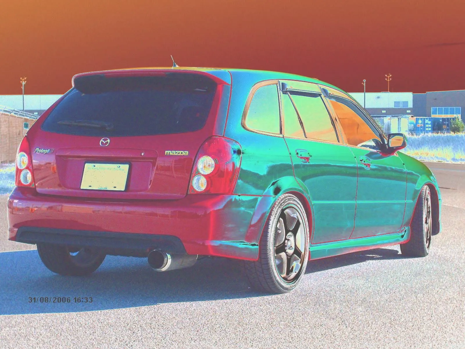

Coffee can...I'll see if I can post a pic...Sounds good too...nice DEEP rumble...and @ high RPM's 5800-6800 it quiets down so you can hear the intake...werd but very cool...
Here it is...

P5inder said:
Here it is...
Is that red trim between your rims & tires? If it is, I had some blue like that on another car back in the day & haven't seen that for quite awhile. Cool
where can u get red trim like that. i think it would look neat on my painted black stock rims.
Yes it would. If it's the same stuff I had it just pushes in between the tire & rim. Not sure where you might run accross that these days. Can't remember where I got it, that was 10 - 15 years ago when I had it.

Its paint on the wheels' outer rim. They came like that. I kinda want to get rid of it. Am planning on powedercoating the wheels a dark Bronze.
Not sure yet though...I want to find some 16X7.5's and If I do, I'll sell these instead.
