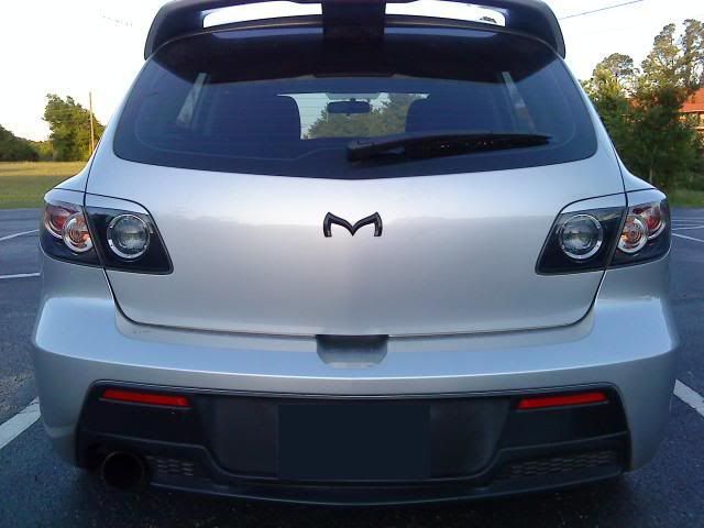

I personally think that the less mess you have on the back, the better. I took off the dealership sticker and the MazdaSpeed3 badge and then took off the M, cut it, painted it, and put it back on the car. It looks awesome:

No problem man. Glad to help out. Pertaining to the subject though, I love seeing hatches with no emblems on them. Maybe instead of filling the holes, finding a small subtle rubber plug and paint the top of it with some touch-up paint or something like that. So it's not so permanent.
