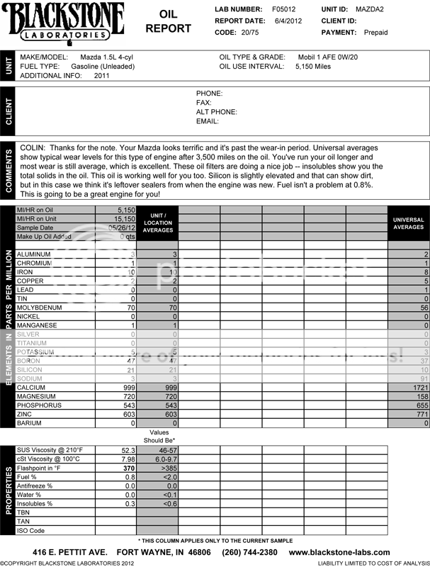

I just did my fourth oil change, and sent off a sample to Blackstone for analysis. I'll post up the results when I get them back.
Excellent!

As promised, here's the results from Blackstone.
A little background: I bought my 2 new, almost exactly a year ago, with 19 miles on the odometer. Changed the oil with the odometer at 2k, 5k, 10k and most recently at just past 15k, each time with Mobil 1 synthetic 0W-20 and an OEM Mazda filter. The sample I sent to Blackstone was the oil run between the 10k-15k interval.
Thanks for posting that analysis! I may send in a sample from my 5k mi change with the OEM oil/filter and see what they think. Good to know Mobil1 works well on these motors and the OEM filters are doing a good job. Since the OEM stuff runs only about a dollar more than mobil1 per oil change (when bought by the case), I may stick with it. Though it sure is easy to pick up a jug of mobil1 when at wal-mart for other random stuff.
