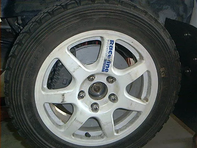

PERfect, Lurch. =) I need to fit those calipers behind a set of 15's, too, so I'm REALLY interested in finding more out about these!
brake pics.

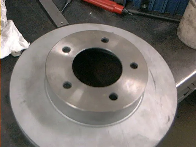

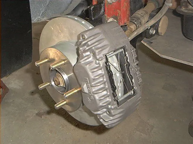

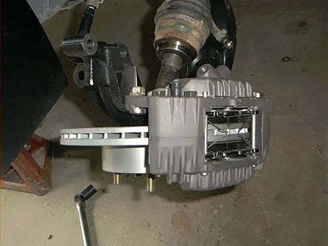

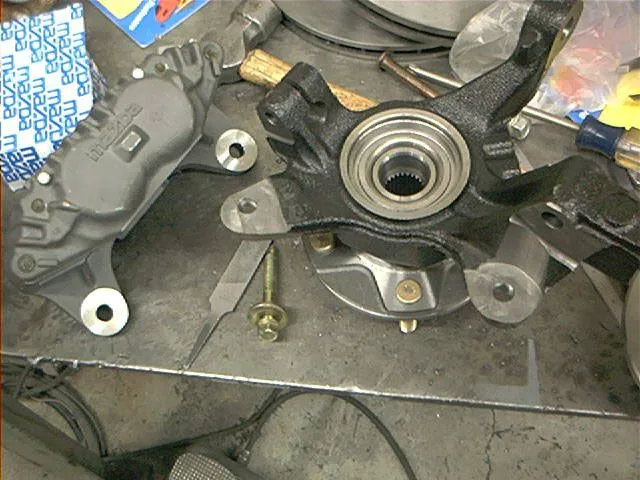

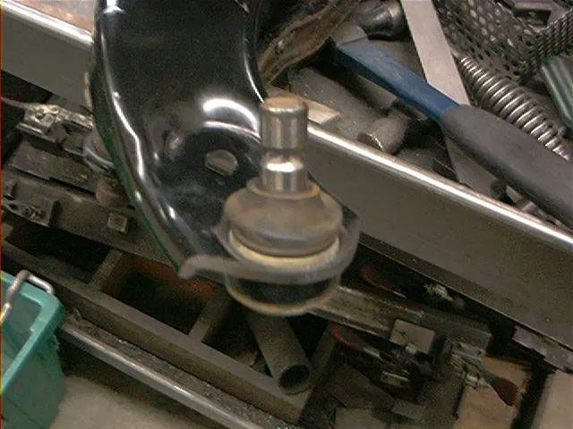

Here are the brake pieces for the RX7 conversion.

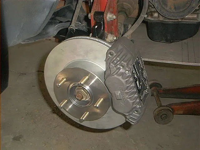

RX7 brakes...
...and here are the rest...
Hmm... Are you using the OE rotors there, or are those RX7 pieces?
From the looks of it, you changed that post on the control arm (I think that's what the first picture is), the hub, studs, wheel bearing. Also, the brake caliper mount is machined to some degree (Looks like you may have ground it down some, and/or bored out the opening) then threaded the caliper holes, if they weren't already, then persumably bolted it in place...
Could you do a writeup of how you did it basically? I'm kinda curious what you did to make the brake lines mate up, or if you just made custom ones, too. Very, very cool looking, though. =) I only pray for the day that I have some chunky 4POT's sitting behind my 15's. Hehee.
Oh, also, did this end up pushing the wheel outboard at all? It looks like it may have a few millimeters.
What is required:
RX7 rotors--faced off on lathe
RX7 calipers--milled a little off mounting ears
Pads (duh)
Upright--pressed apart and the casting is milled, welded, annealed,
drilled, and tapped to accept caliper.
Hub has lip machined down on lathe.
Spacer--Custom. Made to fit over hub and under rotor. Has 2 step lip to
accomodate the rotor centerbore and the wheel centerbore.
A-arm--Outside radius around ball joint is ground down to provide clearance to rotor
ARP wheel studs--longer to accomodate extra thickness. Firbird/Camaro studs are
the right thread and knurl diameter. We just turn them down for correct
length.
Custom SS braided lines--made to length for your installation.
caliper bolts--shortened.
Wheel bearing--cuz the original often gets destroyed when pressing the knuckle apart.
Seal
As you can see, this isn't an hour's job, but a whole retrofit. It works wonderful, though.

You beat me to my final post! Read the last post. It should clear things up. Yes, as I stated before, it widened the front track by 20mm...10 per side. We are now making the spacer out of aluminum and lightening it significantly. We took 4 lbs of unsprung rotating mass out of the assembly (both sides). I am working on an alum. rotor/hat assembly that would further reduce the weight and allow for larger rotors for tarmac spec. Another additional cost, tho (custom rotors, hats and bolts/nuts.)

Wow, so I wasn't too far off in most of my assumptions! Cool. =)
Any chance you'll be able to offer these parts to someone *coughlikemecough* who wants to get those monsters on the Protege? Without having to have a machine shop in the garage, as well as a few stray chunks of billet aluminum, that is. ;)

We can make them on a limited basis, but we would need you to send us your the above parts minus the spacer and studs. You would be responsible for the brake lines, but I can give you a source.
How much would this run me, so I can fit it into my budget? =) I'll probably have to find another set of A arms, hubs, uprights, and caliper bolts, so that'll take time, anyway. But let me know, and I'll plan for it accordingly. =)
