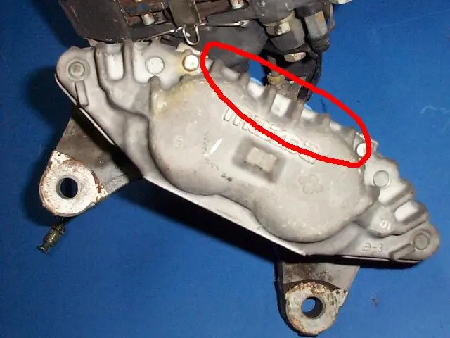

anyway, it's definately possible. with the series 5 calipers, the fins on the caliper above the pistons need to be removed, but other than that a pretty easy mod. they think at the moment without taking the wheels off and doing some real testing 294mm rotors on the front will work no worries, 304mm at the moment is a maybe. the main problem is the wheel (since i have the stock P5 16" wheel).
they are going to work out a price for me and get back to me shortly with the price etc. so for now it's buy the calipers, get the fins removed, get the caliper powder coated (i'm going to get it black with the MAZDA in silver or just metal), buy the caliper rebuild kit and i'm set!

is removing the fins on the caliper because it's a 16" wheel or something different??

yeah fitment issues with the stock 16" wheels ...
here's a pic of the caliper and i've circled the fins i have to remove. i think it's worth it to get 8mm bigger rotors!
also, the brake ppl said those fins are probably more for looks than cooling

I have converted my Protege rally car to accept RX7 front brakes. I will try to get pics of them up tomorrow if you're interested. If you get all the parts, we can do the necessary machining to complete this mod. Currently our design increases the track (width) of the front of the car by about 20mm (10 per side) so you might want to make sure you have tire clearance. All the pieces need to be machined. The face of the RX7 rotor is turned down thinner, the hub is machined to accept an alum. spacer, the spacer has a new centerbore lip machined into it as well as a rotor centering lip. The knuckles are also machined and the mounting holes are welded up and re-drilled/tapped. The ears on the caliper are machined, too (whew). It is a VERY tight package, but by whittling a little here and a little there, we can make these things fit. We can also mount the front calipers on the rear, but you will have some master cylinder issues to figure out. Instead, I just use the Mazdaspeed Pro rear brakes. I was bending the pins on the stock ES style brakes.
I am working on a seperate rotor/hat assembly that may stack up a little tighter and won't require the change in front track, but this will be more costly (custom rotors and machined rotor hat).

No, I mean 4pot calipers. The same Sumitomos that you have pictured (which are built under license from AP by the way). They are a popular brake for rally cars because they fit inside a 15" gravel wheel. don't know why you would have to remove the fins. They are not cosmetic...they do help cool the brakes. and those particular fins are closest to the external air stream, so I wouldn't remove them if you didn't have to.
