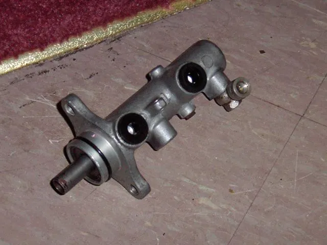

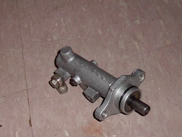

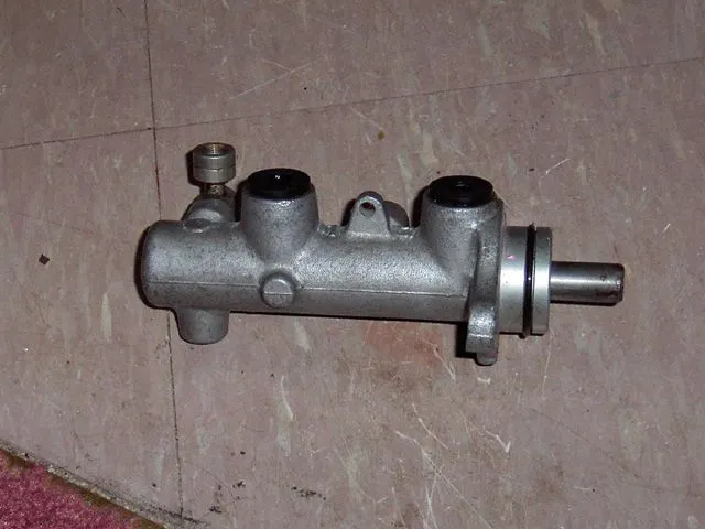

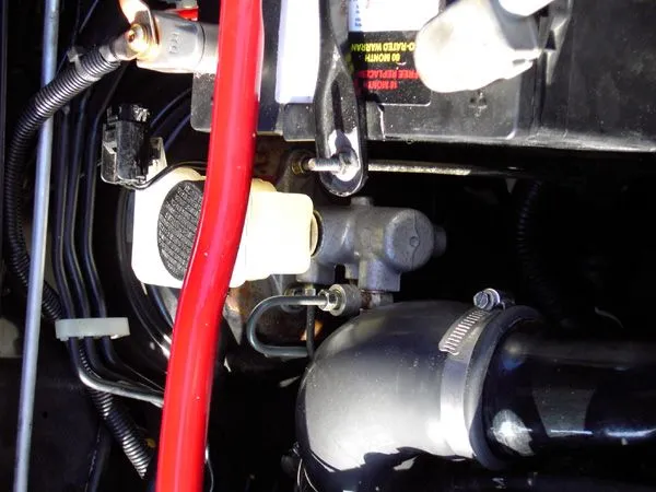

Here are some shots I snapped of the 929 MC earlier today. Enjoy!

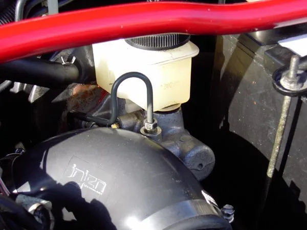

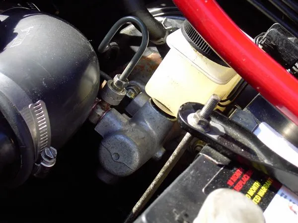

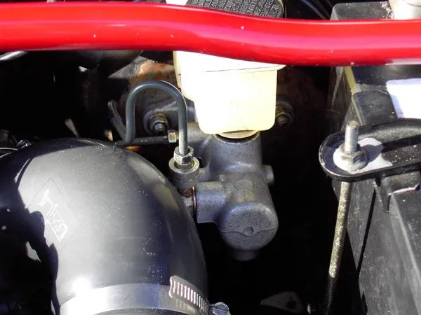

Okay, the MC is installed now... Let me just say this; Wow. I didn't think 1/16th of an inch would make THAT much of a difference. It was a bit of a pain, but if you take your time, it's not too bad. Just have to bend the brake lines a tiny, tiny bit, reorient the banjo bolt vertically (like in the pictures); Bench bleed the MC before hand, and then put it in, then bleed the whole brake system, and the clutch. Then you're done. Not a bad upgrade, in my oppinion, and I definitly LOVE the feel... Much more pressure transfer to the calipers, for sure, and it grabs right away. I can't wait for my new calipers, now! I'll post pics in a little bit, once the sunstroke wears off some. Heh.
Here the pictures are. They aren't that great, but you get the idea. Also, take note of the brake booster; all the paint is rubbed off. Apparently, when the Mazda dealership took the car in to replace the clutch under warranty, and they topped up the brake fluid, they ended up spilling some on the back, which I only just now noticed; I only know it wasn't my doing, because I'm really anal about putting in brake fluid, as I don't want to screw up my paint. So, now I need to touch up the paint on the stupid brake booster at some point. =P Bastards. I should've known they did that when they ****** up the paint on my battery hold down, too. Ahh, well. The MC is in, and working great. I'll give more details on the install tomorrow, when I'm not exhausted.
