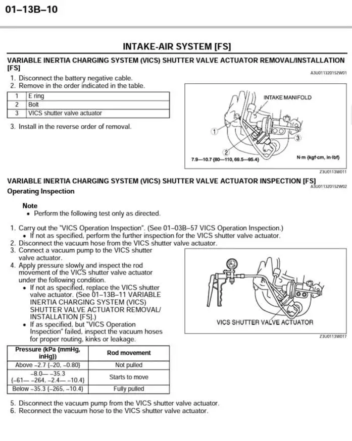

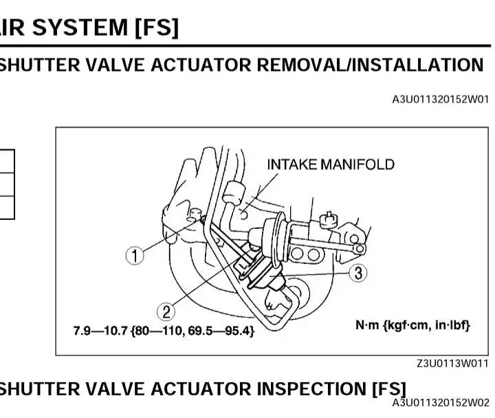

Check to see if your VICS shutter valve actuator kicks in at ~3000 rpm.
You may just need some lube on the mechanism or your shutter valve is leaking and not holding a vacuum?
