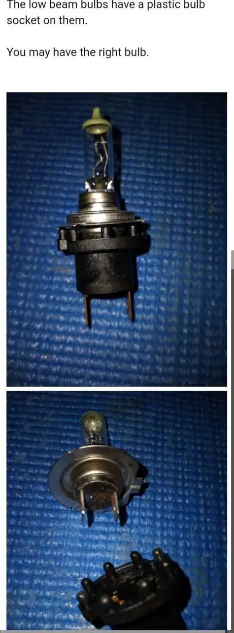

The original owner probably installed a headlight for the Protege sedan instead of bulbs for the Protege5.
My parts car came with sedan bulbs installed. It does plug in to the connector but the bulb base doesn't fit properly in the headlight housing and it is loose.

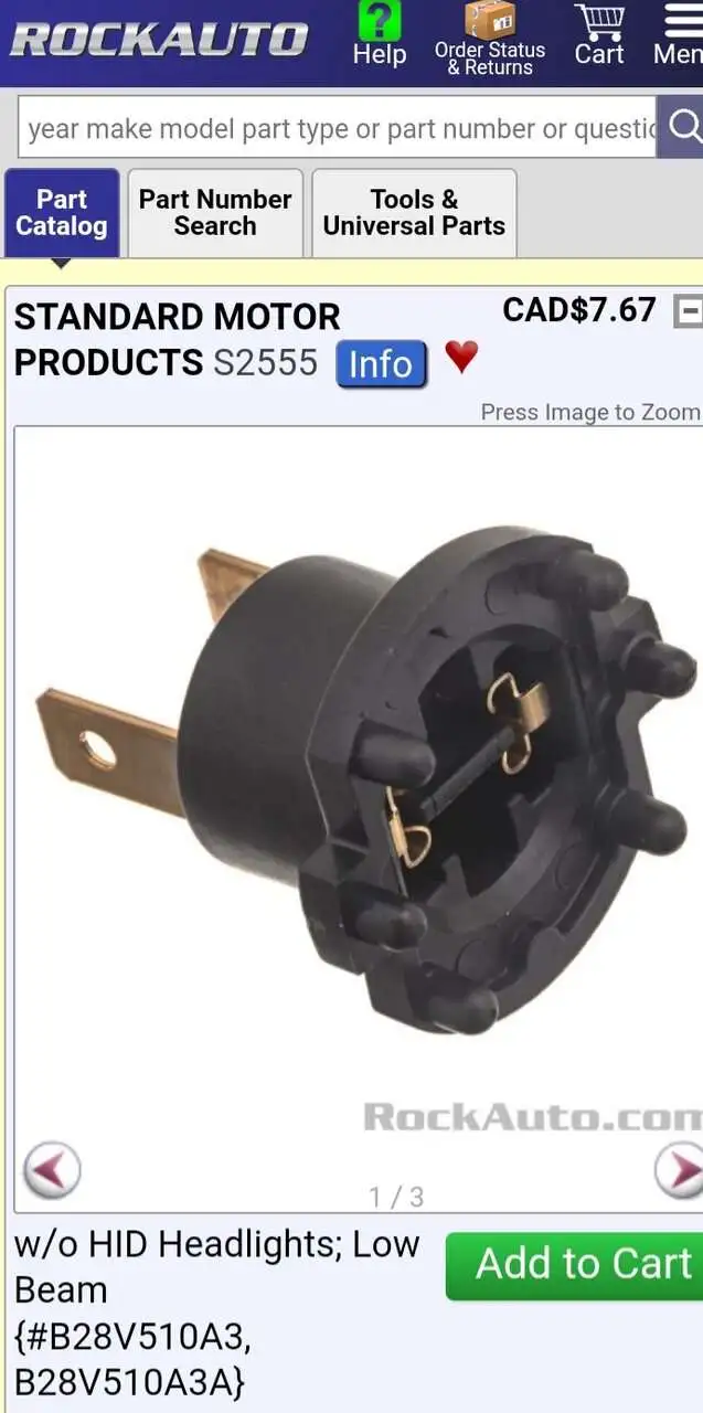

You probably need two of those adapters for the bulbs you bought then they will plug into your connector.
The connector is a three prong but you only use two of them to plug it in.

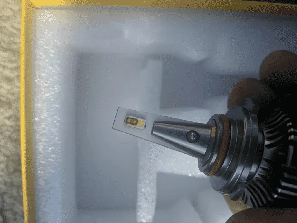

I have not used AUXITO‘s headlamps. I bought their reverse lights a few months ago.
Admit the bulbs are well bulit. Nice package, Their reversing lights are the best I've ever used.
