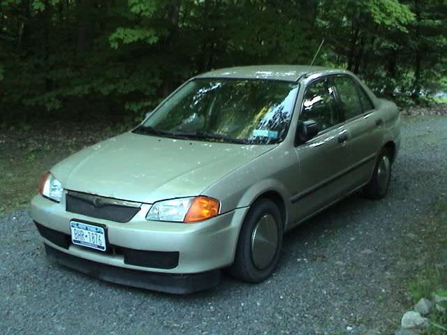

Great post! I'm an ecomodder too. :) Busypaws, have you ever tried using the pulse and glide and drafting in combination? I did this for 244 miles and got 54.33 mpg with my '00 Protege DX [automatic no less]. Check my gas log HERE. But otherwise, I'm at 43 or so for commuting. I have a longer commute [24 miles] so I have to buy gas about once every five weeks. It's great isn't it?

The spec for my '00 DX is 13.2 gallons. However, if you fill it to the rim [takes patience] I have added 14.2 gallons. I always fill to the rim for accurate mpg calculations. Otherwise if you reply on the pump clicking off, there will be constant inaccuracies in your calculations. If you live in a state where you can't even pump your own gas, it's even worse. Some attendants will click it off a few more times to get to the next dollar, some won't. Some fill at the highest speed, others may not.
The problem with comparing mpg numbers in a thread like this is the lack of apples to apples comparisons. Those of us who practice the art of hypermiling will get much bigger numbers. We're the guys that are referred to as the B.S.ers. To someone who lives in the city and sits at lights going nowhere and getting 26 mpg, our numbers don't seem possible. We must be full of crap right? The comment someone made about 40 with a "slush pump" is not correct. I average 40-42 mpg all summer with my automatic DX. Granted, I'm not getting anywhere very quickly, but 40 is quite doable on a regular basis for a hypermiler.
Further, if you want to consider the extreme hypermiling situations, like a long highway trip with high temps, no traffic holdups or traffic lights, and drafting trucks, I've gotten 54 mpg with my slush pump equipped DX. But that was a lot of work and concentration for 4.5 straight hours and 247 miles. It can be done, but most don't care make that kind of effort. Car prep is another important ingredient to get the big numbers. I run lighter 5W-20 oil one quart low on purpose, 45 psi in the tires to reduce rolling resistance, fold both side mirrors in, add smooth wheel covers, a chin spoiler, and block the upper grill to reduce wind drag. Oh, and my rear tires are 155/80R13's for even lower rolling resistance.
