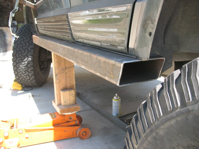

One of the first fab projects for the Yota will be some box steel rockers. I got the idea from the Jeep forums looking up stuff for my buddy's XJ. It'll look like this, except obviously sealed on the end:
Whole thread:
http://www.jeepforum.com/forum/f11/rockers-labor-day-1260797/
I need to make some measurements first, but I'm thinking now 2 x 6 x 3/16 based on the sizes the guys were using for Jeeps.
I want to tie it into the frame, too. The Jeeps are unibody, so they just weld it right on to the frame. I don't want to do that in case for some reason the cab needs to come off in the future. Yes, I know it can be ground off or whatever, but why make things more complicated? I don't want to drill or weld the frame, so I think I'm going to take a leaf out of this guy's book and make some frame "clamps" for the supports. I'll need to pick up a shop press and press brake kit first, though. Always more tools to buy....

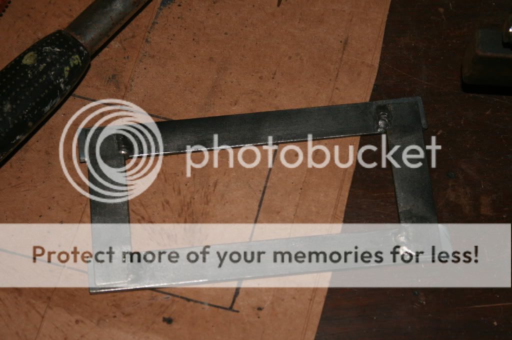

Anyway, worked on the battery bracket a bit tonight. I got the uprights made. It would have been easier to use angle stock...
I am not a 4x4 expert by any means but.... If you use a box tube rocker on your truck and tie it to the frame you will lose flexibility won't you. Meaning (in my mind) when you cross an obstical at an angle, your tires will have less chance of being on the ground. Does that make sense?
You want your suspension doing the articulation, not your frame! Just like a car. :D The front of the Yota doesn't flex much, as it's independent suspension, and has a sway bar, but the rear flexes decently for stock.
Damn man! Those are gonna be some VERY durable steps! They may outlive the truck.
They're not running boards, they're box steel rock sliders. They need to be very beefy, as they're supposed to support the entire weight of the truck if you come down on a rock!

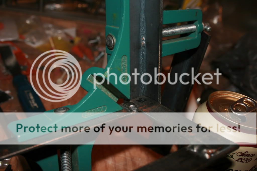

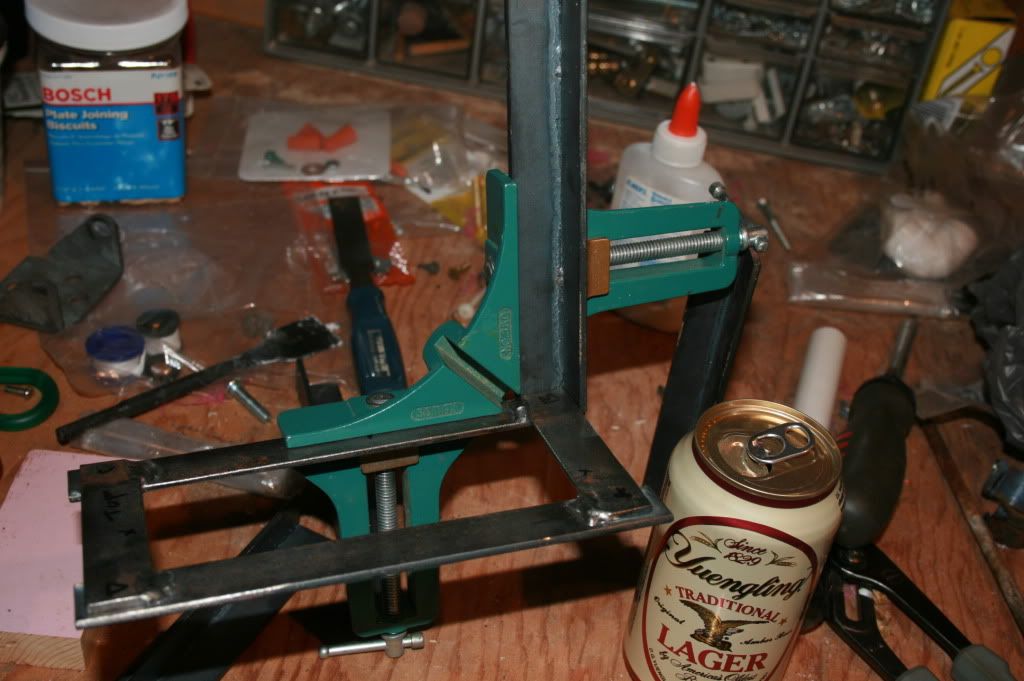

Holding the pieces in place so they don't move during the welding process is more than half the battle. I mocked it up a little bit using a wood clamp for corners. I wasn't sure if it would hold the pieces how I'd envisioned, and it didn't, but I managed to get them decent enough. I want to ensure everything's square so that the battery fits neatly inside the cage. If it doesn't, the whole thing is useless.
