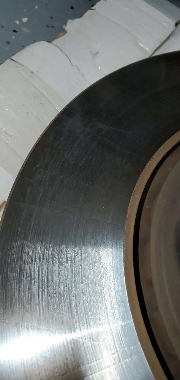

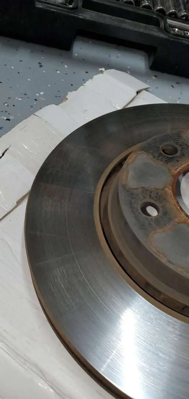

I replaced the rotors and pads with the Raysbestos ceramic. The rotors had 51k miles on them and the pads were still decent but I had pulsation during braking and rotor surface had some wear.
I saved the OEM rotors and will maybe cut them one day but hard to find shops that turn/cut rotors anymore.
NAPA still cuts rotors
Out here where I live, they do not. I just called NAPA and they confirmed they do NOT cut rotors.
Looks like O'Reilly does cut them where I live for $25 but they don't do any crosshatch pattern finishes to help with pad break-in and mating.
The new Raysbestos rotors cost $40 per rotor so the $15 savings to have them cut is not that great for the hassle and one is still left with the concern if they are not cut correctly and the pads mating.
