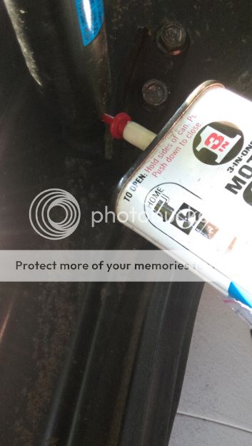

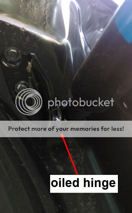

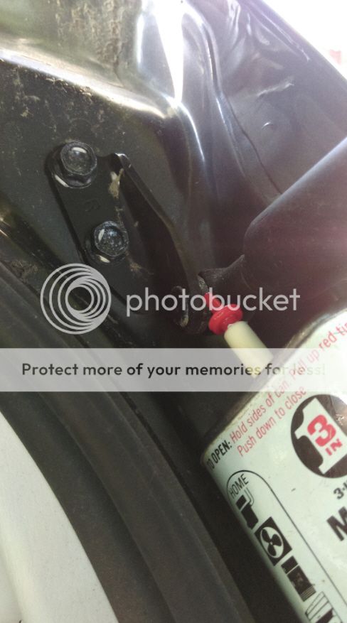

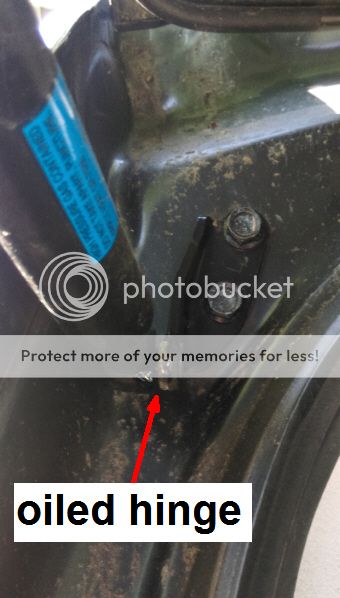

Hi guys,
just a thought about the liftgate hinge failures, could it be that the hinges are not lubricated properly, and the linkage mechanism is acting like a "stiff arm" against the trunklid and causing metal fatigue on the link joint ? "Stiff arm" as in like a football wide receiver stiff arming a tackler.
Anyway, I started hearing squeaking when I opened the lid, and started thinking that the rotating joint is not lubricated enough and not rotating smoothly and "stiff arming" the joint on the trunk lid. I lubricated the link joint with household door oil as shown and the squeaking went away immediately, just thought I share this with the members, might save some headaches from lid failures.
