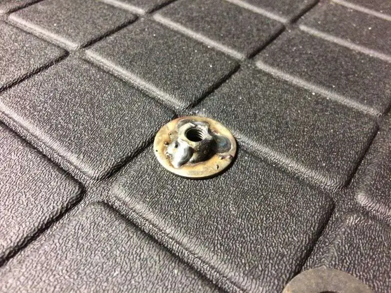

We inspected the sheet metal and there is no reinforcement in the area where the mount is attached. Just sheet metal with a small backing plate of about 1" x 3/4" (you can see it in the picture). The hatch is large and the location of the mount is near the hinge, so it must take a lot or pressure for the motor to open and close the hatch. 4 years of opening and closing many times each day caused the metal to give out -- I'm convinced that others will start seeing this same sort of failure.

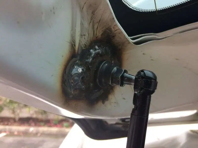

I fixed mine with a large washer, the old nut and a welder.
