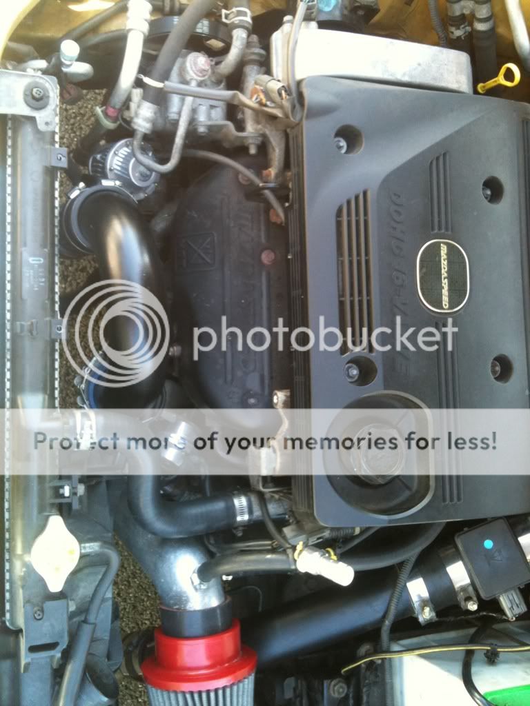

-Corksport FMIC painted black and BOV flange welded custom
-MAF relocated approx. 18" from throttle body
-Synapse Engineering Sychronic BOV
-HOT pipe
-NO Turkey
-No leaks, spool is much better because of this BOV's opening/closing speed and the fact the boost keeps the valve closed under load
That looks really good!!^^ I actually just moved mine to the hot side today, it doesn't make the same sound pitch VTA as it did VTA on the cold but it is pretty loud, have a little turkey but not too bad, I need to get better T-bolts and a better coupler; got a crap set off of eBay that messed up.. Take pics soon:)

I can see why its quieter pointing down like that. Mine is facing the hood, pretty loud and its only on stock boost for now. Looks good hella hidden.
