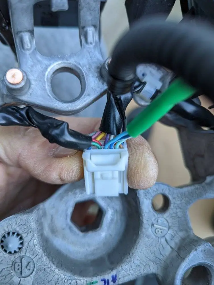

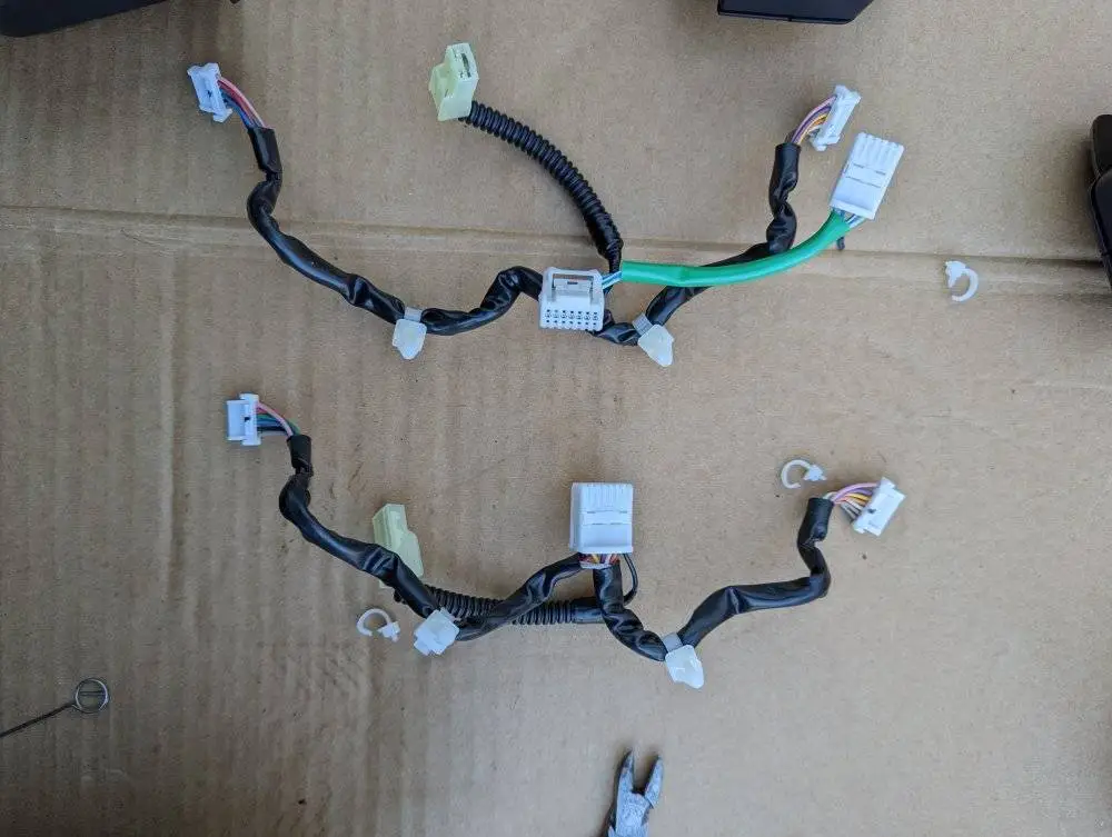

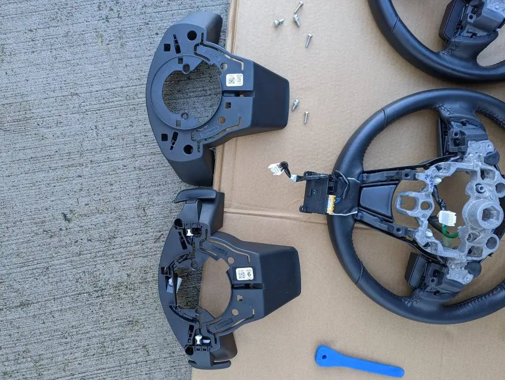

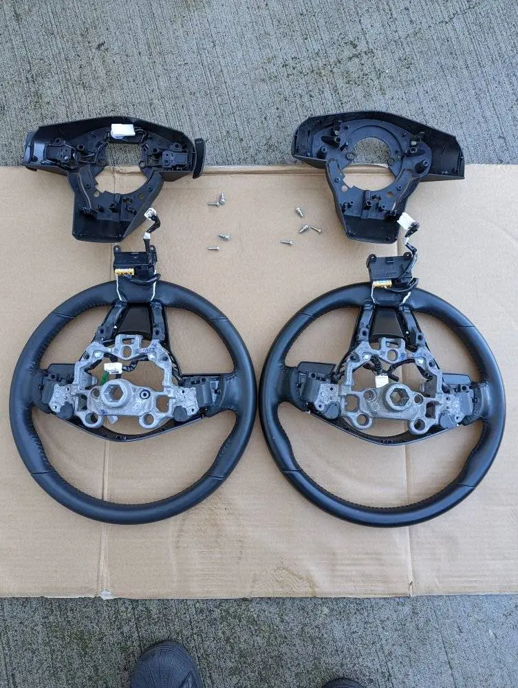

So I finally got around to doing this Mod on my CX-5. "Borrowed" my mother in-laws CX3 for a couple hours 😉.
