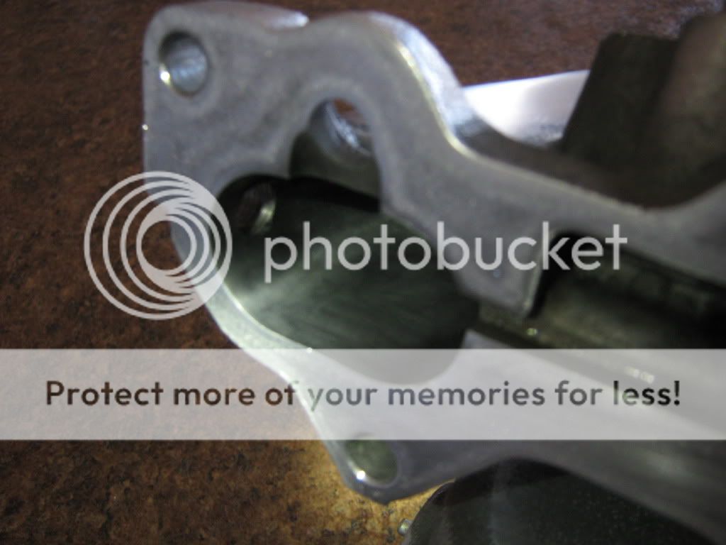

Those features aid in Cold Start and Emissions. If you disable them you may end up with issues depending on what the laws are near you.
Removing them is really simple, you can drill out the screws and pull the flaps out, then remove the rod.
You will have to tap the rod hole to a bolt size and bolt up the hole (to seal it)
As far as the inner flaps, you need to unbolt the two halves and do the same thing as the runner flaps.
You might loose some bottom end torque, however it is no negligible that you might actually feel the car is more powerful due to the reduced resistance.

lucky for mr there are no emissions over here and since im in Florida cold is really not much of an issue,I just want this damn car to stop sounding like there is a marble in the head. so that pic is of the intake with the VTCS removed? what is the Vcis? do i need it?
For me - it is the VICS shaft 'play' from being worn that would rattle. I had red loctite'd the screws. I had also removed VTCS butterflies...
So it may rattle and not be a problem.
VTCS is a known cause of the rattle, but we haven't heard your engine...so you're sure everything else was assembled properly?
VICS and VTCS are very different though...VICS has no known problems with a naturally aspirated FS engine...many turbo guys remove it, as it could be deemed restrictive in forced induction systems...but you'll gain absolutely nothing from removing it on an NA FS, and will lose some low end torque...its not a huge deal though, many guys swapped to a 626 IM on an NA protege and didn't care (the 626's of certain years didn't have either system in place iirc)...VICS changes the runner size depending on engine speed and load, and effects the speed and amount of air that gets to the engine in different situations...its not really an emissions system, its just Mazda's alternative to variable heads...or at least, it used to be...
VTCS can be removed, though...but it takes some messing around, and there are multiple ways to do it...just pointing that out...some ways will throw a code (if you pull it out and just disconnect/tuck the connectors) with the stock ecu, though...
Brian put down what needs to be done...the hardest part by far is just getting the IM off...If you're set on using your stock ecu, you'll have to leave the actuator and vacuum lines connected to the solenoid, and tie them to something...as well as it still hooked up at the connector on top of the IM...the computer won't care as long as that stuff is connected (it doesn't know its actually not moving anything)...In your area, you should never have a problem...just be aware that if you do travel to somewhere that gets pretty cold (at or around freezing, or less)...you may have some pretty annoying problems on a cold start, and it won't be very driveable until it heats up to operating temp...thats the primary purpose of VTCS; its a cold start emissions system that works in conjunction with the ecu's fuel delivery during cold starts...all in attempt to reduce cold start pollutants...
The easiest way to never care about it again is to get an Mp3 ecu...that car never had VTCS...and the computer doesn't 'look' for it...so you can rip out everything related to the system and never look back...a forum member can flash the ecu for you for about $150 iirc, but its only for manual cars...but if you're otherwise not in to modding, just remove it from the IM, but keep the 'outside' stuff connected...and it'll be fine...
