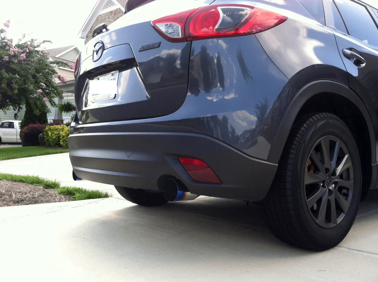

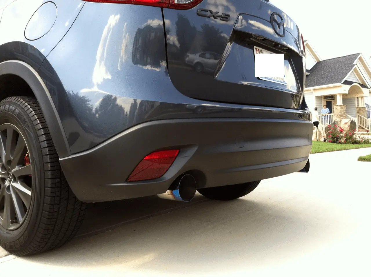

this thread is 2 years old peeps lol, went w c/s and customized the tips
