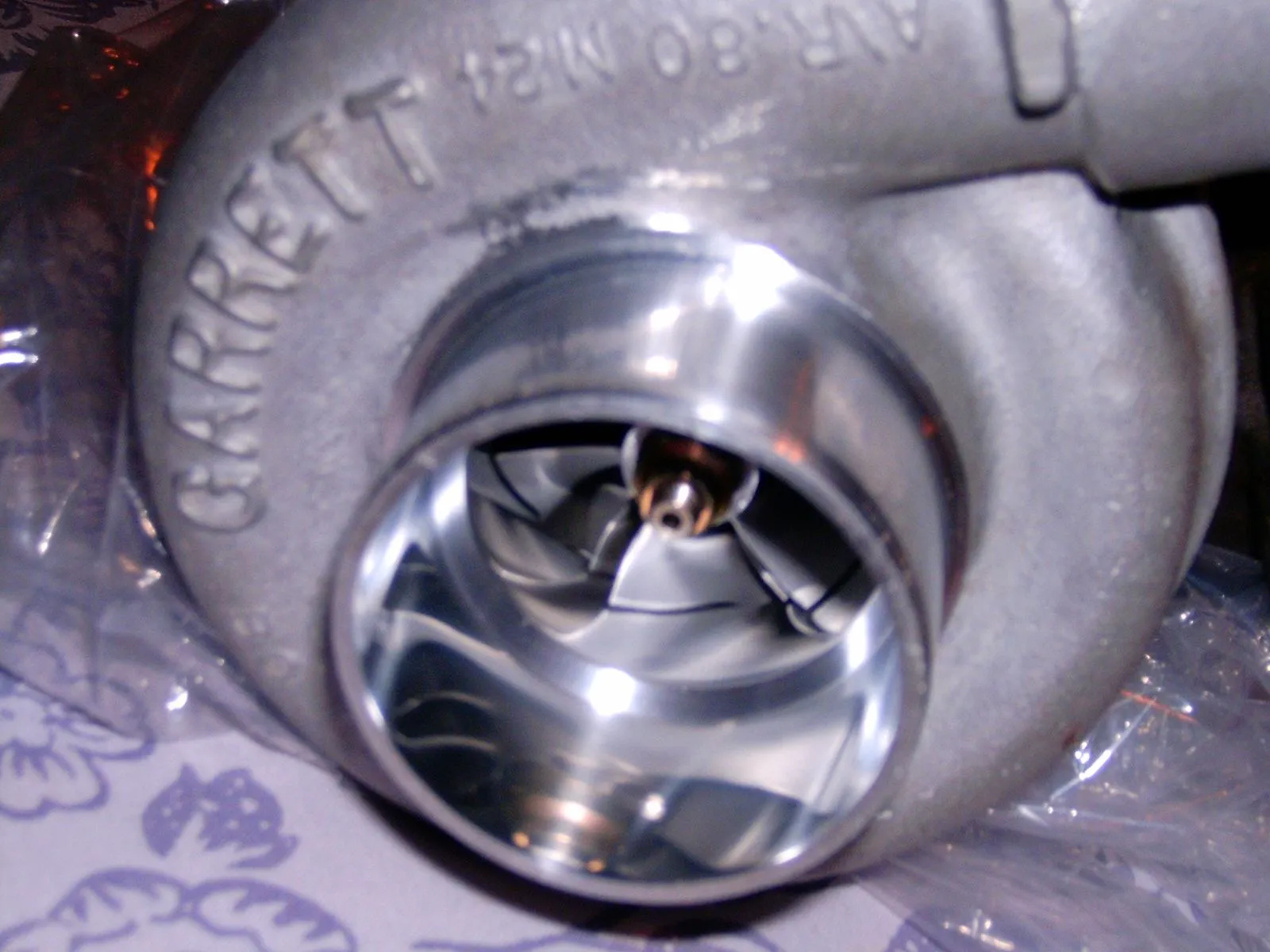

Here's my T-25. Probably alittle different than yours, thanks to MpNick.
So basically the compressor housing and wheel have been replaced?
What's the difference between going that route and just getting a GT28rs? What is the stock trim on our turbos?
The compressor housing has been milled out. A new compressor wheel is installed. Looks completely stock from the outside...hehe.
Its cheaper, spools up exactly like stock, and has been proven at 330whp at 15psi (with other mods.) However the GT28rs will still make more power.
