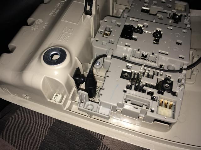

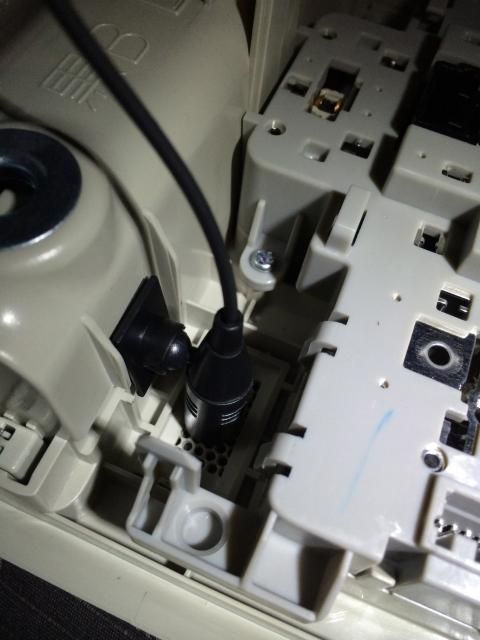

Removing overhead console and removing factory bluetooth mic: Open the sunglass holder, and remove the 2 screws. Carefully pull down and back to release a clip holding the overhead console in place. Be sure to keep the console level as there are washers on the top that can easily fall out and get lost. Disconnect the plugs to the map lights, bluetooth microphone, and sunroof (if you have it). There are 3 clips holding the bluetooth mic in place. That part was a little tricky to get all 3 unlatched but once you do the mic will just slide out.
Installing Pioneer mic: I used the adhesive that came with the mic and attached it to the side. You may want to consider something a little stronger, but it's easy to remove the console so if the tape gives out down the road I can look into another option then.
And here's how the whole console looks

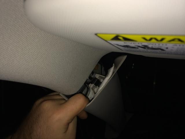

To run the wire, I fed the plug through the headliner. Stick your hand up into the space where the overhead console was and push towards the windshield until you hit the side of the headliner. There is an opening at the base, that you can stick the plug through. Next you want to LOOSTEN the A pillar (trim covering the side going up the left side of the windshield) to do this, grab toward the top of the A pillar, and give it a tug to unclip a couple clips securing it. You will not be able to remove the entire thing as it has a cable securing it. This picture shows about how much space you can work with, and it's more than enough

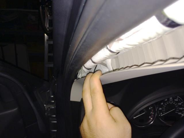

And here is looking down the side of the pillar
If you look closely you can see a black wire above my hand. That's the mic cable. I should also add you will need something to fish the wire through this. I recommend fish tape, but a clothes hanger should work as well. Next you need to get the wire under the steering wheel. Attach the plug to the fish tape or hanger with electrical tape and stick it down to the right as close as you can get to the bottom of the A pillar. With any luck you should be able to look up under the steering wheel and see the wire. It may take a few tries before the wire finds it's way in there. Once you have the wire under the steering wheel, running it to the radio is easy.

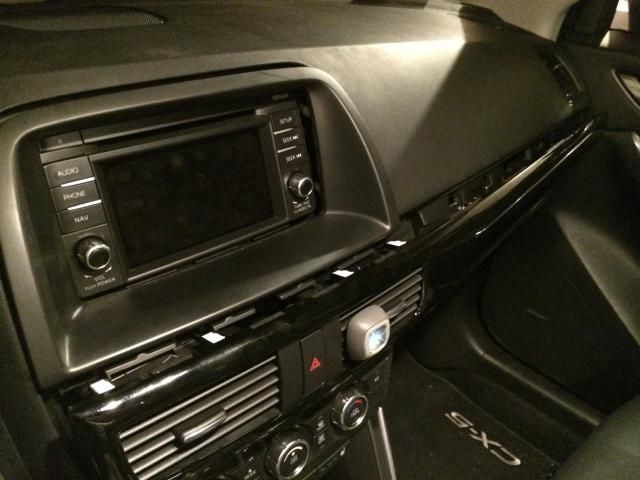

That being said, start by removing the long decorative panel that stretches from under the radio to the far right vent. There are a number of clips holding it in. Using a tape wrapped screwdriver or pry tool, gently apply pressure outward to release the clips. Make sure you do this gently or you may break off the plastic. Once you have released all the clips simply pull the decorative panel out. There is a connector attached to the hazard button that you will have to disconnect if you wish to remove the panel entirely.
Next remove the trim ring around the radio by grabbing at the bottom and gently pulling outward to release clips securing the ring in place. Again take caution not to damage the plastic.
I haven't removed my radio just yet as I'm waiting for the dash kit to arrive but here's how these 2 pieces look loose
There are 2 screws and a bolt holding the radio in. The 2 screws are on the left and right sides, and the 10mm hex bolt is on the bottom. Once removed the radio will slide out

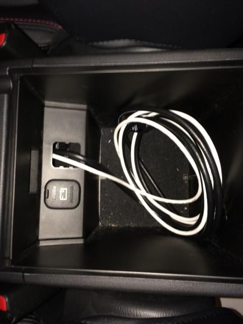

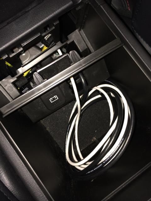

USB/AUX: If you're worried about losing the USB and AUX inputs in the center console. Have no fear, it's a relatively easy process to remove the factory connector and run new wires. First thing you need to do is remove the trim cover for the USB and AUX. On the front inside wall of the console above the USB/AUX you will feel a cutout. Grab it and pull back. you will need to pull it down at an angle to allow the feet to pop out. Should look like this
With the panel pulled down, disconnect the 12V accessory connector, and the USB/AUX connector. The panel will come out. The USB/AUX module has 2 clips on each side securing it to the trim. Push them in and the module will come loose from the trim. For my install, I'm just using the hole left to run the wires through. Just be careful that you don't accidentally drop them back in. This is how it looks after

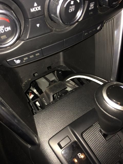

Next you need to remove the front console box. This is simply the padded recess under the A/C controls. Using a tape wrapped screwdriver or pry tool, pry up the back corner (closest to shifter) and work your way across until the box comes loose. It will expose an open cavity of the car where the wires can be fished from the center console. Looks like this
Once the radio is removed, you can route the wires up to the radio cavity. The easiest way is to remove the glove box and the small piece of trim next to the front console. From there you should be able to reach in and grab the cables. Route them along side the bluettoth module then up and into the radio cavity.
For my install purposes I'm running a Lightning and HDMI cable. If you have an iPhone 5 or up you need both plus an Apple Lightning AV Adapter to use AppRadio mode to it's full extent to mirror certain apps on the NEX radio

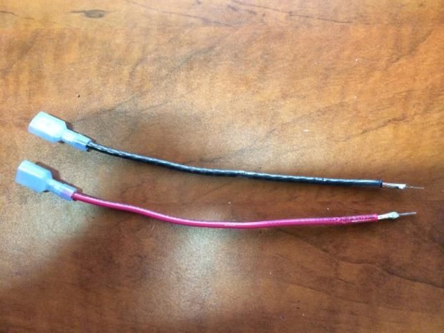

You will need to splice in to the Red ACC wire, and the black ground wire to hook up a 12V to 6V DC step down adapter for the backup cam

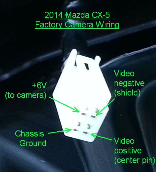

OEM Backup cam integration This will probably be the toughest part of the install, and WILL require you do some very intricate soldering. You are going to need the following...
12V to 6V DC step down converter. $7 on Amazon https://www.amazon.com (commissions earned)
Dual row PC header pins $7 on Amazon or cheaper elsewhere https://www.amazon.com (commissions earned)

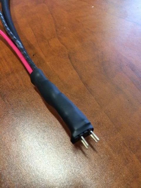

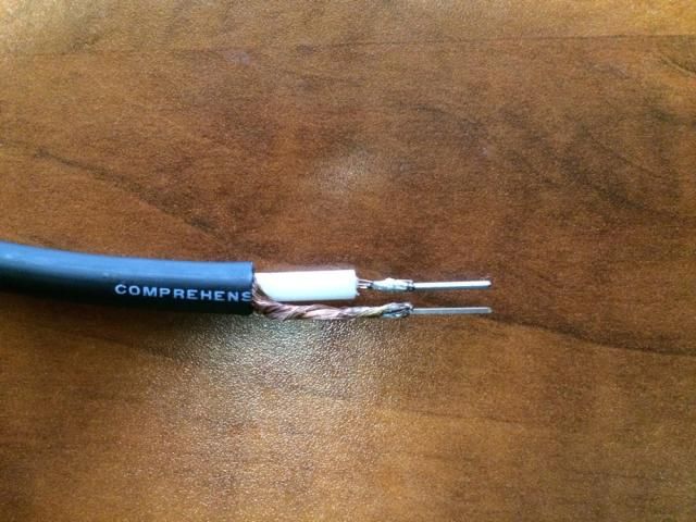

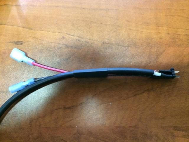

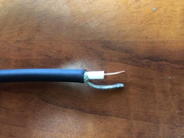

A standard RCA Video cable you don't mind destroying. Cut the wire and strip back. The center wire is positive, and the outer wire ring is negative.
Cut the header down to 3 rows (6 pins total). You then need to remove the middle pins. You solder the RCA positive and negative along with the red ACC and ground wires to the header. Make sure that you attach the wires so they match this order. Thanks to RedBaron for posting this picture.
Heat shrink to insulate the wires and you've created your own connector. The backup cam should work now. The connector has 4 larger holes above the smaller ones. Make sure you plug the pins into the smaller holes or you won't get a picture.

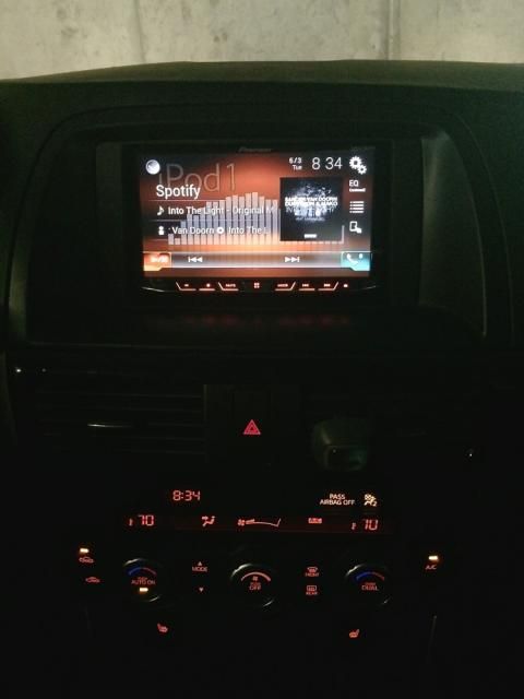

I will post more pictures as I continue the install, but for now I hope this helps those of you out there wondering whether or not to make the jump to aftermarket. Most importantly, this is an install that most of you can do, but if you don't feel comfortable doing all this then I would recommend you have it professionally done. I've installed a handful of radios and I was a little unsure about tackling this, but after the research and seeing how easy it really is, at least to run the wires, I think most of you should be fine.
Here's how it looks installed. I have the theme set to give it a OEM look
