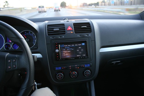

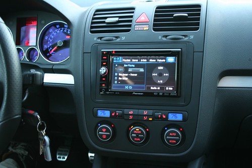

However, as an update the geniues at avic411.com have figured out how to bypass the unit.
Of course you have to ground the parking brake wire (or if you are lazy like me, have it hooked up and just move the parking brake one click which turns it on but def. no braking is being done at all)
but on the preout harness, there is a cellular mute wire that just needs to be moved from the pin it resides in to the pin right underneath. After you do that, just ground that wire as well and you are good to go.
Mine is being put in on tuesday so I can report back with pictures of the install and a review. However, i'll be back with some more pictures of the unit later tonight or tomorrow.
