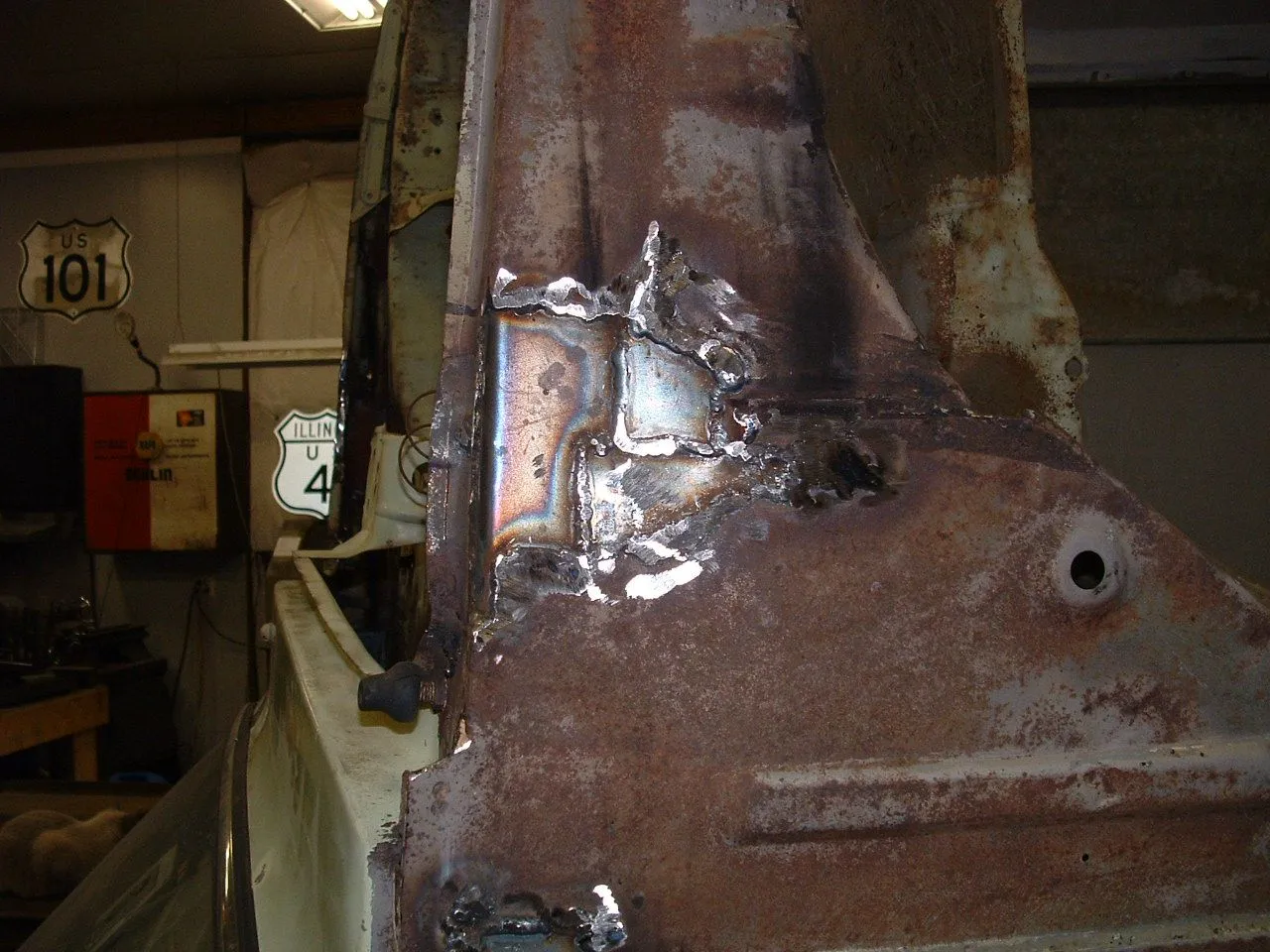

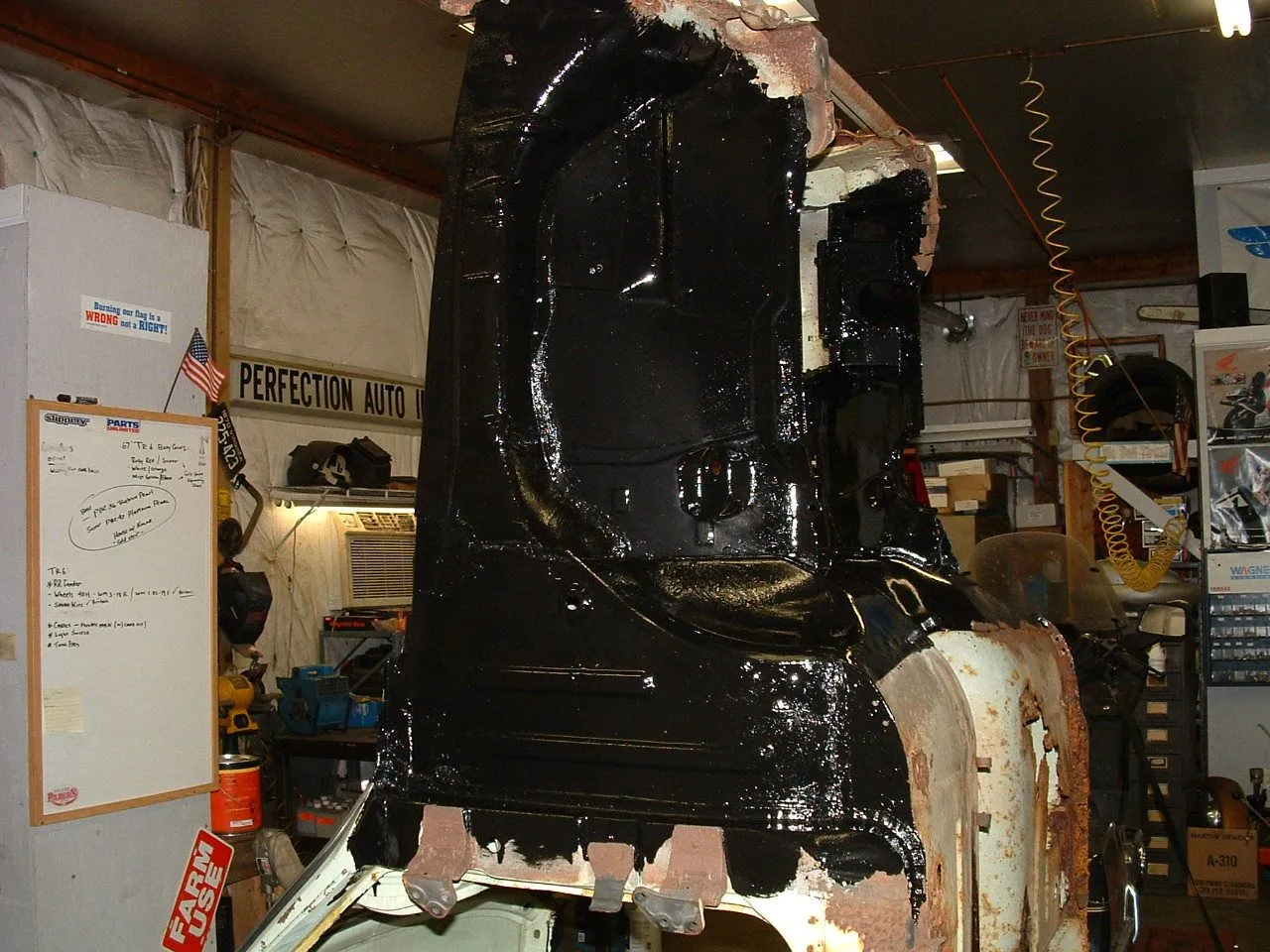

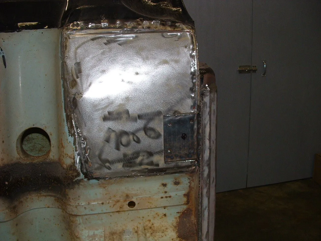

The major repairs to the cab structure have been repaired in the front cowl and a-pillars. Included are some pictures of those repairs during and after. Rust encapsualtor has been applied and the seams sealed. This doesn't look like much in the pictures, but it is a huge step forward.
The next step is the floor pans which will be finished in the next day or so. Pics will be posted then. Progress has been a bit slow due to other shop projects that were higher priority. Plans are for the cab to be in a primed state by mid December and the bed work commenced then. The frame and mechanicals are last.

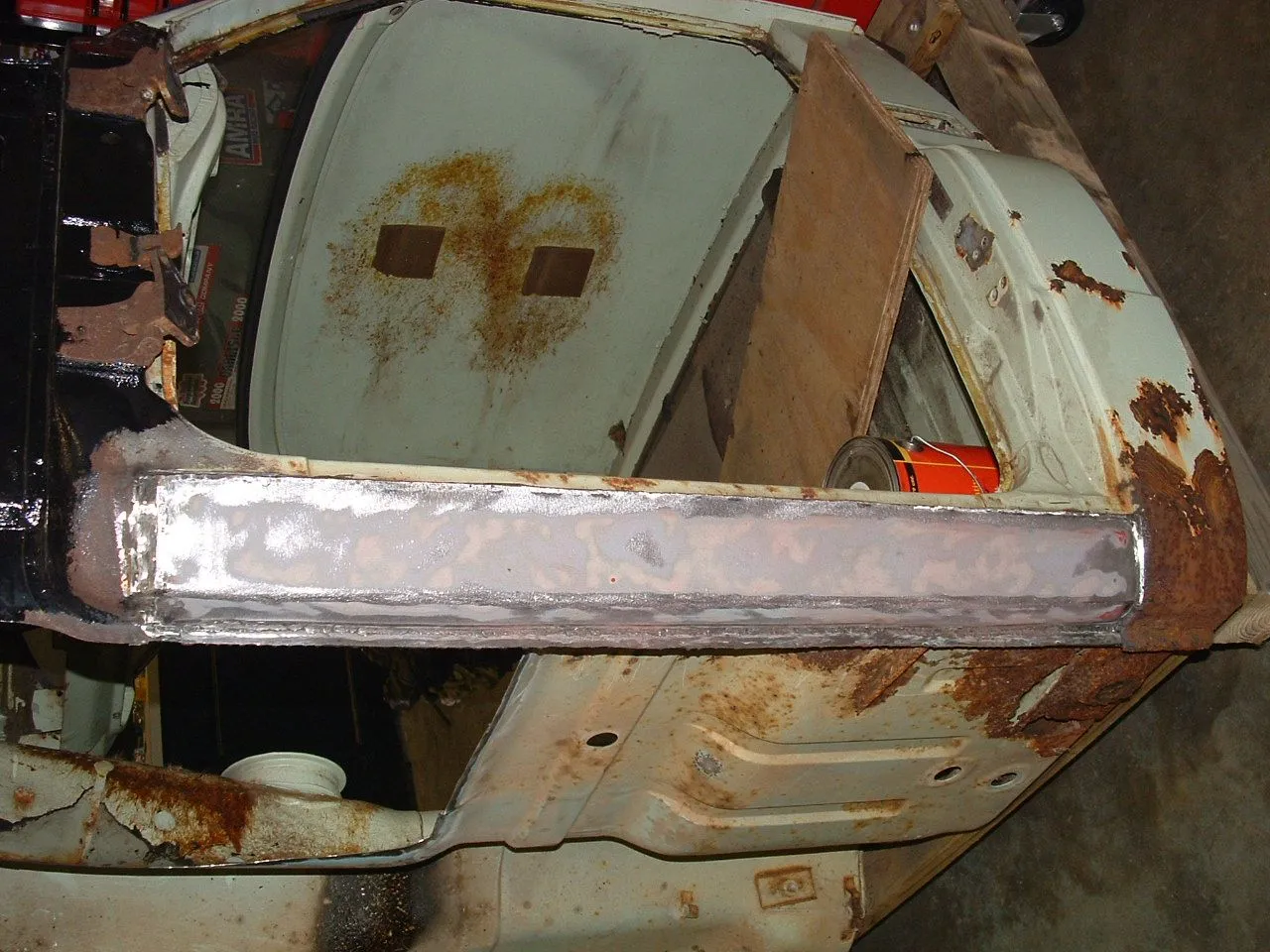

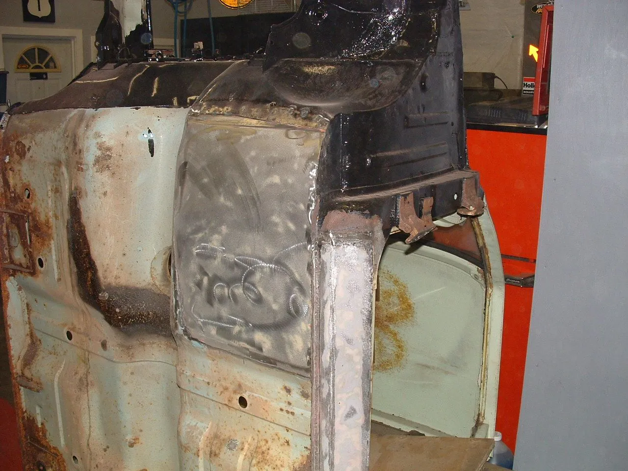

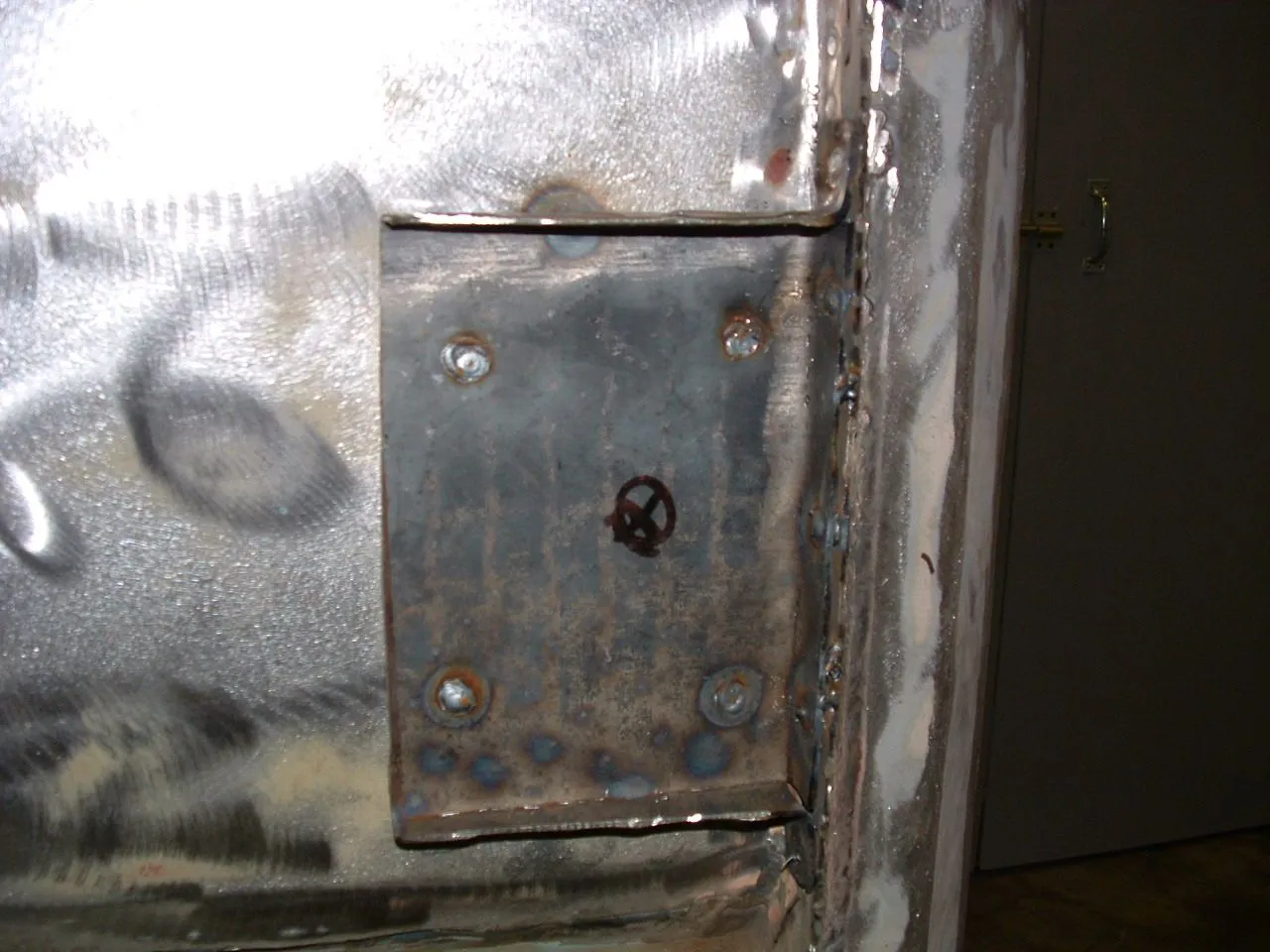

Here are some more pics. These are of the Left Rocker Panel and Inner structure, before the floor pan install. The rocker panels are parts that I fabbed myself from Jeep Cherokee door skin lowers. (should I call it a Jeezda, or a Meep?) Unfortunately there are no replacement panels available, so making them is the only choice. As you can see in the pics, the inner rocker panel was rust damaged as well, so I grafted a repair section in where the cab mount will attach. BTW, thats not putty on the rocker surface, only the primer from the red door that it came from. My goal is to use as little (or no) putty as possible.
Thanks tviera, for the info. Actually the few parts I have located thus far have all been Beck Arnley NOS. I've been in the import world for 20 years and used to use their stuff all the time...... As far as NAPA, I am a very good friend of my local jobber and have looked through all his catalogs and computer inventory. Some 1200 car stuff like tune-up parts, etc, is still available and will interchange, but I couldn't find a single mention for the 1200 truck. As far as it looks from everything I have seen, its like it was never sold in the US or in very limited numbers.

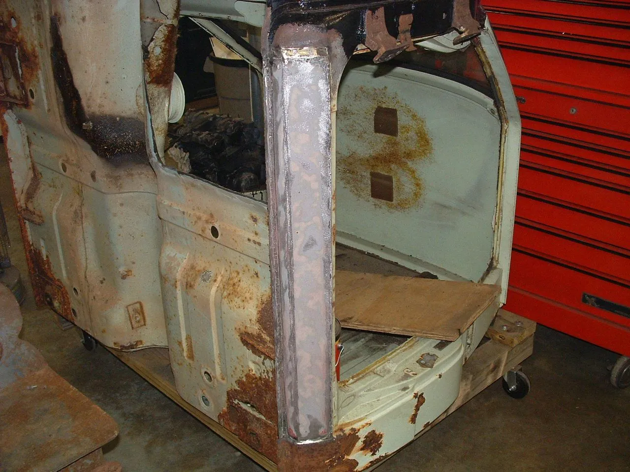

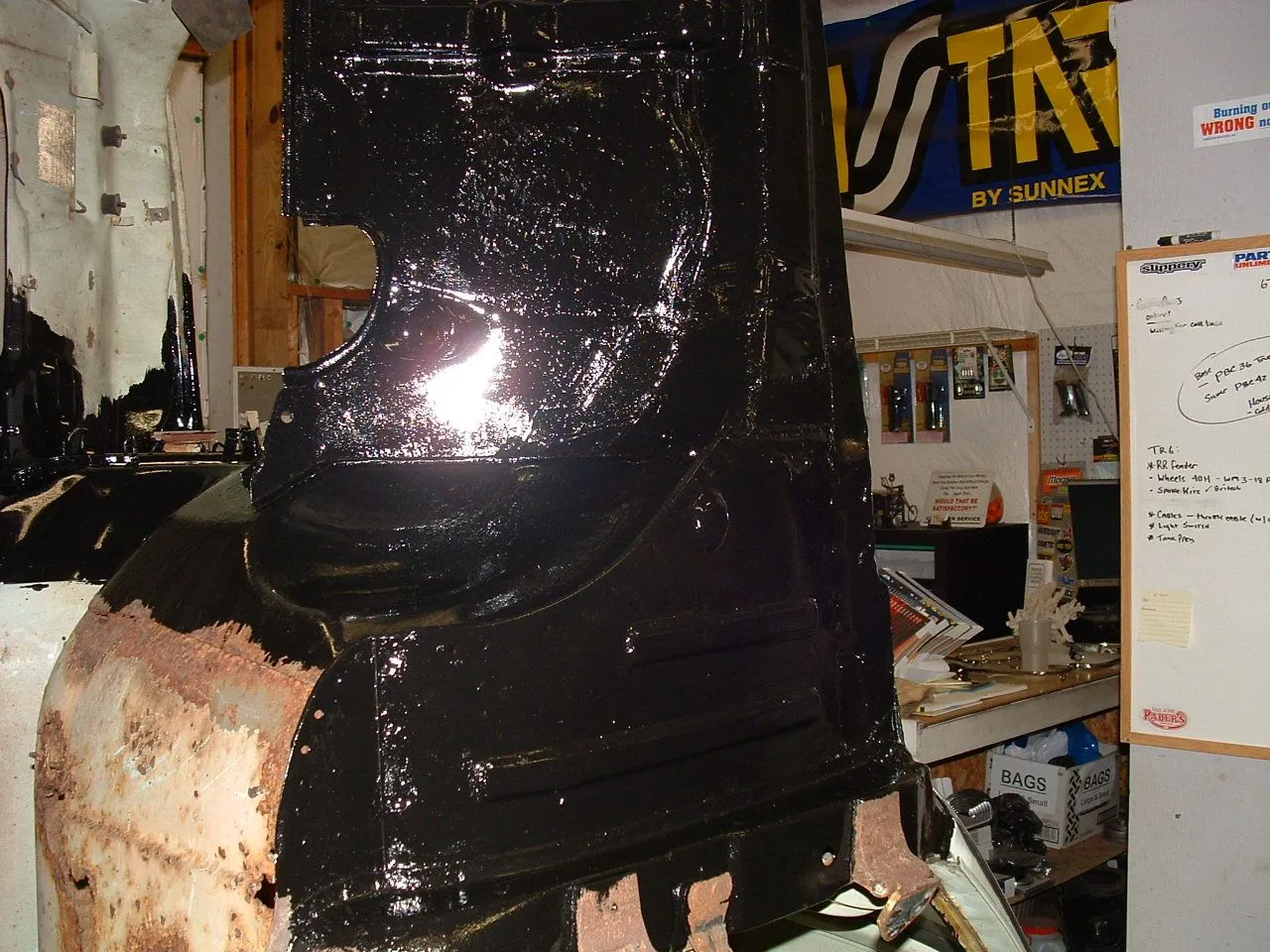

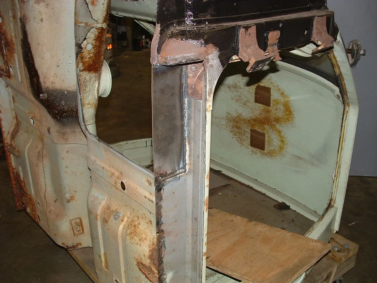

Here are a couple of pics of the floor pan on the drivers side. It is fabricated from a Jeep Cherokee hood! It is cut in and welded to the original floor material. There is also a new cab mount that has been fabricated and welded into place to replace the rust damaged original.
Next step is repair of the passenger floor, which isn't nearly as damaged and then the seams will all be sealed and the undercoating will be applied. Then all the underside gets sprayed the same color as the body.
